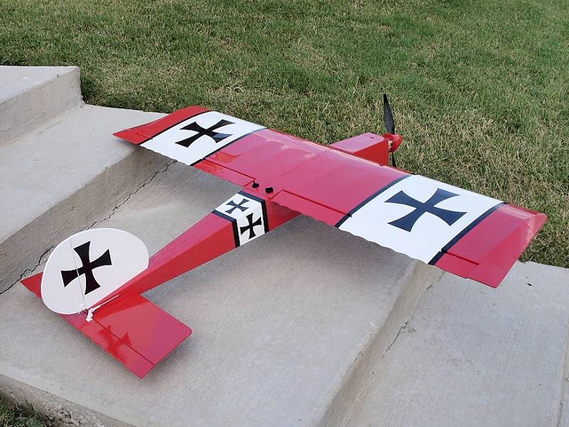

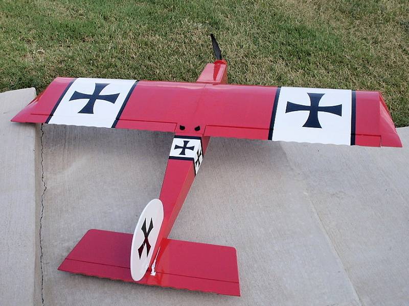

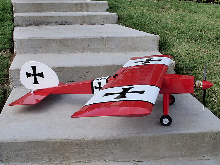

I received my Electrostik this past week. Everything looks good. Nice covering job. I'm waiting on a set of replacement wings becuase one of them were damaged in shipping. I will hopefully maiden this weekend.
I am doing a couple of modifications. I am doing away with the single servo for the ailerons and installing independent servos on each side of the wing for faster response speed and larger throws. This is an installation option listed in the manual. Servo mounts are already located under the monokote on each side. Piece of cake to install.
The only other change I am making is the tail wheel assembly. There is a small guide wire that clips to the under side of the rudder to help control tail wheel steering but I find it barely enough to have much authority. Given the fact that I will be taking off from grass I am going to upgrade the tail wheel assembly and install a seperate servo to help control ground steering.
Should be fun to fly. Can't wait.
