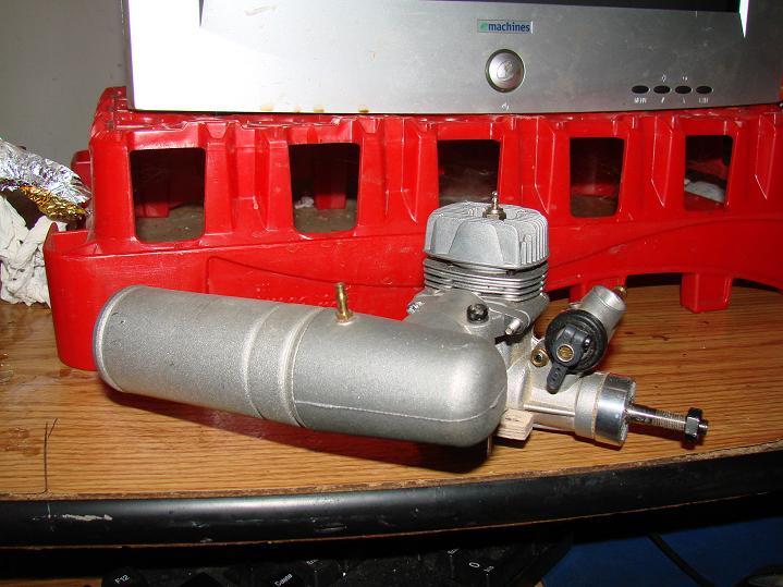

Is there a trainer plane that this sport engine can safely be flown in or is a sport engine too much for a trainer? If the answer is 'yes' that it can be put into a trainer safely then what trainer would be best for this engine?
If it can not be used in a trainer, then what would be a good low-wing trainer/intermediate or bi-plane that would go with this engine?
I am interested in something that can be built with ailerons optional, I know you will say why not ailerons I am better off with them, but the truth is I just do not care for them.
[link=http://www3.towerhobbies.com/cgi-bin/wti0001p?&I=LXFV71&P=ML]Super Tigre .45 (CLICK HERE TO SEE DETAILS)[/link]
Thank you.

Btw the term"sport" refers to basically normal as compared to "pylon" those are the high preformance engines the "sport" stuff are gernally designed not for top end performance but i bit more user friendliness.
Steven
Steven
RE: NEED A PLANE for my engine
The engine size is fine for planes that require 40 to 46 size engines trainers included. As far as ailerons vs. rudder, planes that have ailerons are much easier to control, even planes that were made to turn with rudder and had the ailerons added after. Once the plane is off the ground, its just as easy to learn to move the right stick to turn the plane as the left. If you insist on a 3 channel then can I suggest a Kadet Senior plane?? Easy to fly and would work well with the size engine that you have. http://www3.towerhobbies.com/cgi-bin...?&I=LL1240&P=1[8D]

I would suggest a SIG Kadet Senior or Kadet LT40.
shd3920, If you can't or won't fly ailerons that is fine but you will be very limited in how far you can go in this hobby.

Be advised the Kadet Senior 'ARF' has ailerons and to fly without would require the need to deadend the aileron pushrods. The Kadet Senior 'Kit' comes without ailerons and has a two inch shorter wingspan. Agine the Kit is a kit not an ARF it is a box of lumber and hardware and plans. It is to be 'built' not 'assembled'.
Both are superb trainers but a more ideal engine size in a two stroke for either is a .61.
On the other hand the LT-40 is as successful as a long time trainer and just as superb, the .45 would be ideal. The kit I think now discontinued and the arf version both come set up for ailerons so agine to go without would require deadending the pushrods.
And as has already been noted if you learning mode 11 then to fly with three channels the rudder
is plugged to the aileron port of the Rx.

LT 40 would be perfect fot that motor. It does have ailerons though. What is it that is giving you problems with ailerons? We would be glad to help with any problems. There are a few tricks these guys could clue you in on I'm sure. One is to use the hinges with the metal hinge pins and pull them out , slide one long sames dia. piece of MUSIC WIRE for each wing in and fasten it securely with a piece of iron on covering at the wing tip ( requires a small 90 degree bend in the wire). This is an old trick that allows the aileron to be removed for repairs. JUST IN CASE also using some extra covering or clear covering to seal the hinge gap from the top can look nice and improve function.

Some possibilities, can you come up with some other possibilites that can be built without ailerons?
Built the PT-40 so I know this one can be built without ailerons, so this is a definite possibility.
[link=http://www3.towerhobbies.com/cgi-bin/wti0001p?&I=LXJ558&P=0]Great Planes PT-60 Kit [/link]
Built one of these as well but converted it to electric. Can this be built without ailerons?
[link=http://www3.towerhobbies.com/cgi-bin/wti0001p?&I=LXSVC2&P=0]Lanier Super ST-40 Kit[/link]
Can any of these three be built without ailerons?
[link=http://www3.towerhobbies.com/cgi-bin/wti0001p?&I=LXDJB5&P=0]Goldberg Falcon III Kit[/link]
[link=http://www3.towerhobbies.com/cgi-bin/wti0001p?&I=LXDJB9&P=0]Goldberg Eagle 2 Kit[/link]
[link=http://www3.towerhobbies.com/cgi-bin/wti0001p?&I=LXDJC1&P=0]Goldberg Protege 60 Kit[/link]
Another possibility would be the LT-40, I have built one of those and know it can be built without ailerons.
