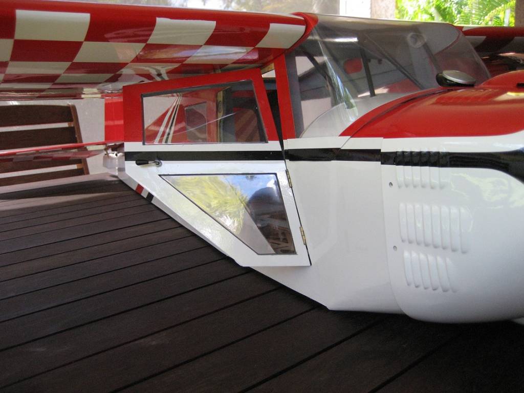

Hi all, just received my Taylorcraft and it is very impressive. All I have done so far is to have a look through and do a dry assembly. The quality is what you expect from hangar 9, everything fits up very well particularly the tail plane. From the look of it this machine is going to be a very quick build.
I was thinking of installing the SPE 26 in this plane not sure yet? I also have a Saito FG 20 sitting there but not sure if it will have the required power.
Here are a couple of pics to start the ball rolling.

Gday Dale
It does look good was that a full body pilot I could see in the pic? Look forward to hearing how the build goes and what powerplant you decide to use..Keep the pics coming

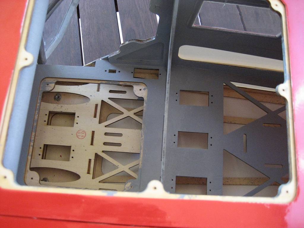

And some more. I haven't had much to do with the Zenoah, are the mountings different on the 20 and the 26. The only marks on the fire wall say 20ei.

The pics look good. Can't wait to get mine. What you can do is remove the flat mount plate from the back of the engine and mark a center line from left to right. Draw a horizonal line thru the marks for the G20 on the firewall. Lay the mount plate on the firewall and line up your center line on the mount plate with the center line on the firewall and the horizonal line you marked on the firewall. The horizonal line should be lined up in the center of the mounting holes. Now, use your mount plate as a template and mark the hole locations and drill.
