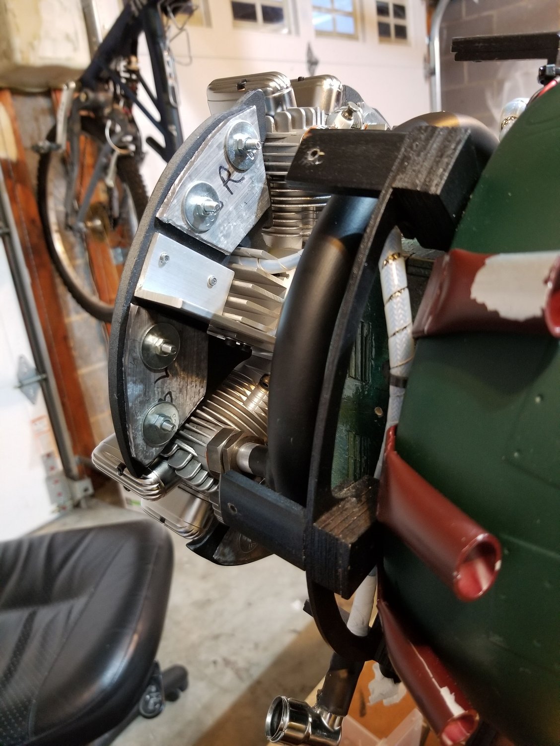

It's been done 100 or more times but routing the plug wires, so they don't make contact with the Keleo exhaust ring seems to be a problem.
Does anyone have a picture or illustration of how it's done?
Thanks - J Tab

Inside the ring, if its a concern, wrap the closest section of the lead with HVAC alu
aluminum tape, to reflect the heat away from the lead. Those spark plug leads are the same material as the plug wires on your car, alone they should resist heat pretty well, but a little insurance never hurts.

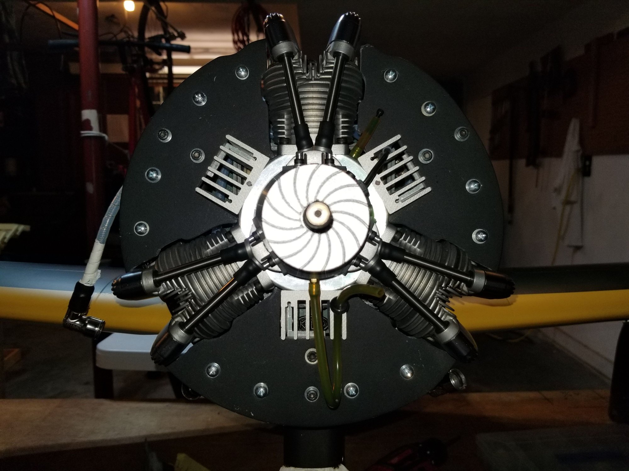

My Zero is almost ready to maiden. I had it fully assembled tonight and took measurements required for a manual calculation to determine the CG. If the plane (estimating) weights 32lbs (28lbs on the front mains and 4lbs on the tail wheel) the plane will require (1.82lbs or 826.4 grams) over the engine to balance at 145 mm CG.
In the next day or two I will weigh the plane on the Xicoy CG balancer and post the results.
Question - Is 826 grams the approximate amount of weight required to balance - with the Saito FG90R?
Regards - J Tab

Jake , mine took several pounds more than that ,but my weight was placed as far forward in the engine Box as possible , but not over the engine . I used a Vanessa rig to balance mine . It flies perfectly fine the weight needed to balance on the factory published CG .

According to the Xicoy CG Balancer, 2.68 lbs. is required around the engine to balance at the 145 mm mark. The CG as the plane sits now is at 170 mm. The plane is 30.75 lbs. before adding nose weight.

Added lead today bolted to the baffles and on bottom of motor box. Final weight / CG numbers are as follows:
Weight/CG before: 30.76lb / 169.3 mm
Weight / CG after: 32.61lb / 152.02 mm
Total weight added: 1.85lb.
Approximately 5.5 oz of lead is bolted to each of the 3 baffles. Hoping the weight does not stress the 1/8" aluminum angle brackets.
