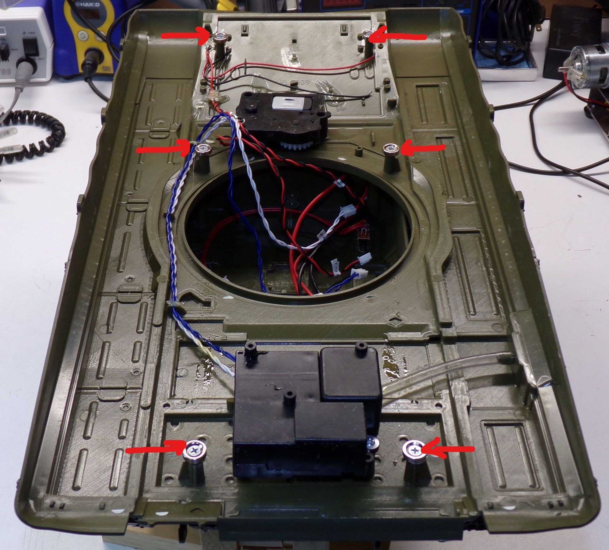

Upper hull magnets. Magnets are 10mm diameter M3 countersunk N52. Keep in mind if you use countersunk magnets you need to have both north and south polarities to work together.
