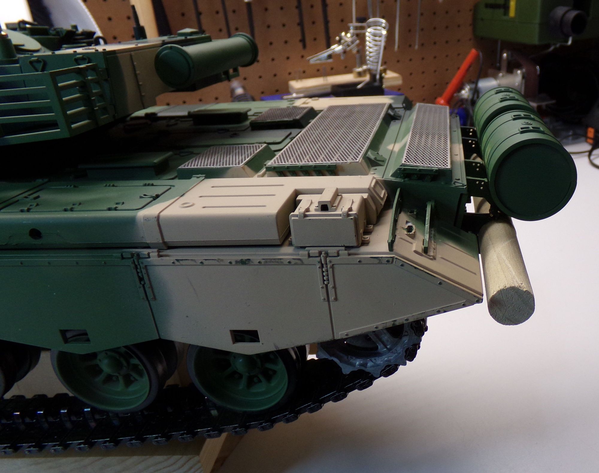

had to remove the LED lights in the rear as I mistakenly blew them out. I failed to see the note about the Open Panzer TCB that says it puts full power to the LED ports on the board and that I would need resistors. I have replacement LEDs coming in the mail today - WITH resistors.
