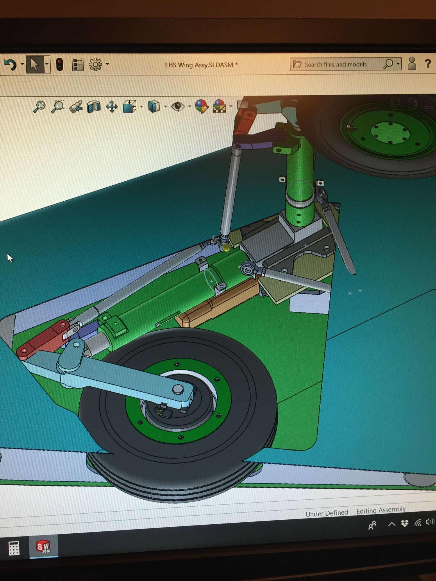

Prelim layout of the MLG. Electron EV-50s installed. The strut and wheel can fit into the MLG bay if I rotate the strut about its centerline axis. A yaw arm was added to do this. If I don't do this, commercial retract unit would not be usable - because the swing angle of the strut is angled in the planform and side views. the retract unit would be poking thru the top of the wing.
