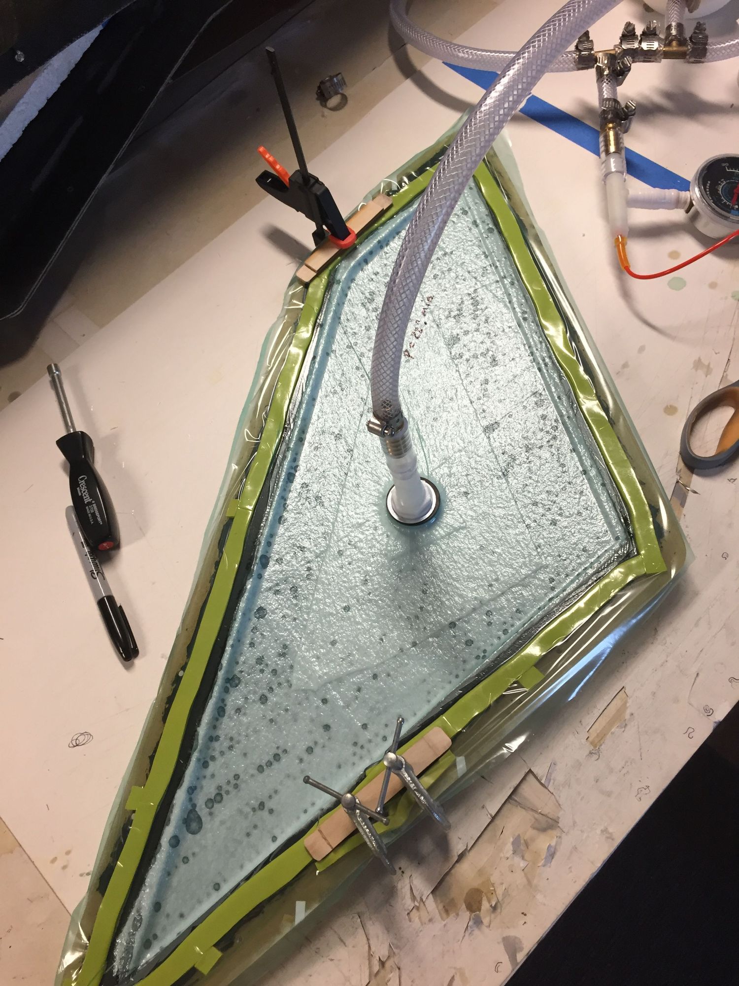

Vac bagging the Htail skins. Initially I tried using the method shown with yellow "dum-dum" tape sealant and single layer vacuum plastic sheet, but I could not keep good vacuum. After making the first 6-7 parts, I switched to using full bags going around the entire mold. Much easier to seal.
