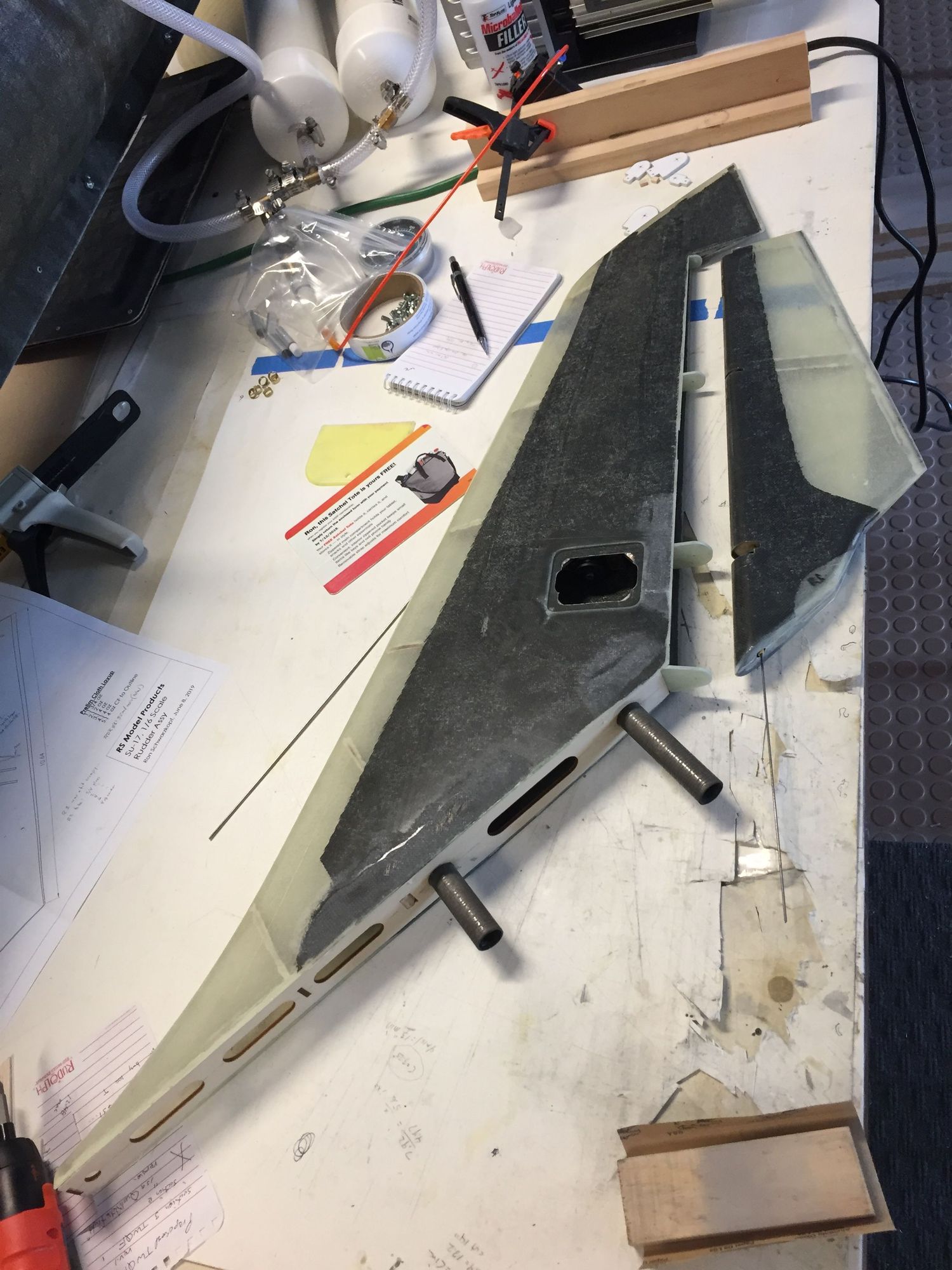

When I laid up the LH Vfin skin, I added a servo cover in the mold. When the skin is laid up and bagged, you'll be left with a skin that has a pocket for a servo cover. So that's what I have here. Also followed same process to lay up the rudder, with separate molds.
