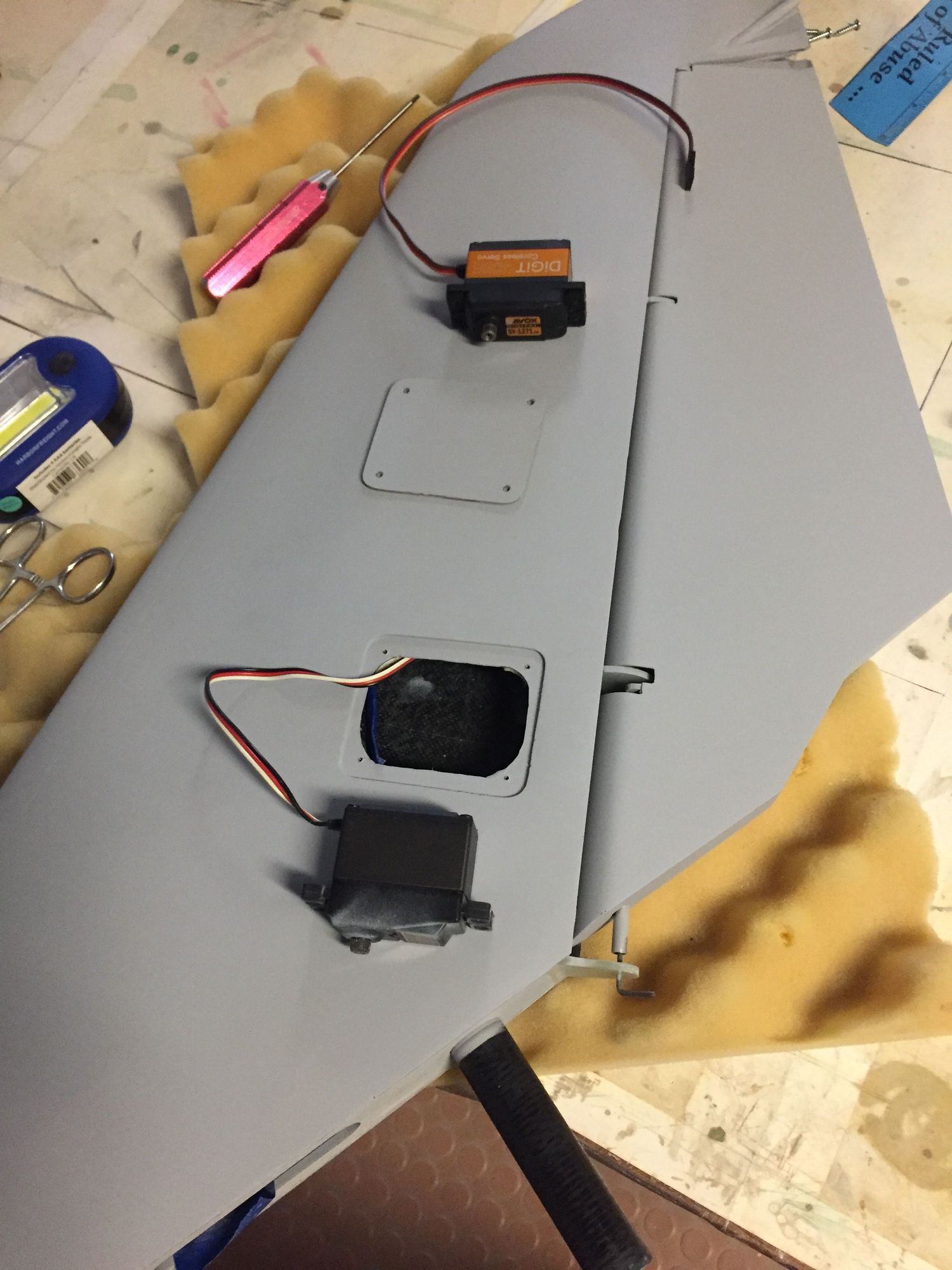

Added G-10 plates to hold a piano wire hinge, got some primer on the parts, and almost ready to throw onto the parts rack. Except after running the (approximate) loads numbers, I decided to go to a higher torque servo, and decided to run everything at 7.4 volts. So we're doing a servo swap here. I decided to settle on Savox servos for just about everything in the model.
