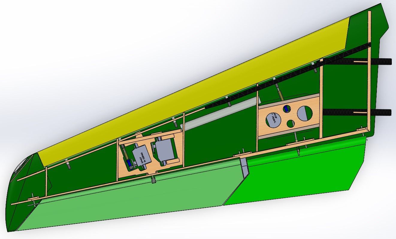

Outboard wing panel (LH side), with the wing upper FG skin removed. Basic setup with a Fwd spar, and a TE closeout spar. servos accessible thru 2 lower covers. Inbd portion of this panel has 2 carbon rods, to pass the load from the Outboard wing to the Aluminum sweep arm on the Inboard wing.
