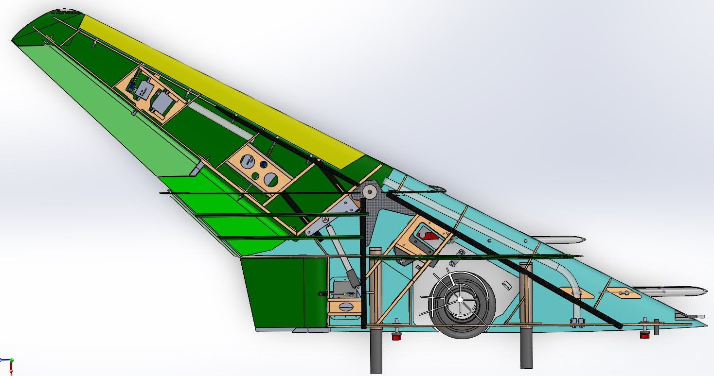

Outboard wing mated to the Inboard wing, with both upper wing skins removed so you can see some of the load path. The carbon rods of the Outboard wing are clamped to the Aluminum swing arm by 3 clamping screws accessed on the bottom side of the inboard wing. Wing is shown in the full swept aft position.
