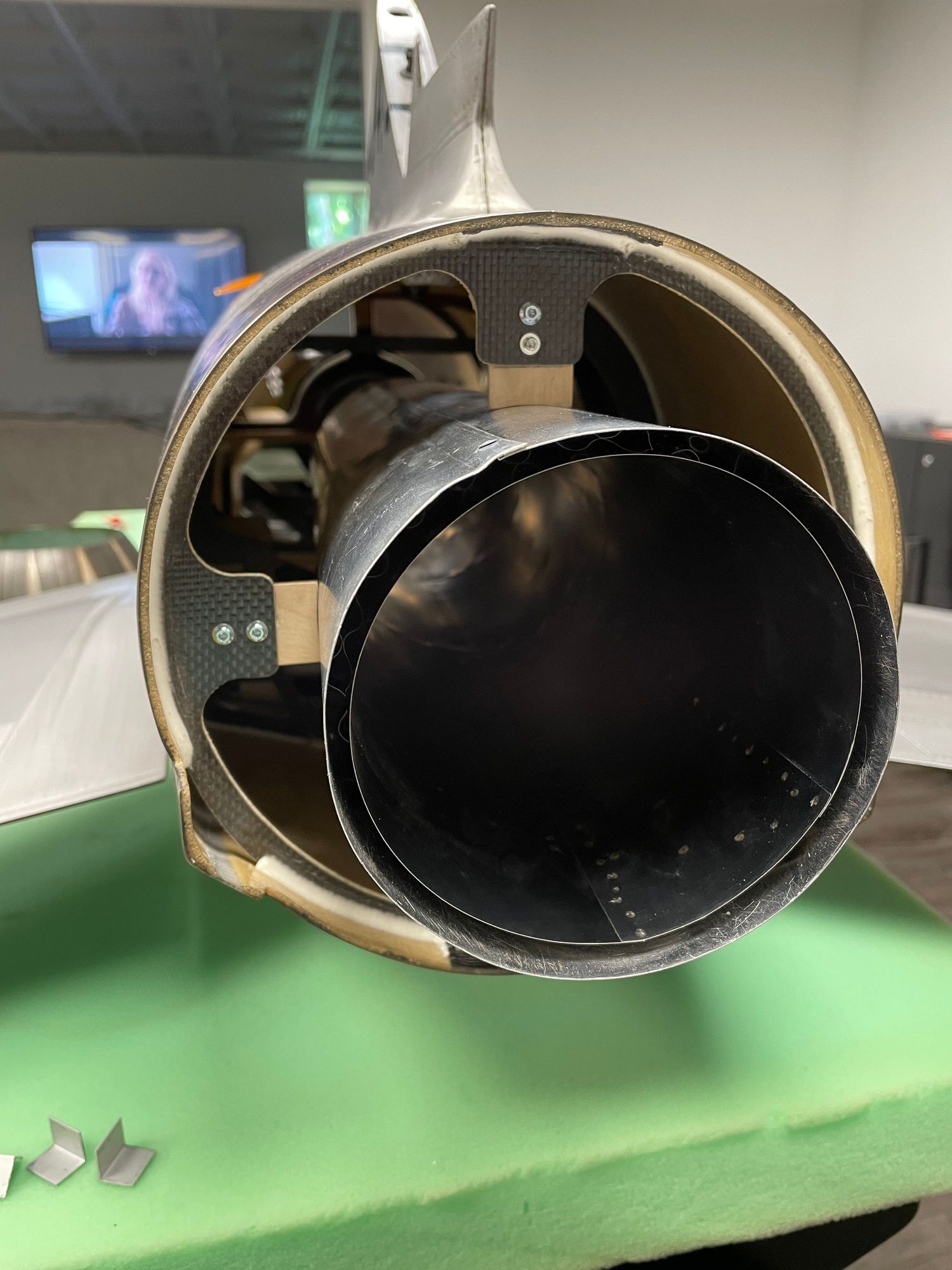

It is necessary to add ply extension pieces to the back of the carbon former to support the tailpipe at the back of the fuselage. These are not included so you will need to make your own ply extensions. Supporting the pipe at four locations is sufficient because the outer pipe is very rigid.
