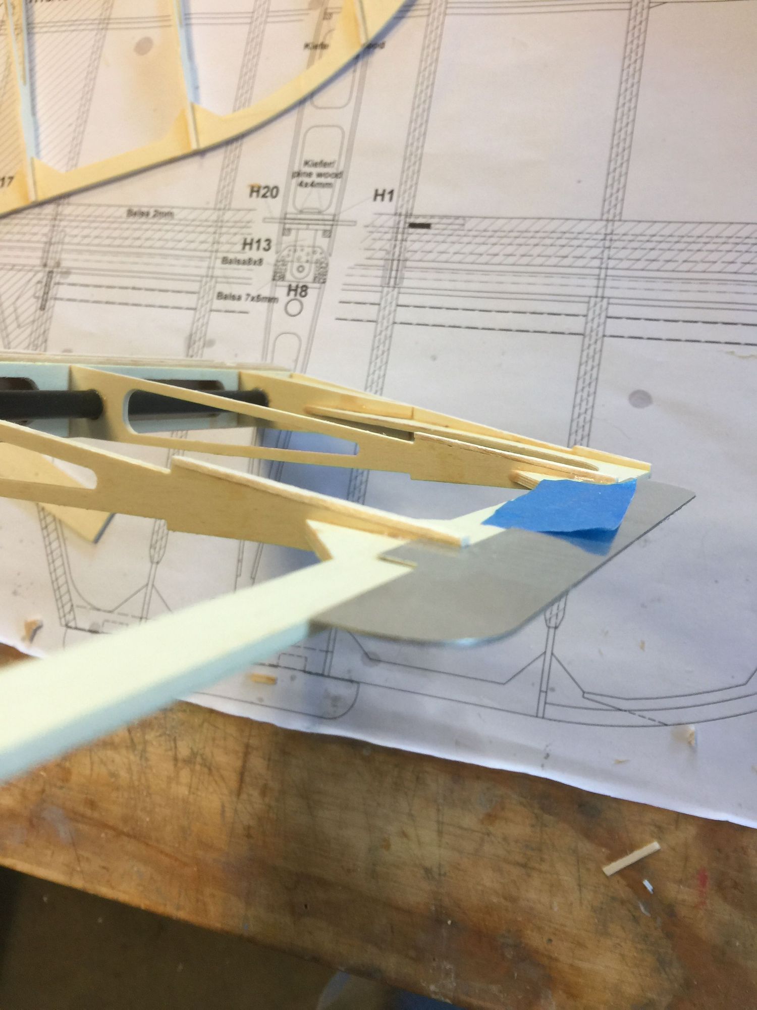

I biased the inboard end cap so that it was flush on the bottom and about 1.5mm on top to account for all the pocket space. In this pic you see the balsa caps I put on the rib ends, most of which will be sanded away to allow for the pockets
