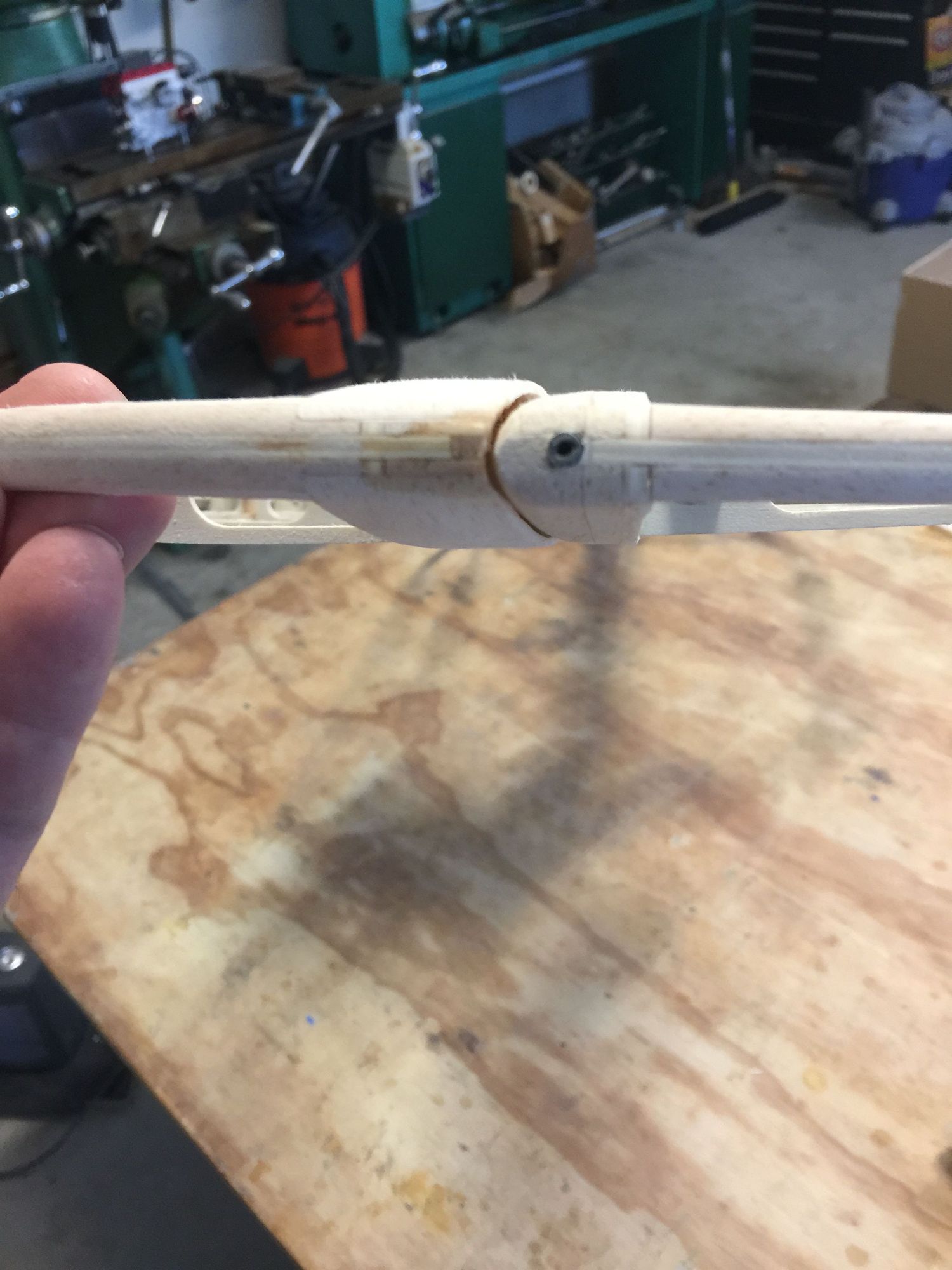

mitchilito December 28, 2021
So happy with this. Just fyi, I cut the 2-56 threaded part of a metal dobro clevis off and glued into the ends of all my hinge tubes. Now I just screw a rod into them to remove.
