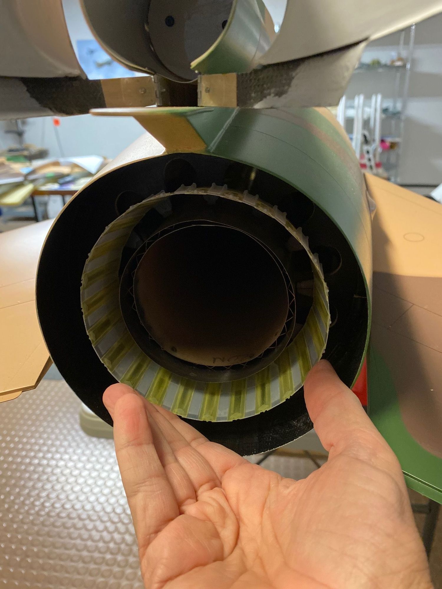

Checkfit for size. There is an air gap between the outer pipe and the inside of this new exhaust nozzle part. Same with another air gap between the fuselage wall and the new nozzle. I think this should provide enough cooling without the nozzle having a meltdown. One way to find out!...
