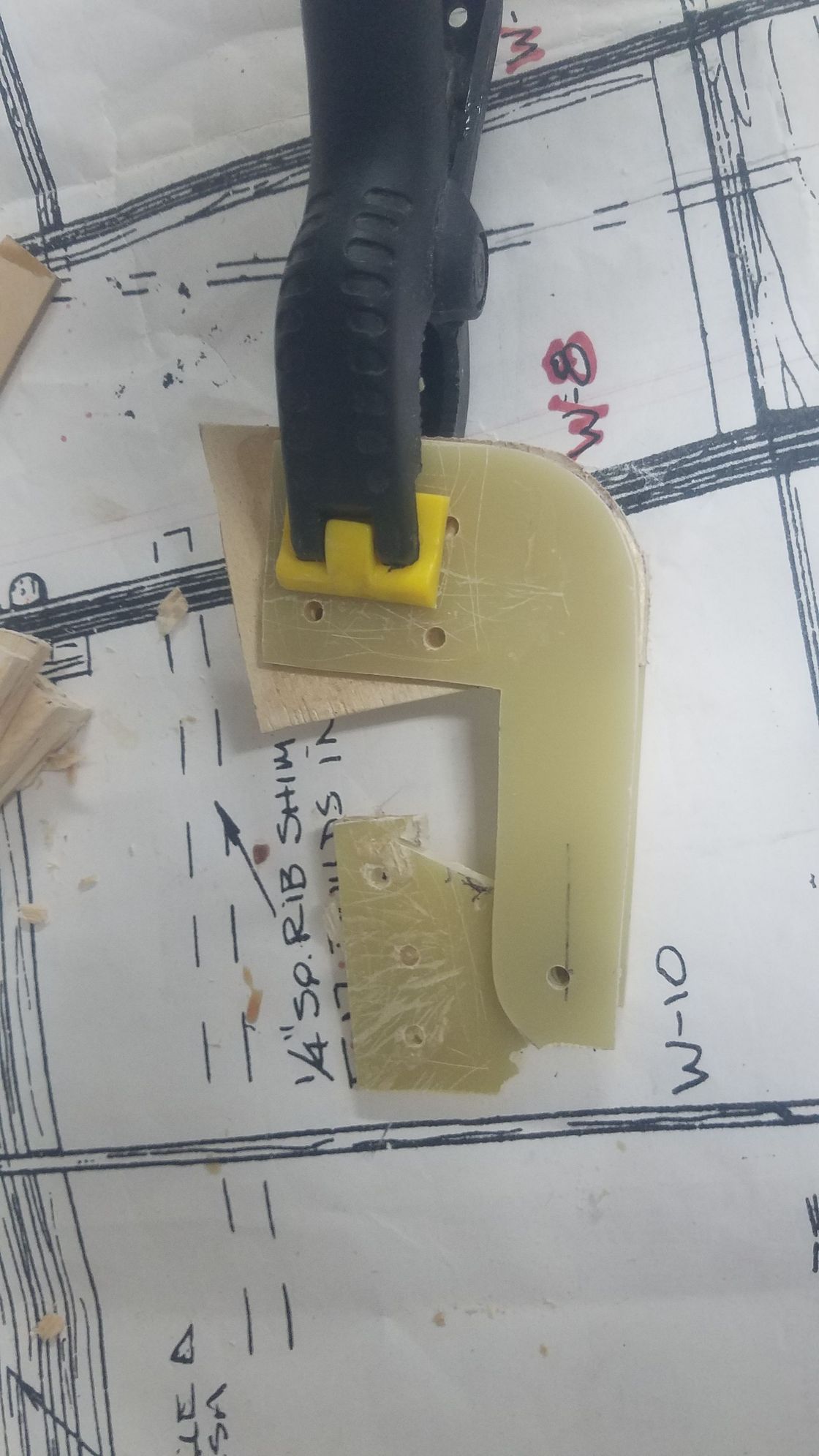

One other hinge ready to go. I think I will tack weld the G10 in place with Aeropoxy making sure of the alignment, let it sit overnight and then install the blocking with more Aeropoxy. Bad thing is that the hinge structure will not be able to be removed without destroying much more material by using Aeropoxy. Did I mention, it's got to be correct this time.
