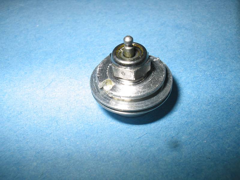

OK, here we go.
Initially I couldn't make a good result using Japanman's method of sharpening a common Phillips head bit. So, as related in the first thread on the subject, I found a countersink drill bit that had the correct angle and, along with the correct tap and the use of my Taig lathe, I was able to do up Cox plugs and also make turbo buttons from scratch. Great if you've got a lathe but what if you don't? So, I revisited how JMan did it. On a drill press but using the bit that worked so well for me.
That is pictured below.

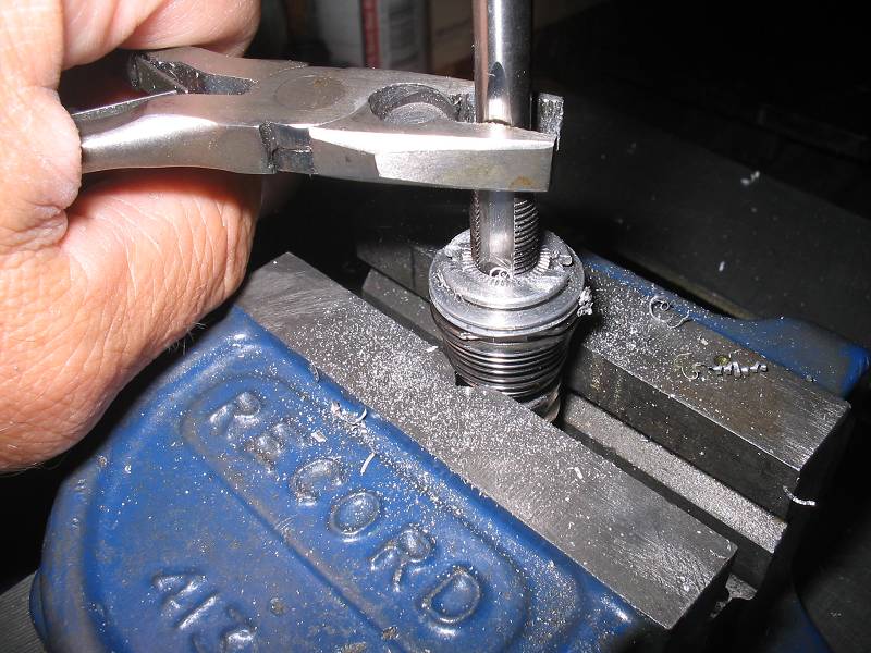

First, you screw your plug into a Cox cylinder to act as a holding fixture and firmly, and squarely install that on to your drill press vise.
Then you use a razor saw to cut off the crimp to release the center post. Be sure to dig out the filament. Take out the plug and use a sanding block against the top face to clean it up. Reinstall and make sure the plug is now tightly screwed in.

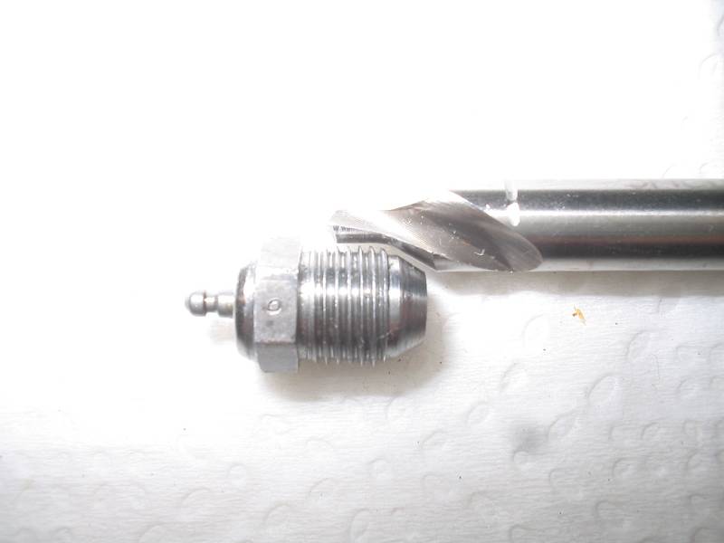

Then you drill out the plug using the tapered drill. Note the collar to act as a depth stop.
Then you use the 9/32" drill bit for the threaded portion. Another collar as a stop.
Next, use the drill press as a guide to make sure the tap runs dead square into the bore. No, freehand won't do, I don't care how good an eye you've got. It has to be PERFECT. Chuck up the tap very lightly, we don't want it to stick, just use it as a guide. Slide your plug underneath and using some small pliers, draw down the tap and start turning. Note the beautiful chip, just starting. Start it dry, then add some tapping fluid and just work it back and forth by hand till the tap bottoms out.

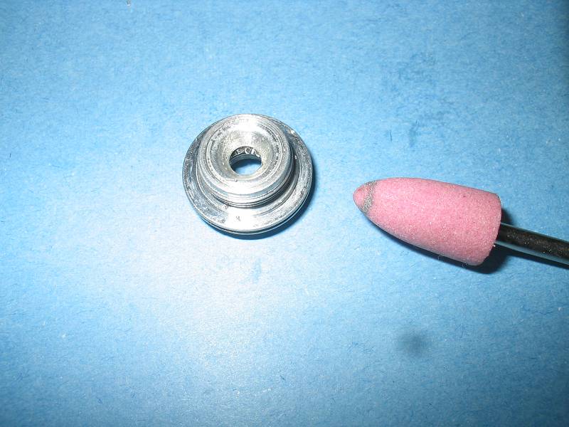

Once done, clean up the underside with a mounted stone to take off the burr that will develop.
Clean it up thoroughly with soap and water and don't forget to work the threads firmly with a Q-tip. You absolutely must do this, them chips embed themselves into the threads pretty solid.

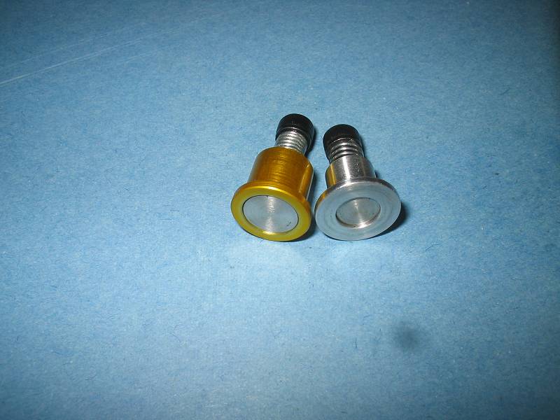

Finally, the turbo plug has a diameter larger than the bore of the head clamp so this must be drilled out to 3/8".
OK, you're done, you're so smart you oughta president.![Wink](https://www.rcuniverse.com/forum/images/smilies/wink.gif)
But uh, oh, testing it on your engine shows a serious leak. NO MATTER HOW TIGHT YOU MAKE IT. What, miscalculated on the depth stops? Can't be I used a good one done on the lathe as a guide. OK, maybe got it wrong, maybe the threads aren't going deep enough. Drill and tap a bit deeper. Nope, still leaking. What the,,, OK, dress up the seat with the counter-bore,, just a bit,, not too much. Ah sh**t, (shoot) bored clear through. DANG.
OK, start all over again, this time paying REAL CLOSE attention to how deep we go with both bits. NOPE, that wasn't it. OK, try a third, this time using a feeler gauge to adjust the depth, bit by bit. Nope, the *&%$#@ thing still leaks. That's the third plug and now I'm clean outa bad plugs. Oh god, no, I'm going to have to trash a GOOD plug??? At 12 bucks a pop?

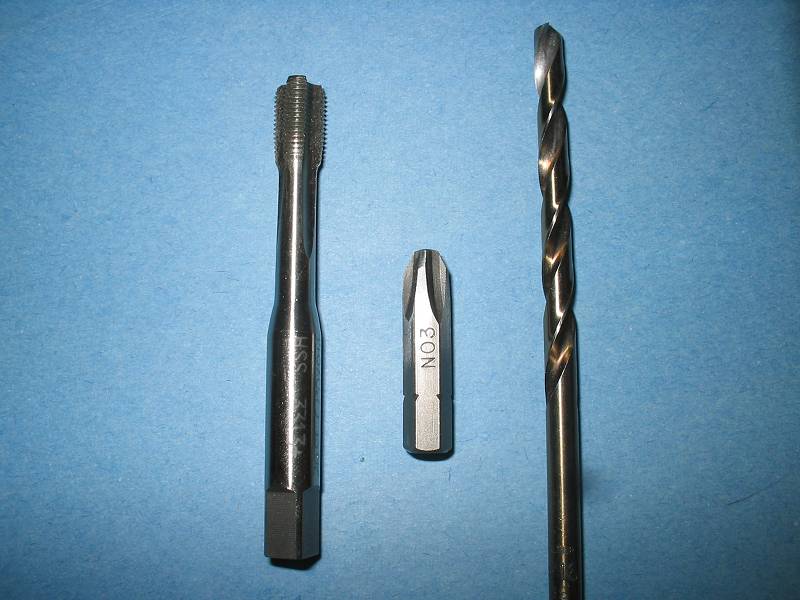

After mulling things over while munching on a sandwich and sipping a coffee, I decided to hit the computer and read some of the past references on the project. It kept creeping up that Japanman had done such a good job on just a drill press, no lathe required. Yet using a drill press I got three duds in a row. And yet on the lathe, no problem. Then it dawned on me. The key was the Phillips bit that JMan used.
The first picture illustrates three that you get in the typical tool kit. At the very first attempt, I used the number 2 bit for no particular reason except that it seemed sized right for the job. It, along with the 13/32" bit for the tap was used but I got leakage so I went looking for a substitute for the Phillips bit and that's when I found the counterbore bit that had the correct taper, shown in the second picture.

SO, as it turns out, bit number three is used to cut the taper AND the bore for the threaded portion all at the same time. Yes, it's not a cutting bit but here's the deal. Get yourself a brand new one, one that has never mated with a screw. Bad imagery, I know. Anyway, use a fine stone or a sanding block with 400 grit to dress all the cutting edges. You don't have to make them razor sharp, just take off any burrs or imperfections. Pay special attention to the taper portion. Get it nice and shiny. Try not to alter the taper. With care and a light touch it can be done.

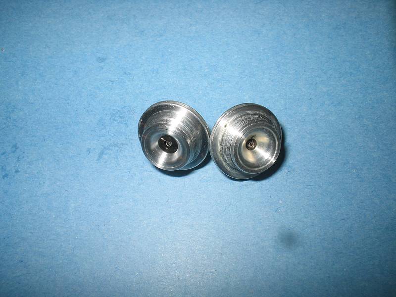

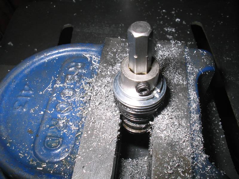

Picture four shows all the tools you'll need. The number 3 Phillips bit, the tap (M8 X 0.75 bottoming) and a 3/16" drill bit. The latter is only used as a go, no go gauge.

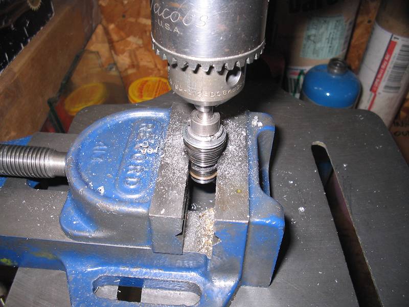

Use the Phillips bit to drill the taper AND the bore for the threaded portion. This is the key. In the previous set of instructions, doing the bore for the threads separately on the drill press did not guarantee that it was on the same line as the taper seat. The accuracy of the lathe assured this,, not possible free hand with a drill press.

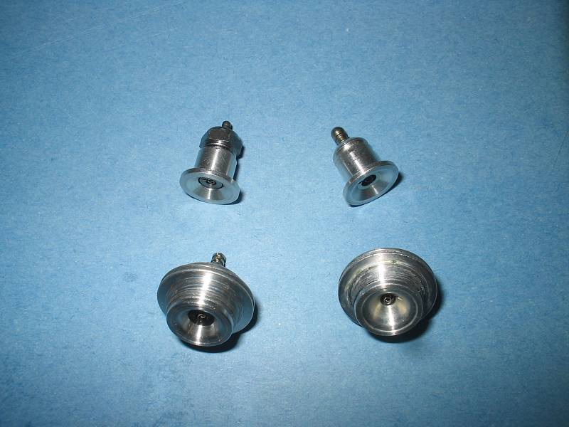

Picture 5 and 6 shows the Phillips bit cutting cleanly and effectively. The key here is to go slowly and to use the 3/16" bit as a go, no go gauge for the hole at the taper. Yes, this is tedious but the point here is to get a good result first. Once that's done, you can use the good piece as a gauge to apply the collar as a stop for the next batch you do as in picture 7 and 8. You ARE going to make a bunch of these aren't you? No sense letting the expense of that tap go to waste.![Smile](https://www.rcuniverse.com/forum/images/smilies/smile.gif)

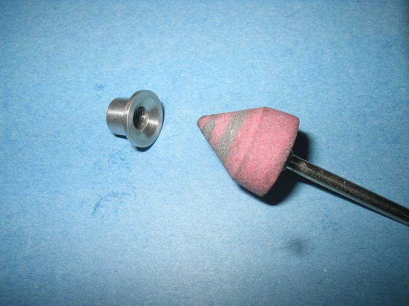

Once again, use a mounted stone to deburr the underside and from here follow the steps in the first set of instructions.
Success !!!
!!! What a delicious feeling having the prop snap over smartly indicating a perfect seal. Testing with a bit of oil at the plug interface shows no bubbles and gentlemen, finally, we HAVE it.

You guys might be forgetting that the average 'home shop' drill press is not worth a damn for doing any sort of 'Precision' machine work. Why you ask? Even though the spindles are probably running close to true, remember these relatively cheap drill presses are using bottom of the line EL CHEAPO chucks ..... any drill press is no better than the CHUCK that it uses. This is why a GOOD professional chuck will cost probably three times as much as the average 'home shop' drill press ..... just chuck up any longer drill bit in your drill press ..... now turn on the switch and watch it wobble like crazy at the tip!

" now turn on the switch and watch it wobble like crazy at the tip! "
Who says you can`t drill an Oval hole.
From the pictures Andy posted, it looked like he has a Jacobs Chuck,on his press.I recall Those, as being one of the best..MayBe the 6 sides, on the phillips screw tip ,help to keep it running true ,too,plus it`s very short,and stubby,and can`t really flex much..Just ,something else to wonder about.

Injunnut, Dave,
Gotta contradict both of ya. Yes, it's a Jacobs chuck, the drill press is not one of those 50 dollar Chinese jobs,,, it's domestic, bought some 30 years ago and it cost me the price of a radio. No tilt table but I like it that way. Annoying is that it won't cinch down on 1/16" but WILL do up to 1/2", or more.
Now, despite the chuck being a Jacobs, when I cut using the Phillips bit, I get a slight wobble when it's cutting. Huhhh, how? Why? Well, the Phillips bit, instead of the press, IS one of those Chinese deals.
Despite that though, the idea is that the bore for the threaded part is cut at the same time and exactly on line with the taper.
I'm speculating that Japanman, living in, well, JAPAN, has got both a quality press and also bits made in Japan. On the other hand, my SONY Walkman is made in,,, CHINA.

I think that cutting the taper,and, bore in the same opperation IS the Key..Stewart is Right, about the Squish ,on, a Hemi head though .The Best working example I can give ,is on my Early mod. Race Sled.Its a 1/2 mile,ice oval Racer.The Engine is a 340 c.c.,Hemi head, Twin Cylinder ,Rotary valve,Rotax,Free air cooled,with dual Carbs,and, Twin tuned exhaust pipes,exiting out of stingers The Engine is ported and polished,The Crankshaft runs on ball bearings,and the Rods are on needle bearings @ both ends..The engine is extremly perticular about it`s "Squish"..It needs to have, exactly 0.006",between the piston top and the "Squish Band" ,at the bottom of the head.If the cylinder head is any closer, Detonation occurs,,,any further away ,and, power is lost.....I have an appointment to attend, this morning,When I get back, I`ll look for my Books,they have some good illustrations ,and explanations, about Squish ,and, 2 stroke Hemis.I`ll scan them ,and upload ,if anyone is intrested in seeing them..Let me know
