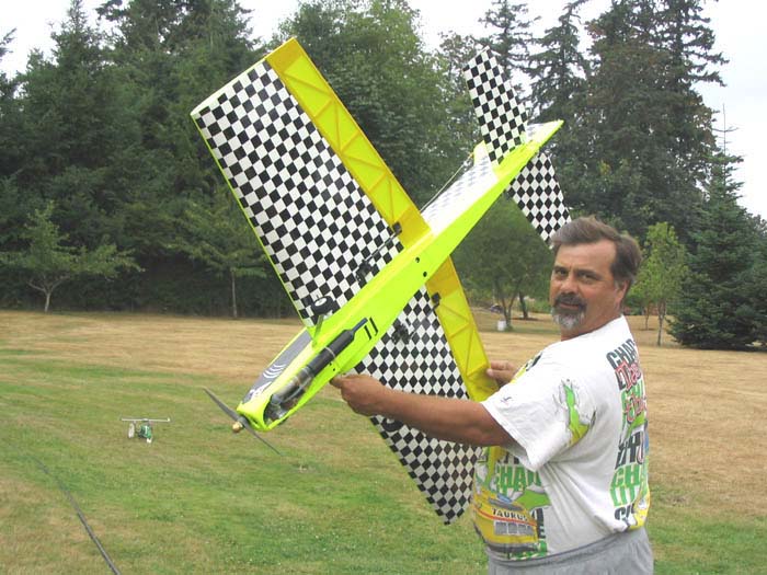

I built a BN 40 over the winter and modified it to do more 3D. I had a MDS 68 up front and with careful building I was able to keep it under 5.5 Lbs. What a great plane it was. The only thing mine did poorly was snap rolls. The building, kit style was pretty hard. But I was rewarded with a great plane. Still wish I had it.

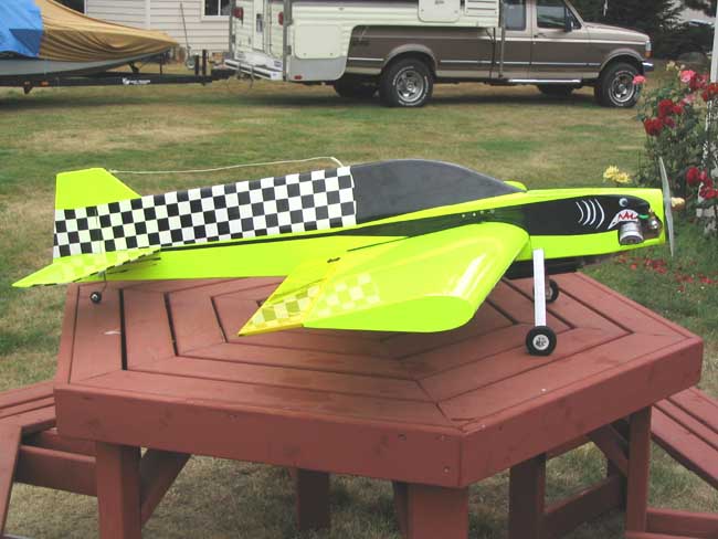

I have both the small Balsa Nova and the large one. They are both great flying planes and my favorite planes to fly. Naturally the large one flies better than the small one. For a high performance plane it is very forgiving and lands better than anything I have. Dead sticks are easy because it maintains good control at almost any speed. This plane never does any thing ugly or surprising even with extreme abuse of the sticks.
There are no foam or plastic parts in the construction. It is built up and completely sheeted with 3/32 balsa. The fuselage is a continues structure from the tail to the spinner. The cowl is built up but then glued to the fuselage. I didn't like that because it's a nuisance for engine installation so I made the cowl a bolt on unit. I use a Super Tigre 2300 (1.4) and it's a tight fit. With the Moki 1.6 I think the fiber glass cowl available as an extra may be a must. The Moki motor mount could be a problem also. Unless it's small in the back it might cause you to have to drop the thrust line a little.
The canopy and turtle deck are an integral part of the structure of the fuselage. As a matter of fact a curved lamented beam runs from the front of the canopy to the to the tail across the top. They did this, I'm sure, because the plane is a mid wing and the part of fuselage under the wing is cut out from the fuselage and glued to the wing. I'm sure the beam is to get the lost strength back and provide a good load path.
The wing has no main spar through the center section. The too panels are built and butt glued together. I didn't like this but went with it because the amount of redesign necessary to change it. I did glass the top and bottom with 2 layers of 4 once cloth and have had no problems even with extreme maneuvers and about 150 flights.
The gear installation is too weak. When you look at the plans you'll see what I mean. I added a piece of 5/32 ply running from the first bulkhead to the firewall and both sides, on top of the built up fuselage bottom plate and gear mount. I didn't like that the first and second bulkheads (front of wing/ back of wing) were only 3/32 balsa so I doubled both of them with 3/32 ply.
The horizontal and vertical and the control surfaces are all built up except the ailerons. They are huge pieces of construction lumber. I was going to throw them away and build up the ailerons but instead I cut 13, 1 7/8 inch holes in each one with a hole saw.
The wing is mounted with 4 bolts. The kit came with 4 nylon 3 1/2 inch bolts. They weren't quite long enough for the front. Only about 3 threads of engagement so I used 4 inch stove bolts in front.
The hardware that came with the kit is so so. I used some and some I didn't. The kit doesn't come with pull- pull for the rudder but recommends it. It's a must.
I considered replacing all the 3/32 sheeting with 1/16 to get the weight down but didn't do it because of the risk of getting a wavy sheeting job. I made liberal use of sandpaper and came out at 10lbs. 10oz. with 2 ounces of lead in the tail. I've heard reports of this thing at 12 to 12.5 lbs. Maybe I just do a lot more sanding.
The ST2300 will pull this thing out of a hover and reach flight control speed going straight up, but not like a rocket. The Moki should make rocket launch out of it. The ground clearance provides plenty of room for big props.
If you get one I'm sure you'll love it

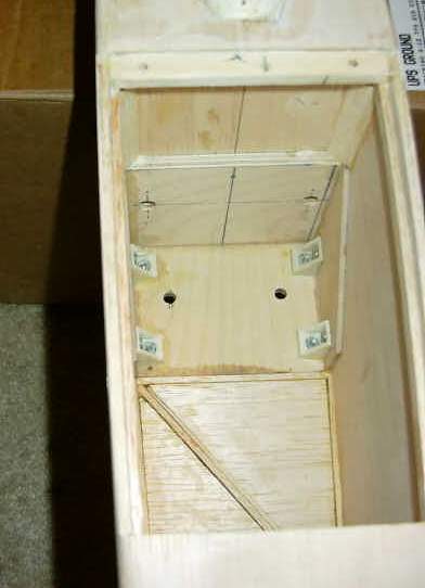

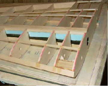

Hi Guys,
I just received my BalsaNova 120 by FedEx today. Of course, I ripped open the box to have a look at my next project.
I was surprized that the kit comes with wheels and a tank and a bag of hardware.
Looking over the planes and insturctions quickly, I think it would be fairly easy to incorporate the wing tubes into the construction by not cutting away the bellypan. That is my early idea anyway. Looks easy to do, we'll see once I get into it.
BTW, this kit is laser cut with parts in bundles. Instruction need to be updated, but it's no big deal. And yes, this is a builders kit, MY KINDA KIT!!
I can see right away I'll be using some blue foam for molding some items. As a matter of fact the whole fuselage could be done in foam rather quickly.
Just some early thoughts, I'll keep you posted.
FlyinBlind

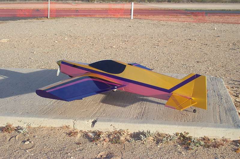

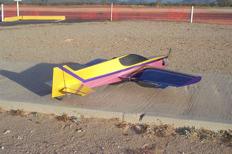

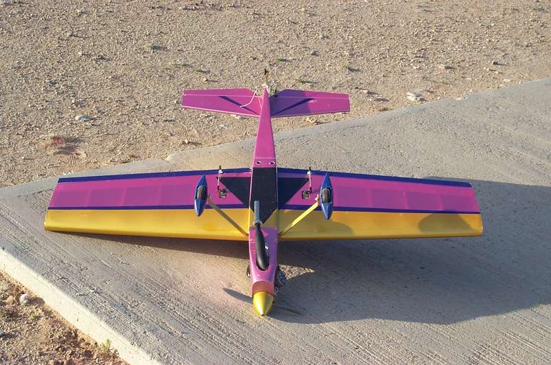

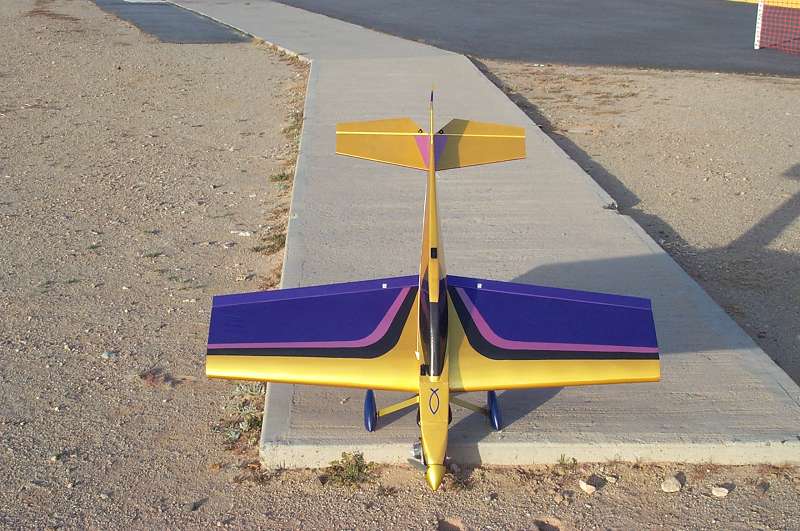

Flyin blind,
She flies wonderful.
To be honest with you she is my hanger queen..
I have had her built for over two years and only have about 12 flights on her.
But she is going flying tomorrow (saturday) if I can shake this cold.
We are expecting a low of 40-45 and a high tomorrow of about 70.
Darn, this is why we live in Arizona!! No snow to shovel and we can feel our fingers after 10-20 minutes of flying (of course after 10:00 am when it heats up enough to take the gloves off and fly)
If you look real close to the top of the fuze (behind the "Cockpit") you will see where I mounted my remote glow. It would have been nuts trying to unlock the glow from an engine mounted 45degrees down towards the ground. Nope, not for me.
I also used Robart Fuelers in lieu of fuel dots, as I thought they looked cool. And it does something to the look of the plane.
To add to the look of the plane, I gave a friend of mine a piece of the monocoat and the aluminum gear and spinner and he had them anodized for me. I dont worry about burning off the anodizing when starting her.
The only change I made was to change from a single screw to a double screw mount for the wings.
Good luck in your build, and let us all know how she flies when you finish her.....

Hey B_L,
My Balsa Nova 120 is about half way completted. The fuselage is just about done. I am using a Magnum 120 four stroke, as this plane will also be a sport flyer.The motor is mounted inverted using the stock muffler.
I really like the way this plane has gone together. The parts fit is great, and the quality of the wood is super.
I have been working on other planes, so put to the BN in the corner, but will be working on it again shortly.
I too added to the rudder and elevator. I did change out the stock two piece landing gear for a one piece set from TTP which are nylon filled.
I know my planes would go together allot faster if I would just build them the way they are designed instead of changing them. It is enevitable that when you change one thing, it effects other things also.
Good luck with your BN, it's a great plane. Post some pictures when you get done, as well as a flight report.
