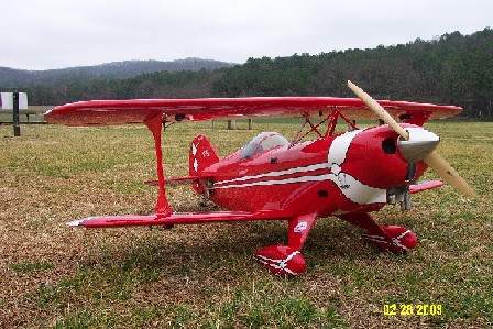

Well I finally finished my Pitts Special. I followed many of the post suggestions and so far so good. The Fugi 50 started for the first time today. The Megatron starter is on back order so I hand cranked her. It took a little while, but I got her going. The engine ran very well requiring no adjustments right out of the box. Sure glad I followed the suggestions to pin and fiberglass the firewall. The engine does vibrate a good bit. Much more than an OS 160
I bet I have more than 100 hours in this ARF kit, and feel as proud of it as though I built it from plans. It's a beautiful model.....
I had several things I had to work out. Like getting the upper wing cant angle set properly. I drilled the holes for the mid wing struts two times, but got the left to tight and right to left alignment to the lower wing centered. The prop hub for the 50 was too long. Fortunately the prop hub for the 64 fits perfectly. Lastly, I contacted Gerry Yarrish with MAN for help on the slave rods. He used brass tear drop tubing over threaded rods and then solder them in place. I messed one up and will get it right this week, but thats all that remains. The balance came out right on the mark and she weighs in at right at 17 lbs. dry. I have tried to down load a picture of the finished product. We'll see if it downloads
Hope to do the maiden flight next weekend, weather permitting. man it's been wet this winter.

Gee, glad to hear many of you found the same things I did. This model just won't let you go, even with all the negative post. The balance of the bad is made in the positive as well. From the bad experiences and from the good, we all learn which is the point of this site. Thanks for both. Thanks also to RCU for making this site available.
Responses to some of the questions. No wires for me. From what I could tell, the directions state that the wires are really for appearance only and serve no support function. A good friend and experienced RC builder/pilot suggested to avoid the hassle - no wires. I agreed. I have a trailer to transport, but can't fit the Pitts fully assembled in the trailer. Sure wish I could, but not worth going with a larger trailer. If I had, well, then the trailer wouldn't fit in the garage.
I decided to use vinyl decals vs the ones that come with the kit. This allowed me to make the decals larger and add a few extras. Had fun personalizing the model by using decals calling it "Pitts Extreme" rather than Pitts S. I will add pictures of the decals when I return from a business trip later in the week. Really added a nice touch. At least I think it did.
Thanks for the comments regarding flight characteristics. I hear ya Capt. Hal. I too have read the post and the MAN review about flight characteristics. Power on landings to keep it intact.
I did pin and fiberglass the firewall. I used 10, 1/8" dowel pins and then added the fiberglass and tri stock on the inside and outside of the mounting box. Then added fiberglass. All this was highly recommended by other thread post on the Pitts.... I also had the newer production models with the beefed up mounting box and added hard wood. I used socket head 440 screws on all wood holes for the Cabane and 440 socket head machines screws for the mid wing strut connections. I learned this after breaking a screw head off and nearly destroying the mounting hole for the Cabane. Thanks to a good friend and excellent builder, I had some help in getting this repaired and back on track. Thanks, Chuck!!!
Sounds like many of you found that to do it right, this model required many more hours than expected to get it ready for a gas engine and to complete. Like I said, I have roughly 100 hours in mine. I just took my time and kept focused. It's amazing how the little things can take so long. Nothing is ever as simple as it seems . :stupid: One master builder in our club has 1800 hours in a plans built beautiful B-25. So, I guess I have no complaints. See the model on our website under war-birds. http://www.rocketcityrc.com/
I will add extra pictures with an update on the maiden flight hopefully this weekend. Wish me luck. And for good weather too.

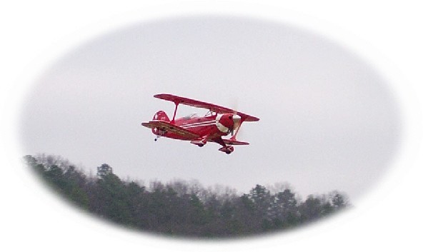

Hooley, loved the fly-by picture. Very Nice looking model. Great job! Can't wait to get mine in the air.....Peeded my pants several times just thinking about the maiden flight. I am going to cheat and have my good friend Chuck do the maiden flight. Of course no conditions attached... Heck, if Chuck can't keep her in one piece, well, I sure can't.......
Several post had me worried about the Fuji 50. As mentioned, I started it for the first time and ran it on 12 oz. gas at 25/1 gas to oil ration for break-in. Yes, it was challenging to crank, but not because it's a Fuji. As several post have mentioned, any fly-wheel spark generated gas engine will be difficult to start simply due to the lack of RPM's in hand cranking. Have megatron starter on back order.... But, after roughly 30 flips of the prop the Fuji 50 came to life. Note - have the prop set so the beginning of the compression run is at 4:00)
No hesitation right out of the box and required no adjustments. I was shocked with how well it ran after reading about all the concerns. As mentioned in the threads, it does start much better with a very wet carb. I had gas running out of the Zenoha velocity stack pipe. Much easier for choking the engine to get fuel to it. Simply place a finger over the stack to choke. ( Gerry Yarrish - MAN review suggestion) No hesitation with each single click up and down the throttle range. I never went above half throttle due to direction recommendations for break-in during the first hour. Also, didn't want to put so much stress on the airplane while sitting stationary strapped to a pole by the elevators. Will throttle up in flight.....
Answer to my own question about Quick Start spray to help in the starting process. It doesn't help at all.... The reason being is not due to a lack of high octane fuel, but the lack of spark in hand cranking. I do very much want the high torque starter now that I have tried the hand crank option. Arm was sore the next day. :stupid:

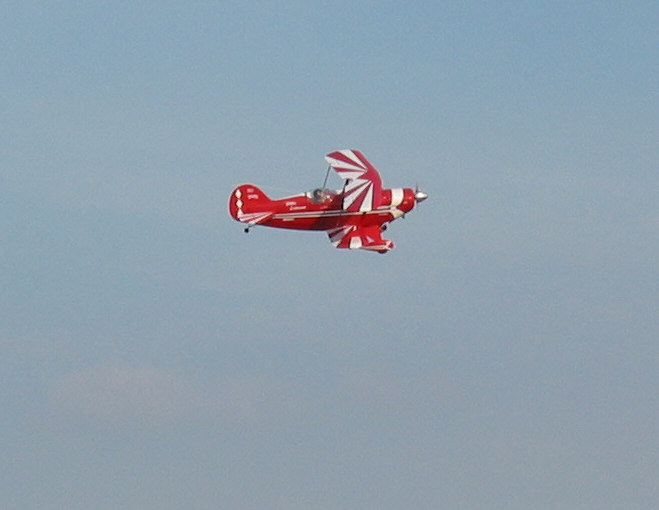

Well, it's official. It's airborne. Today marked the completion of this winters project and hopefully many more fun flights ahead for the summer. It was a picture perfect day, though a bit windy. I got to the field about 10:00 just in time for the wind to pick up. After assembling everything we fired up the engine and my friend Chuck took the controls. I manned the video camera. After a few test runs down the runway this Pitts took to the air and I was thrilled to death. She flew great! I should add that all the thread comments about flight characteristics were right on.
Chuck said the Fuji 50 had plenty of power and she was gentle on the controls in flight. Landing, well, that was another story. On the first attempt Chuck came in high and cut the throttle and let the nose drop. She dropped like a rock. I mean a real rock. Chuck went to WOT and without any hesitation he recovered after a solid bounce on the runway. Landing gear remained intact. On the next attempt Chuck brought her in with power and then cut the throttle right over the threshold. She bounced heavy again but all was intact for a successful maiden flight.
The wind picked up after that so I waited until the end of the day before I decided to take the controls. After getting up the courage to give it a try I decided to go for it. I manned the prop for the start and flipped, flipped and flipped until I gave out. Where is the Megatron starter that has been on back order for three weeks? After several attempts she just wouldn't fire for a second run. Well, maybe I just wasn't supposed to get a crack at her this day. At least she went home intact ready for another day.
When I got home I rigged up my 3/8ths drill with a spinner cup (Another thread idea), and tomorrow I will let the drill to the darn prop flipping until the Megatron comes in. I have to say that a flywheel generated spark is not for hand flipping, period. Once again RCU threads prove to be true. Go figure....
