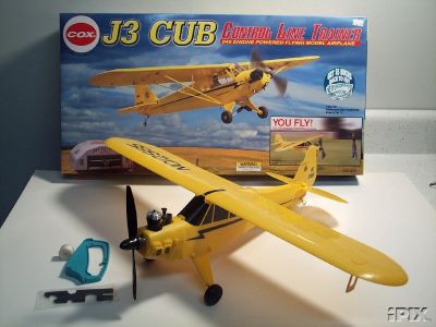

HELLO RC PLANE FANATICS.
I HAVE A QEUSTION OK YOU KNOW THOSE GLOW POWERED PLANES THAT ARE CONTROL BY A CONTROL LINE. I WAS WOUNDERING IF YOU ADDED A MICRO RADIO GEAR IN IT WILL IT FLY.
IS THIS POSSIBLE
PLEASE ANY INFO ON THIS

It ceartainly has been done in the past. The RC Nobler is a convert and is still being produced in kit form by Great Planes.
The problem with the plane pictured is hinging the surfaces and getting the control linkages made in the plastic material. Not impossible but you may have better luck starting with a kit and building in the necessary parts. Herr engineering (now part of Sig Mfg.) has some nice designs.

Hey NOS2006, is that old cox for sale? send me a message. theres no way you could get that thing to fly on its own power with rc gear even if you swiss cheesed all the plastic out of it and recovered it, maybe with a 1/2 mile runway but by the time if lifted off it'd be out fuel..........Rog

There's a much bigger problem with the plane pictured, i.e., the relative sizes of the prop and wing. While being flown on strings, the strings will counteract the torque. Without the strings attached, that baby will want to roll like crazy!

Rog is right. It is worth more selling it than trying to make it fly as an RC model. It won't fly RC fashion. Heck, it will hardly fly controlline! I fly both, and (with a couple of exceptions) those plastic Cox models are some of the most difficult to fly CL planes ever devised. I think they were a plot to discourage CL flying. There is a market out there among collectors of the the Cox line, however, if you can just tap into it. Good luck, Dzl
