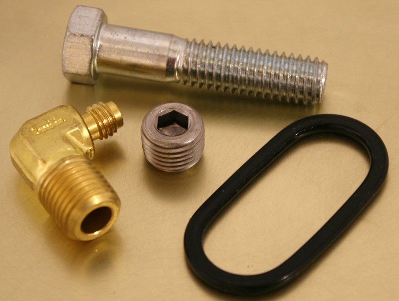

It also affects materials like O rings and who knows what else, I found out at work. This one was a regular round O ring. My guess is the out gasing caused the material to take a pemanant set.
