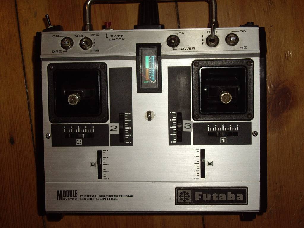

Hi all,
I have Just spent 8 Hours Repairing a very nice Futaba FP- 8-JN FM radio, it had alot of issues,
here in Australia we fly Mode 1 , this radio was Mode 2 sort of ???
The the Throtte (3) and Elev (2) were swapped in factory and labled but the trims were Mode 1 ???
I don't know why Futaba would supply a Mode 2 configed this way, the other problem was the Snap roll switches if pressed would lock up the Elevator [X(]
I fixed the mode Issue by swapping the wires to the Stick pots so every thing is Mode 1![Big Grin](https://www.rcuniverse.com/forum/images/smilies/biggrin.gif)
After alot of cct tracing I diagnosed the issue with the snap switches to be Faulty(yes this took a few hours !!! )I found the fault to be bad CD4066 chips which I replaced
I also cleaned everthing, all the switches were in good shape and did not need replacing.
The Manual was missing but is on the Futaba Site.![Big Grin](https://www.rcuniverse.com/forum/images/smilies/biggrin.gif)
Did any other Radios makers eg. JR, Kraft ect make any dedicated Pattern radios like futaba ?

The trims were done that way on purpose. It was called cross trims, made it easier to trim the elevator without taking your hand off the stick. Proline also used this and when I built my Ace Silver Seven I wired the trims that way.
To answer your question, yes all mfg's made/make what could be called "pattern" radios.
FWIW I used a Futaba 8JN in the early 80's as my main patten radio. It was not a popular radio because of the cost and Proline's stronghold.

If anyone finds one at a swap meet thats dead, no power ......BUY IT
The fault is a 0.1 ohm resistor being used as a fuse
cost of the part 5c !!!!
If anyone needs help fixing one, PM me.
There was also a Manual with settings for the radio for various F3a aerobatics, If any one has
one a copy would be nice as the radio cam with no manuals but I did get the box Reciever and charger.
I did manage to dig up a copy of the RCM Review, I will post it shortly.

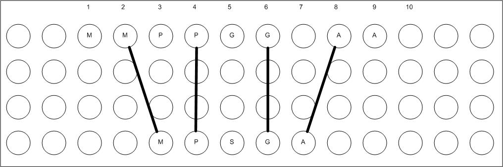

What about this Idea
I have a old FT-TF-AM from a old 5G radio, This has the same case as the 29MHZ FM FP-TM1-FM IN IN MY FP-T8J
The other thing I have is a old FF7 (One memory) I am thinking of making up a adaptor out of both these two items that will
look neat and professional.
I have also been told that 29mhz modules can be re-tuned to 36mhz ,35mhz and 40mhz
I dont want to do this, I like to keep things origonal or make mods that can be un-dun also I have 3 29mhz FM rx that I can use.
I will post pic's If it works
Johnkpap
