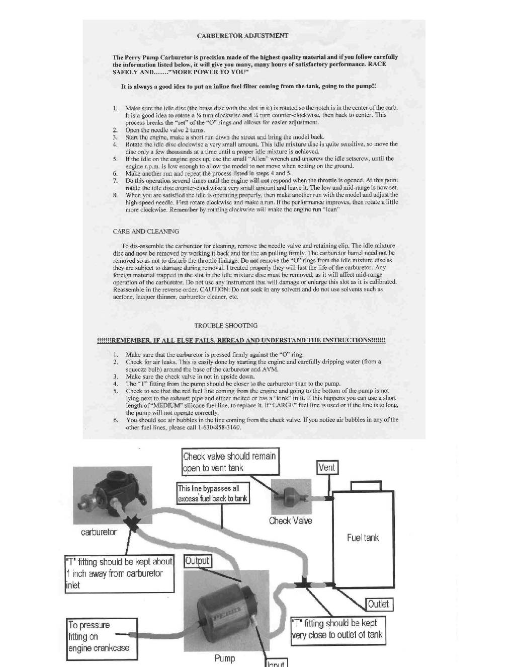

Hi,
I have a atlanta 60 with a Magnum .90 XLS. As you know due to the position of the tank, the engine is easily overfloated. I have been trying to use a Perry Pump or an Iron Bay regulator without much sucess. The best attempt was with the Perry pump which helped the engine not to sag when the nose was pointed up but I had some problems maintaining a reliable idle. Can anybody point me in the right direction as far as correct set up of an engine for this airplane?

The design of this airframe will make it difficult for an engine like the Magnum .91 to work well, as the Atlanta was designed for a pumped, rear exhaust .61 such as the YS .61 or the OS pumped .61 SF or Hanno Special. Your best bet might be to look for a pumped rear exhaust .61 on fleabay....

As Glowplugboy suggested,the Atlanta MUST have a pumped engine such as the YS .60 or .61 or OS RE pumper. Reason being is that the fuel tank is on the C/G and is much higher than the carb needle valve. This is what you are finding out in that your engine is flooding out constantly. Find you and OS or YS on #bay and have a ball.

Deadstick is correct that your best route to success is a pumped engine. Trying to attach Iron Bay or Cline to an Atlanta is analogous to a comment attributed to Dolly Parton's dad. He mentioned that her top side looked like someone trying to put ten pounds of flour into a five pound sack. The Atlanta's nose section is just to small to install the regulating equipment unless you hang it outside.
Although, Deadstick(sorry Dan) is a bit off about the tank being at the CG. It is really a good ways forward of the CG. But that really has nothing to do with your problem.

There's no reason why your engine shouldn't perform like any other. Don't risk losing a plane to an unreliable engine. Remove the pump etc. and follow some simple steps:
1. RTFM (read the manual) for your engine. Use recommended fuel and break in procedure. Google for tuning tips, there's plenty. Read till your eyes bleed and read more. Use an engine test stand if possible.
2. Thoroughly check, clean, and test the fuel system. Ensure no clogs, clunk is working right, muff press line has no leaks, filter clear, fill line if installed is closed, oil buildup in tank, etc. Test for good flow by blowing in press line. Check carb for clogged idle air bleed etc.
3. Use new glow plug and new fuel - shaken well to mix before fueling. Stale old settled fuel even a month old can cause problems.

I don't have an Atlanta but thought sense you mentioned that you tried a perry pump that the bypass method might relieve some pressure at idle.

Hi Le Fou,
The OS 61VF should work assuming the tank is not too far (I don't know how far you can go here) away from the engine. The Tank C/L is above the engine if starting upright, but below it if starting inverted. I know it is a bit of a pain, but I eliminated the problems of starting inverted engines by building a cradle to hold the airplane inverted for starting (regardless of the fuel delivery system of the engine). How far is the tank from the firewall?
The information above is correct, the Atlanta was designed for a the OS pumper or YS (the short stroke version as the LS was not yet available) or Enya pumper.

Here's a copy n paste from Towers tech department:
FEATURES: This pump will provide fuel flow in any attitude, tank position, or fuel level. Helps improve plug life and fuel economy. Works with any engine with a good mid-range of RPM.
COMMENTS: This pump should NOT be used on an engine that is equipped with an air-bleed type of carb (For Example: some O.S. and Fox Engines). If you have an air-bleed type carb Perry MAY make a pump carb for your engine that would work with this pump. This pump may be used, without modification, with an engine equipped with a low-speed needle valve (like Super Tigre engines). Pump Has Three Fuel Fittings: One Tank To Pump Inlet One Crankcase To Pump Pressure Inlet One Pump To Carb Outlet 10-22-98kzh ir/jl

My Atlanta’s in the 80’s were powered with Rossi’s and I never had a problem with them either, you did have to keep a hemostat/clamp on the fuel line until you started the engines. This is something that was common back then. . . . .
The flooding problem will not be fixed with just a Perry Pump, the reason for a pump is to bring fuel to the motor but the Atlanta doesn’t have this problem, the issue is that it has constant fuel flowing to the motor because of the tank location.
Yes a YS-60/61 solves the problem because of the fuel pressurization system which varies the amount of fuel relative to the throttle opening and reduces the possibility of flooding and cuts off fuel at shutdown, so no flooding occurs. But don’t think that because you have a YS installed you can’t or won’t have other issues at start up. These motors have their own issues at times.
I’m building 2 new Atlanta’s, but even though I have a pair of brand new YS 60FR’s as backup I’ll be going the fuel regulator way (Cline/Iron bay/Webra) they accomplish the same objective as the YS fuel system “A on demand pressurized fuel system†How easy is to find a YS 60/61? And how about parts?
If we want to fly planes like this today we have to look at other options for the issues that were addressed back then, but aren’t available in abundance today. I’ll be using JETT 90LX’s with one of the regulators that I’ve mentioned for practice and flying , and throw in the YS’s if I make a BPA event and the rules dictate 10cc (60).
