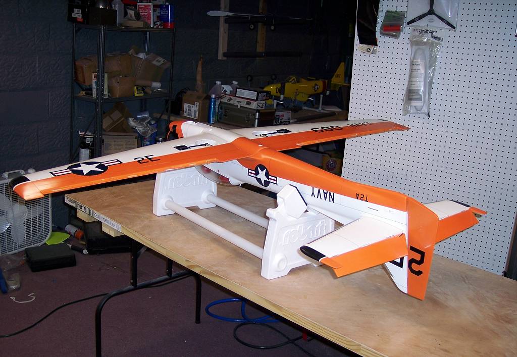

Well the work bench is clean. I just finished up the Miles Reed Fun Fly this morning. I builds just like any Bridi kit. Glue four blocks together and carve an airplane. I have the wing and stab sheeting edged and glued. I laid out the fin/rudder parts and have a few fit issues which are easy fixes. I am not using any CA as it is to hard to plane, carve or sand.

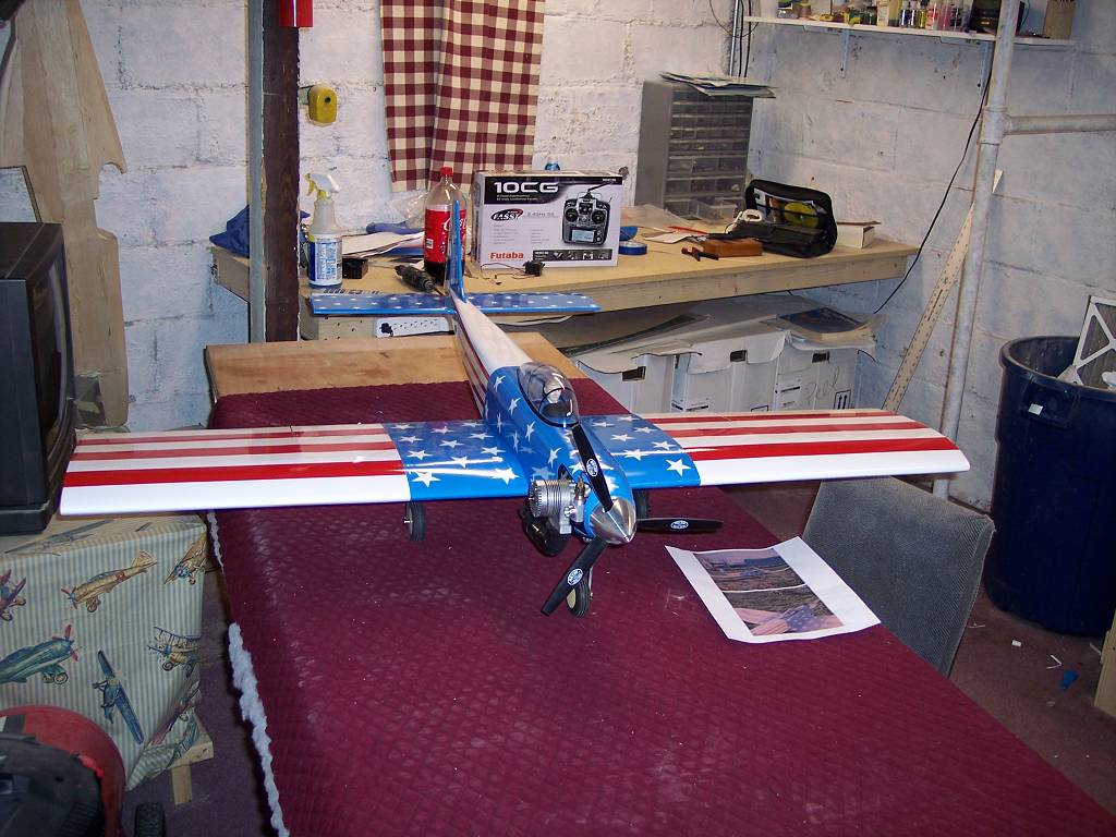

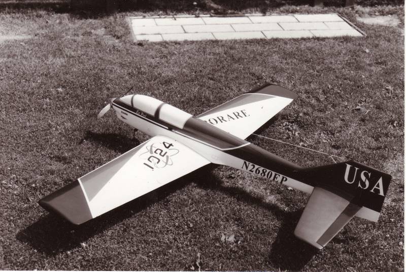

I'm going to try to follow this scheme from my old Tiporare. It is Red, White and Blue of course.

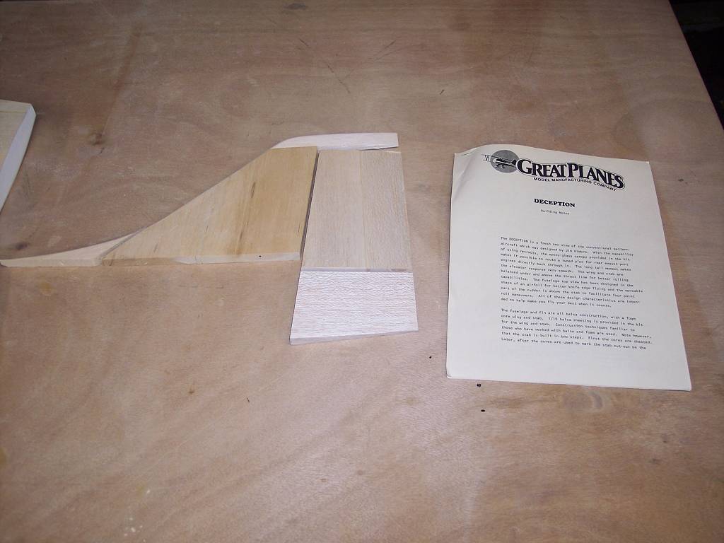

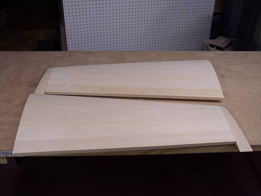

I don't know. Maybe because I started a build thread or said the "E" word. Anyhow, the skins are done and on the cores in the husks for overnight cure. I used 30 minute finishing resin w/ milled fibers. I fixed the gaps on the rudder and fin and are also setting overnight.

Do you do all the retract, aileron servo stuff after applying the skins? Everyone has their unique methods which makes the CPF just great!

Yes, I'll put both aileron servos in the center section and use the torque tubes. I have done this on all my pattern birds. To me it just looks nice and neat. I'll also post on how I do my retract plate install.

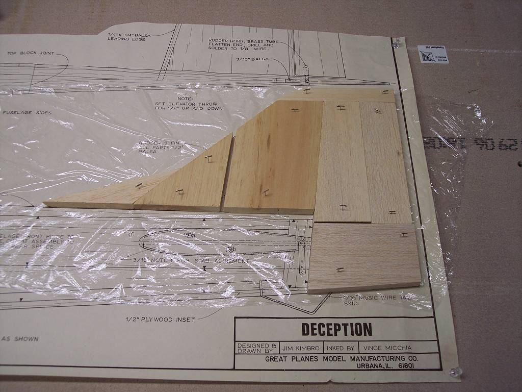

Zoom in on the rudder/fin assy. I added 1/16 to the rudder to bring the front half to even. I add a piece of 1/16 and 3/32 to the fin to fill that gap. Will be shaping it in the morning. Also they are not the same thickness some fat 1/2".
Old 01-14-2010, 08:59 PM

Here is an update. The fin and rudder are shaped and ready for hinging. Not sure if I'm going w/ live hinge, Klett lg. hinges or Robart hinge points. The wings and stab are sheeted, dihedral has been sanded in the wings. I will cap the wing tonight and the stab left as is for now per plan. You use the stab core as a layout for the opening in the fuse.. And yes, I have three workbenches to build on. The two against the walls are attached to the wall and are very firm, flat and straight.

I never did understand Jim's note on the stab for the fuse side cutout. I mean, the stab is symmetric about the root - zero dihedral except for taper on either side. The cutout needs to be slightly smaller than the size of the capped stab but not much. Certainly not the dimensions of the sheeted core without the LE/TE's attached. In any case, there is also the FG cloth to take into account if so desired. I can't recall if Jim suggests something for that joint. I used glass cloth to the fuse sides on the stab and to the fairings on the wing.
I guess a cut is a cut.
Ed, your B&D's must be pneumatic, right? If not, I need to see how you do this.
David.

You glass the center section w/ 3 oz. glass. I will glass the whole stab w/ .6 oz. before it put it in. This way all I have to do is make a fillet. The B&D's are air driven. I'll put in Robart air restrictors to keep them from slapping up and down.

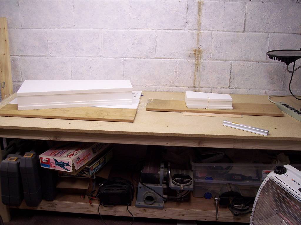

Back to it. Wings are capped and tips glued in place.
Dave, this is how I mount my gear in foam wings. I will cap the plate with 3/32" balsa to keep the gear flush w/ the bottom of the wing. The wing is sheeted with 1/16" balsa. It was actually some pretty light stuff. but the tips and fuse. top block is another story. May have to get out the 40 grit.

nice and classic. I was going to say, just by looking at the wings, you can see that the wood is pretty good. A quick browse of my kit revealed some pretty scary pieces of wood! I'll probably make use of them as lead weights for builds...
Both of my Tipo kits had some rock hard ailerons (3 of 4) also heavy as lead. In one of them, the left aileron weighed twice as much as the right! I plan to drill them out so I used them anyway and at least they should be less warp prone.
At first I thought you had mechanical B&D's and I was really curious to see how you would get those into a skinned wing - still doable but a lot harder. Do you use balsa for the wells or ply? I saw someone use those bendable straws for kids as a conduit for the lines - it was pretty cool actually. Tiny hole entering the well. But I guess running the lines parallel and above the wells might be even more elegant.
Maybe you can make some canoes out of the tips once they are carved to shape. Or drill them out from the bottom - good way to add tip weight when balancing.
