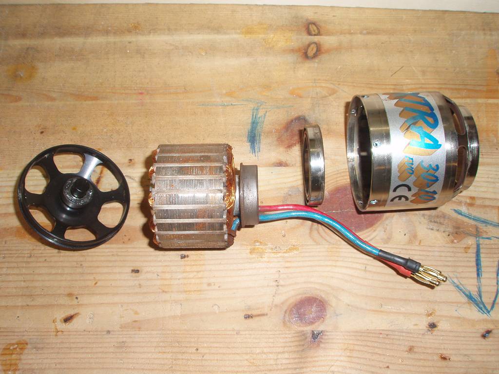

Well, I took apart the Evo30-10, not that hard.
After the weekend the shop is open which sells bearings, so then I can see if I can put it back together again! [sm=surprised.gif]
Volkert

yes, those tiny screws are all it hold together! I did not measure the bearing since what I have is not really reliable to measure.
The bearing reads on the side Japan, SMT, 6806Z
Volkert

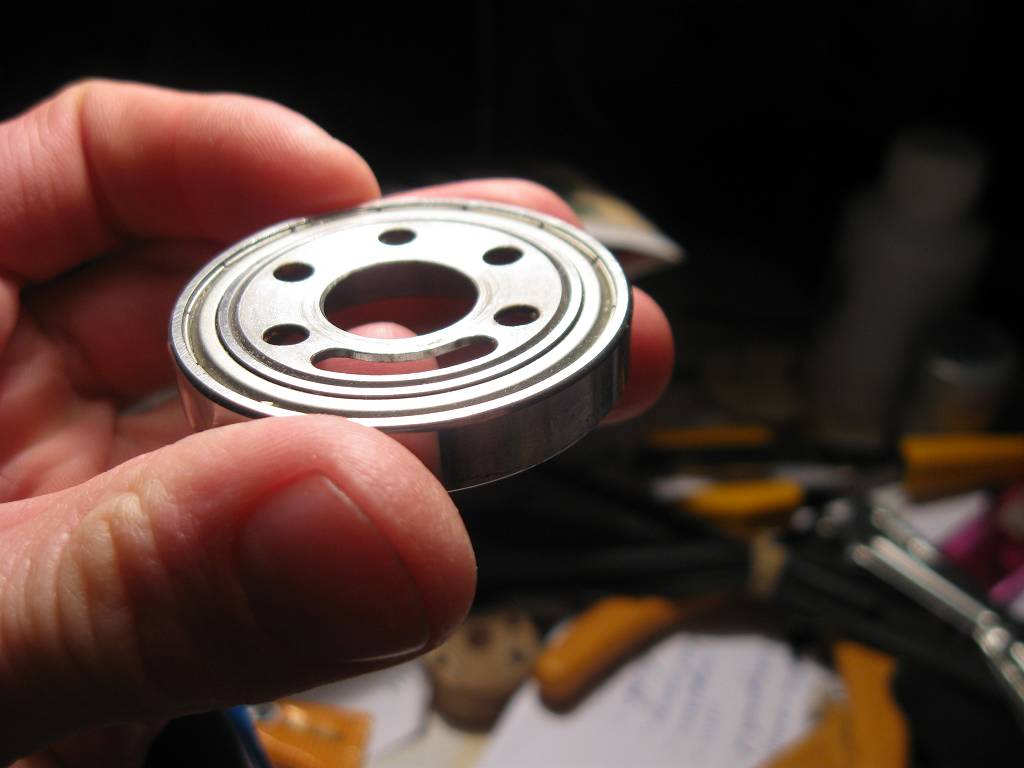

after dismantling the motor and the rotor out (which comes out easily) the inner edge of the bearing is visible from the backside. I just hammered it out, just soft taps going round the bearing. It comes then out pretty easily. Now I have cleaned the seat (of where the bearing sat) with some scotch brite and it should go back in OK again.
Tomorrow I should have the new bearing if it is available and then we will know
Volkert

So this morning bought the bearing. Good news is it was on stock, however a good quality bearing is expensive, 42€ I paid. We will see long run if, and how much better it is then the stock bearing (SMT).
The bearing is AKN 61806-2Z
As mentioned above I cleaned the seating of the bearing well. In principle I slowly bit by bit put the bearing in place in the housing, which is a tight fit but no problem. Did not need any tools. Then the rotor in place and then build up the motor again.
So no problem at all getting the bearing in; all in all a 5 minute job. The little screws which hold the can I used a bit of locktite to ensure they stay in place.
Motor is running very smooth now!
I read on the Hacker C50 thread a recommendation to replace the bearings after 300 flights. Maybe that is not such a bad advice as well on the Plettenberg if you want to ensure the motor always runs perfect. With hindsight I am sure at least the last 50-100 flights the bearing was not 100% anymore.
So conclusion: bearing change on a Plettenberg EVO30-10 is in total a 10 minute job and not difficult to do. Cost is quite high, maybe there are cheaper alternatives, but what about the quality?

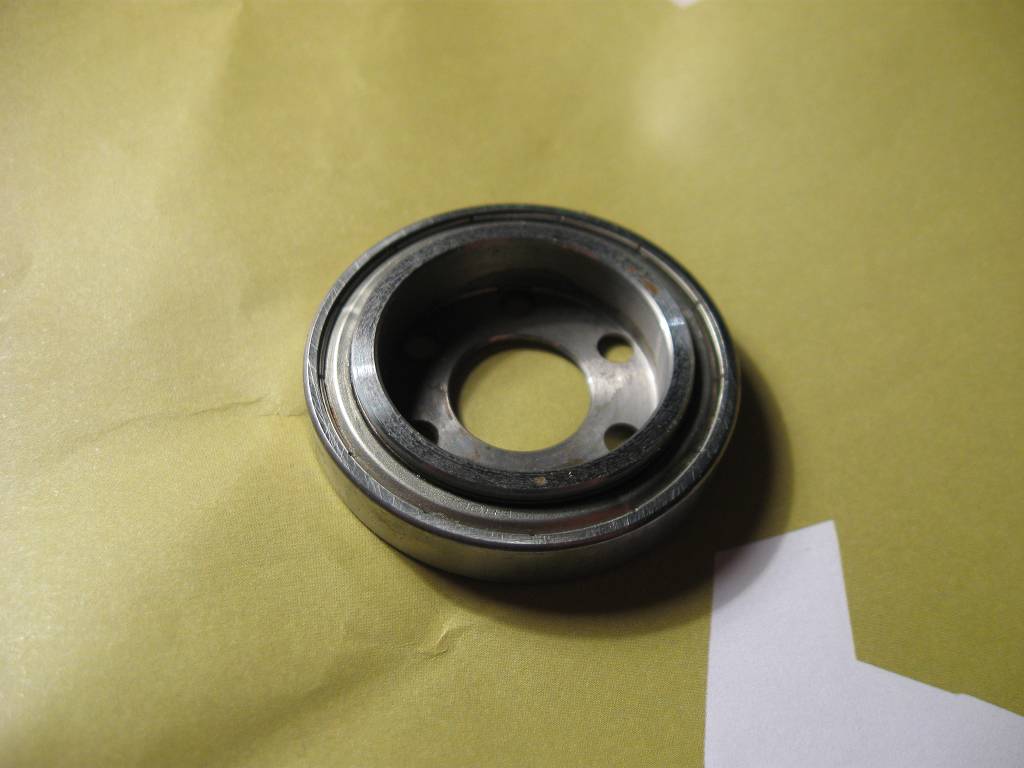

Hello!
I've got a rewound Plettenberg Xtra 30-9 EVO II and I'd like to replace the bearings. I bought new ones and the smaller, front one, came out easily, but the rear larger bearing seems to be pressed very tightly around the metal ring. I tried to get it out with my vice and some wooden blocks but the ring got bent. It is now fixed, but the bearing is still there. I heard that heating the ring with a torch would make it easier to knock the bearing out. Another option is to buy a new ring and press the new bearing in.
My other question is a bit off-topic. Has anybody tested the motor with no prop? I rewound mine and seems to be getting warmer near the old, rear bearing, which seems to be worn out. Here is my thread on RCgroups.. In post #41 I've described the problem in details.
Could anyone give me an advice?

No, not in the rotor (bell). Using heat there would destroy the magnets (I think they are rated ~80 degrees Celcius).
Please refer to the picture below. The bearing is very tight around the part with the holes (which I call "ring", maybe inaccurately).
Thanks!

Here are a few more images of the ring and bearing joined together. On one of them, the red elipse shows the boundary between the two.
The inner diameter of the bearing is 30 mm. In post #8, you could see Volkert's picture, which shows the shape of the ring. It is 30 mm in diameter where the bearing should be sitting. Then widens to around 32 mm (if I remember correctly) to prevent the bearing from moving towards the stator teeth.
As mentioned, I tried to separate the ring and bearing with a couple of round wooden blocks in my vice. This resulted only in a bent ring which I fixed afterwards and so far seems to be fine, but the bearing is still there.
