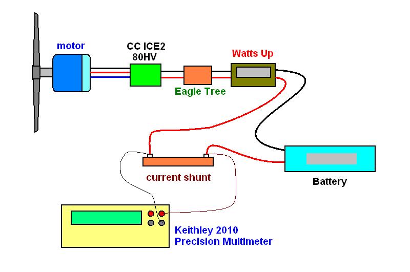

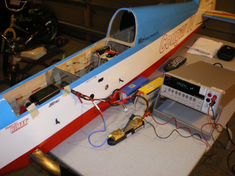

Just got my new CC ICE2 80HV. I love its data logger function, but the current reading seems higher than my Eagle Tree data logger. Since my job relates to a lot of tool calibrations, so I like to share how I calibrate these current readings.
Figure 1 shows the setup. ICE2 80HV, Eagle Tree and Watts Up are series together, so the current is the same.

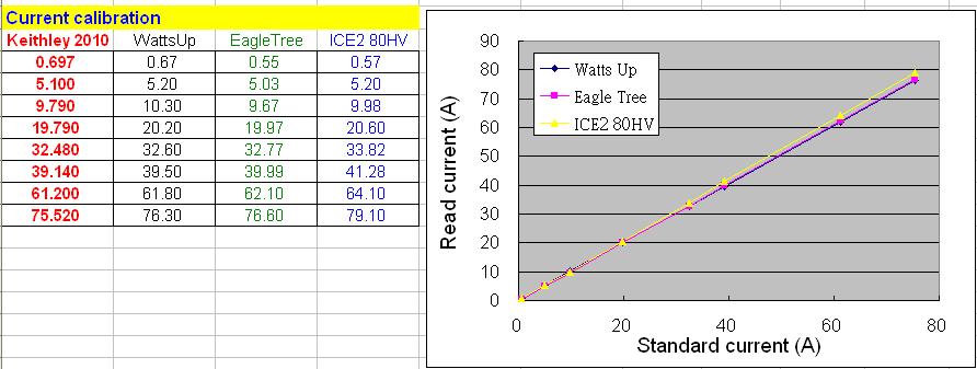

Current standard is read from a calibrated current shunt (1mV=1Amp), voltage across this current shunt is picked up by a calibrated Keithley 2010 precision multimeter. Each measurement is repeat twice in opposite polarity to eliminate the thermal noise. Table shows the results: just as I suspected, the current reading from CC ICE2 80HV data logger is off by ~4.5% at high current (>30A) range, while Eagle Tree and Watts Up are off less than 1.4%.
Well, the calibration will NOT improve anything, just curious how accurate those numbers are.![Big Grin](https://www.rcuniverse.com/forum/images/smilies/biggrin.gif)

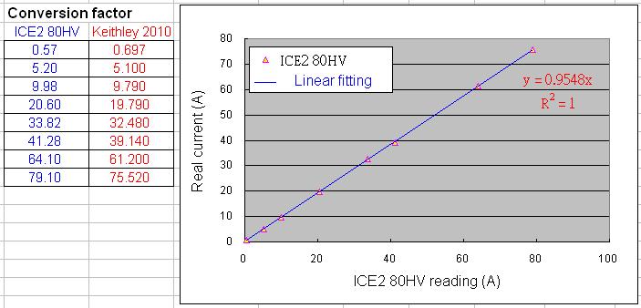

Conversion factor:
This is a parameter to let me convert my ICE2 80HV current reading to the real current.
Plot the standard current vs. ICE2 80HV current reading using Excel, then add trend line and show the fitting equation. For this ESC, the conversion formula is: Real current (A) = 0.9548 x ICE2 reading

Voltage conversion factor:
Watts Up: 1.0007xWattsUp reading (V)
EagleTree: 1.0054xEagleTree reading (V)
ICE2 80HV: 1.0061xICE2 reading (V)
Not surprise..... WatssUp is closer to the battery, and ICE2 is at the far end; the reading is lower than the voltage at battery side.
I believe (not try yet), if I series them (to the battery) one each time to minimize the cable length and # of contactors, the voltage reading should be the same
Luke
