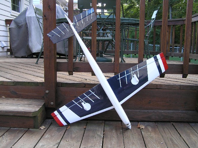

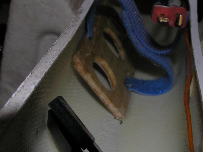

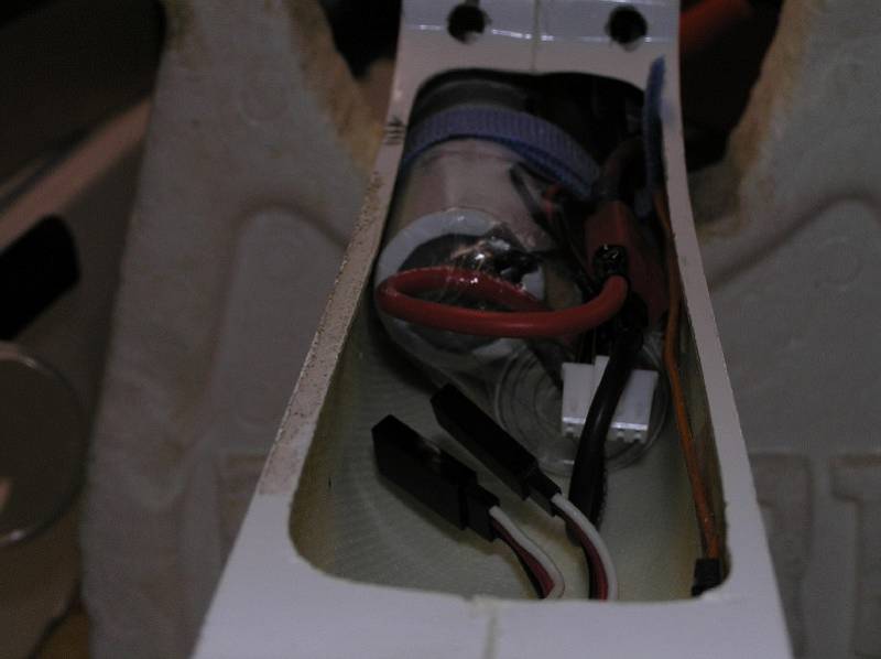

I got no love on another website, so I thought I'd add my experiences with the A123 cells. A few years ago, I bought an ARC JR Rumfal from Esprit Model. At the time there was not many 8-10 cell/3s pattern-type plane and this was the only one there was. It stayed in my basement for about a year and then I began to assemble it. I cant tell you what a pain in the [:@] it was to modify and fix defects to the fuse ( nose ring installed crooked, wing chord longer than opening in hatch/canopy, etc.), but it finally took to the air two weekends ago. I can get 8minutes of mixed throttle, if I'm careful and 6-7 minutes of more agressive flying. At 23 oz. per foot, it doesn't float, but niether does it violently tipstall. I also found out I have an incidence issue, but I ordered a Hnagar 9 incidence meter and will fix it.
I have followed Dick Hansen's and Turbine 50's posts and thought I would contribute.
Specs:
42.5 oz (down from original 49 oz. with 17 oz. 8 3600NiMH & 6oz. motor- never flew with this arrangement.)
4S A123 in stick configuration
Hyperion 3019 1070kv outrunner
MGM TMM 4016 controller w/ BEC (bought before lipos existed)
2 Dymond D90's in the wing
2 Hitec HS 85's in the fuse
FMA extreme 5 receiver.
about 420 watts at 36 amps with full pack.
I had someone else hand lauch and with full power it went straight up after launch. So far it has 7 flights and I need to fix a wing incidence issue (too much positive). Still sorting it out, but the real challange was fitting A123's in to a sub-c wide fuse. The pics below show how I did it.
