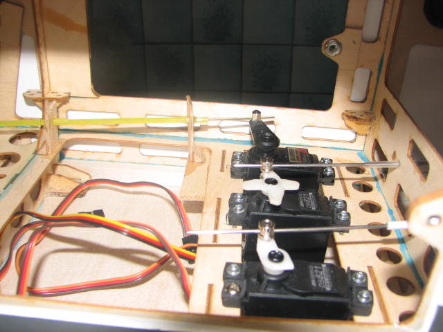

The Beaver was ordered from HobbyKing. I received it in top condition. Everything was well packaged and I was surprised at the quality of the plane. It is a balsa built and covered with shrink plastic.
I am thinking of using an OS 32SX engine with a Pitt's style muffler.
The work involves removing the already built electric engine mount and replace it with a suitable mount for glow.
Of course a pushrod and an extra servo will have to be added for the engine as also a fuel tank.

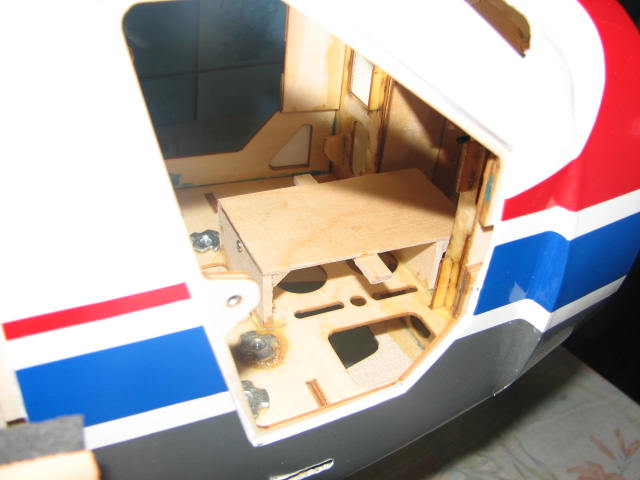

The front of the firewall needs to be flush with the front of the fuselage. Since I will be using 1/4 inch plywood to build it, I cut the original firewall 1/4 of an inch inside the front of the fuselage.
To keep the new firewall in place, I glued inside the remaining firewall four pieces of 1/8 inch plywood. Tabs were cut on these pieces to hold the firewall in place.
Triangle stock was used to reinforce the whole structure.

Here is a picture of the firewall installed.
I made sure I gave it about 3 degrres of downthrust and close to two degrees of right thrust.
Twin Flyer, yes 1/4 inch plywood might be overkill bit it is my first conversion. Is there a rule of thumb when choosing plywood thickness vs engine displacement ?
My calculations tell me I might need some extra weight in the front because of the short nose moment of this plane. If this turns out to be the case then the extra weight of the plywood will pay off.

The open space was closed off using 1/16 plywood.
I used high temperature gasket material to seal the joint betwwen the firewall and the rest of the enclosure.
Because this enclosure covers the cowling supports, I made sure I drilled holes in the enclosure to access the T-nuts installed by the manufacturer.

Judgeing from past experience 3 degrees of down and 2 degrees of right sounds like way too much. Every conversion I have done to date needs some thrust taken out compared to what the electric setup had built in (and I use engines on the larger size for the plane). I would rather start either flush or with 1 and 1 and add washers as needed.

ckreef,
Thank you for your input.
What you say does make sense. When the throttle is activated, an electric motor develops it's torque more rapidly than a glow motor.
I will need to try the airplane and, if need be, I will reduce the thrust incidence.

Since glow fuel is used, I need to install a support for the fuel tank at the right height.
This picture shows my work.
