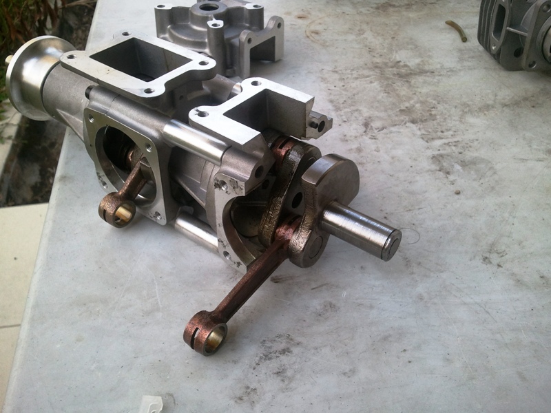

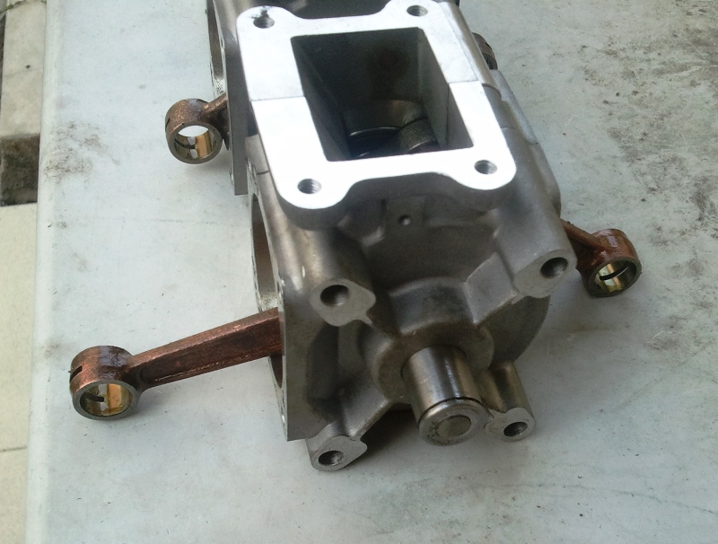

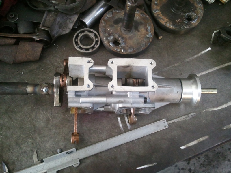

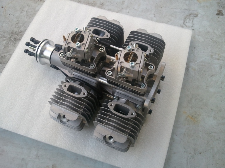

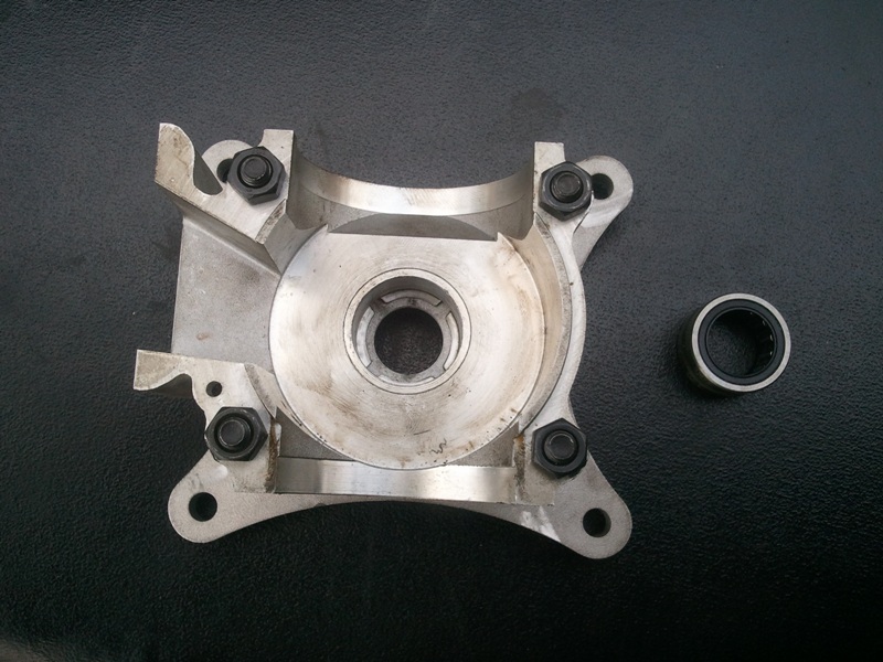

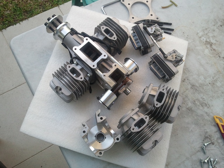

I received an order by fellow RC flier on DLE222 to have an auto start system. No, i have not built it yet. Based on my previous post on DLE111 auto start system, the feedback i received are quite encouraging therefore in this thread i will share the approach that i do to built this system. I do hope also many will subscribe to this thread.
For a start, we inspect this engine. Quadruple engine which is having alternate combustion between front and rear twin of 111cc.

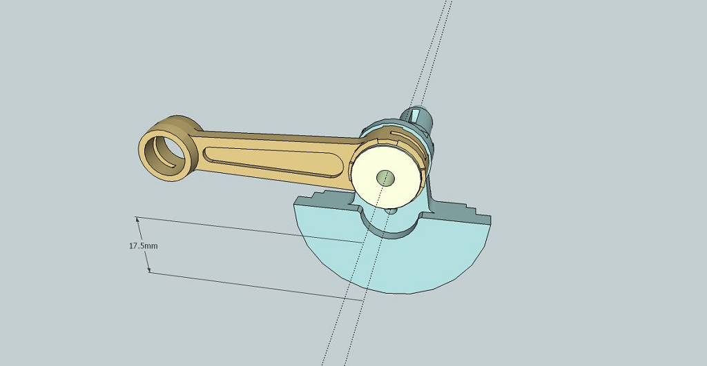

Before we go further, we need to consider the fundamentals.
LOADING
Engine negative torque calculations
P1V1 = P2V2,
Where per 55cc cylinder,
P1 = ambient pressure = 101325N/m^2
V1 = 45288.8 mm^3 - calculated volume enclosed after the top of the piston passed the exhaust port.
V2 = 7525.8 mm^3
Resulting in P2 = P1V1/V2 = 607950N/m^2
Nett pressure acting on combustion face of the piston = P2 – Ambient pressure P1 = 607950-101325 = 506625N/m^2
Piston Area, A = (pie)r^2 where r = 0.0225meter, therefore A = 0.00159m^2
Force on the piston = Nett Pressure x Area = 506625 x 0.00159 = 805.5N
Torque = Force x Distant, where distant is between the centroid of piston rod pin (on the crankshaft) to crankshaft center, in this case it is 17.5mm or 0.0175m.
T = 805.5N x 0.0175m = 14.1Nm
The value above is based only on one cylinder of 55cc jug.

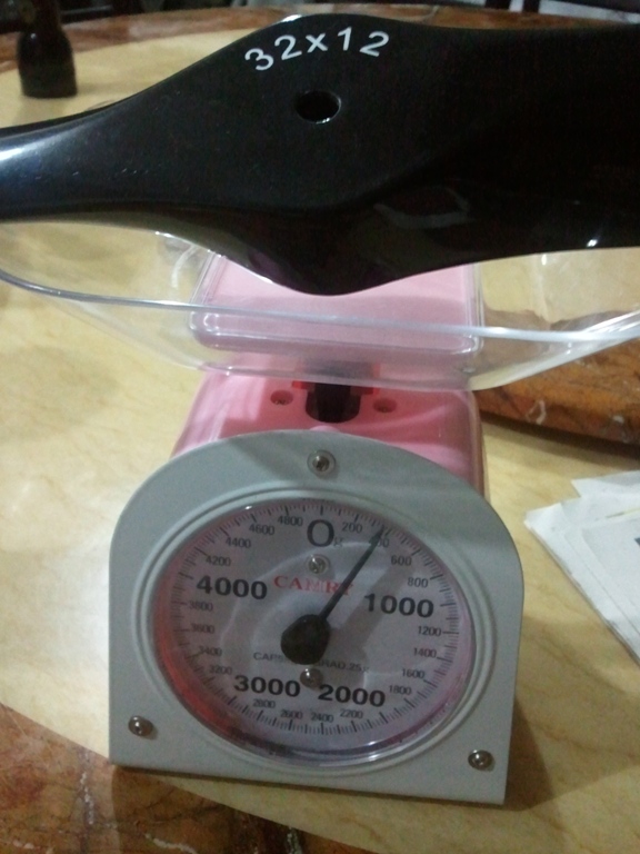

Propeller Inertia Forces
For initial starting rotation, the rpm involved is small compared to running rpm. Even though there are other forces acting like the aerodynamic drag on the blade surfaces but it will not be considered due to too small when compared to the INERTIA forces to turn the prop itself.
The common propeller size for 222cc engine is 32 x 12. The mass of this propeller is 350gram or 0.35kg. For ease of calculation, we consider each blade leaf is 0.175kg and act at the central point between the engine shafts to blade tip i.e. at 8 inches away from engine center.
Per propeller leaf,
F = ma, 0.175kg x 9.81m/s^2 = 1.72N
Negative inertia torque = 1.72N x 0.2032m (8 inches) = 0.35Nm
Therefore for the whole propeller, 0.35Nm x 2 (2 leaf prop) = 0.7Nm

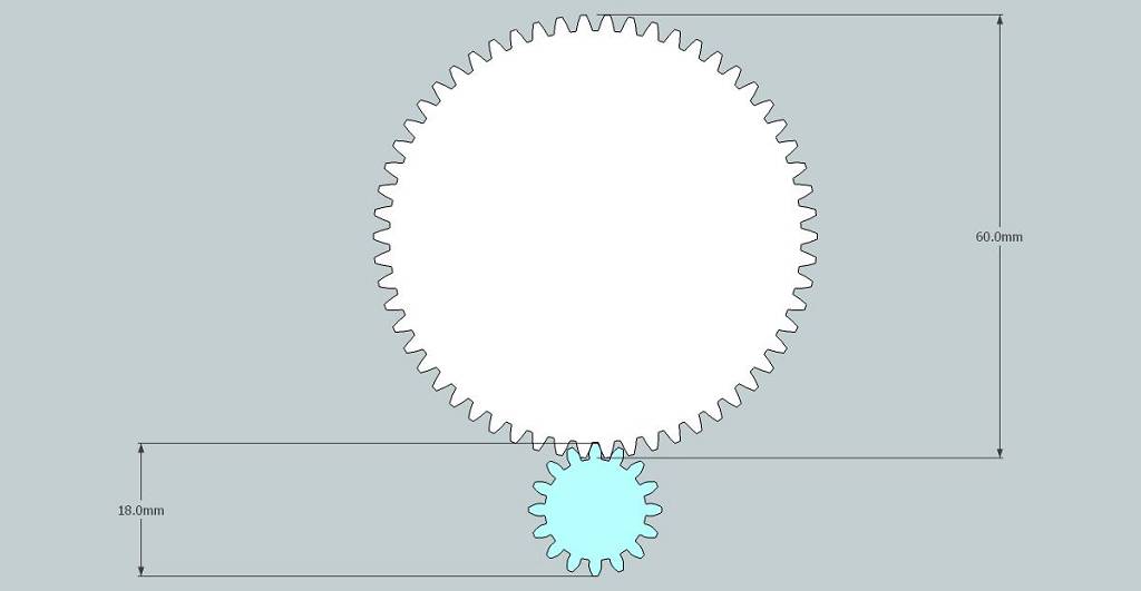

Basic Sizing
Based on the DLE222 engine mount plate, we know already that we can only play around with gears that have a diameter of between 60 to 70mm. Larger than this it will interfere with engine stand offs. Yes we can always design a larger plate to accommodate a larger diameter gear, but it’ll be a non standard mounting pattern of the engine. This proves to be a problem for some who have already mount the engine to the firewall.
Gear productions vary with different standards, but the most important thing is to have its teeth cut to an involutes shape. One can search out what the term involutes is, but put it simply; the involutes profile of each individual teeth will not cause any point on the surface of two meshing teeth slides with each other. In another words, a point A on a tooth surface will always meet a point A on a meshing tooth, it will not meet at any other points. This concept will prevent pre-mature wear of gear teeth due to sliding action between two surfaces.
Now we have calculated that we need a ratio of 32 to 45 times of step down. Let us assumed at this moment we are going to make only one stage step down ratio of 38 (average of the 32 to 45 ratios). Say the final input gear is 60mm, then the pinion that drives this gear should be, 60/38 = 1.58mm. Will it be possible? No way… Typically a 1000W rated motor shaft alone will be 5mm diameter.
Looking at this we have to design several stages of step down. Let us assumed a 2 stage step down, then per stage of step down ratio will be square root of 38 = 6.16. If the final gear is at 60mm diameter, then the pinion will be 60/6.16 = 9.7mm. Not to say not possible, but is it too small? Then let us add one more stage, then per stage step down will be 38^1/3 = 3.36. At this ratio, if the final drive gear is 60mm, then the pinion is 17.9mm. This is more like it!
Now we know for a good sizing, at least we require 3 step down stages. How much this exact individual ratio will be, will have to depend on how we can arrange the stages so as not to interfere with each other but as guideline, we know it should be around 3.4.
Okay we continue....
Basic Sizing

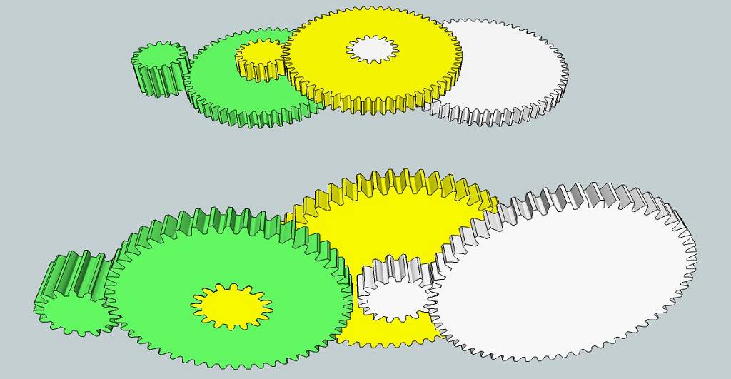

From above posting, i attached the graphical view of a 3 stage step down gears.
In the 3D diagram, each stage is colored differently. Please note if we stack the gear like in the picture, we can't have the same size gears all the way. The reason for this is, if the driven gears are of the same size, then it'll interfere with next stage pinion. And that is the main reason why in previous posting i mentioned that the final ratio depends on how we arrange those gear sizing.
In this example, the 'green stage' is having a ratio of 2.88. The yellow stage is 3.33 and the white stage is 3.33 also. Therefore the whole step down ratio is 2.88 x 3.33 x 3.33 = 31.9. Close but slightly below of what we wanted. Need to work on it further.

Structure consideration
The part that needs consideration is the final gear and the final gear pinion shaft. If we choose steel gears, automatically we are bounded by this material shear strength i.e. at around 186MPa (Mega Pascal or 10^6 N/m^2) where this value will be compared with designed dimension loading.
Without dwelling into in-depth analysis, we only consider the base area of the gear teeth. For additional info many good literature out there provide various approaches towards predicting load capacity for a given gear and it involved rather complex mathematics which I try to avoid here in RC world (we are definitely not designing things for human occupancy, if one do so please look at what being presented here as the most basic foundation only). But whatever it is we still can’t run away from high school maths…
Okay, if we designed the final gear diameter to be 60mm then the radius is 30mm or 0.03 meter. We already calculated that in order to successfully turn the engine per compression stroke (at 180 degrees), a torque of 57.8Nm is required. What does it mean? It means that at 1 meter length we apply 57.8N of force. Now to balance it out, at 0.03meter, we should apply how much? The answer is a whopping 1926.67N!
Now if we designed the gear tooth width to be 2mm or 0.002m and thickness to be 3mm or 0.003m, then we have an area of 6 x 10^-6 meter square. Now if we take the applied load 1926.67N and divide this against the area, we’ll have roughly 321MPa of shearing stress on the gear tooth. The limit as we know it to be only 186MPa. For a gear teeth this size, the loading imposed will definitely shear off our gears….
This is where the problem is, we have to juggle those numbers in meeting at least not more than half of the strength limit i.e. 186/2 = 93MPa (half here is meant for safety factor of 2) but roughly from first calculation we already know that we are off target by a third. Now if we increase some of the parameters say by 60%, sooner or later we’ll arrived at a good solution.
I leave that for forumers to come out with solution.
Join Date: Oct 2005
Location: PerthWA, AUSTRALIA
Posts: 2,924
RE: DLE222 Starter System - The Project
Hi Umran
Great work mate.
Looking over the numbers you are coming up against, You may want to consider a Planetary reduction instead.
It will likely be more compact for the required ratio and the loads are shared across more than one tooth set hence the ability to use a smaller tooth.
Great work mate.

Just curious, where are the efficiency numbers for your motor and gear reduction? It looks like you included them in your constants. I would think that you want to separate them for comparison purposes.
Join Date: Apr 2006
Location: Putra NilaiN. Sembilan, MALAYSIA
Posts: 105
Steve,

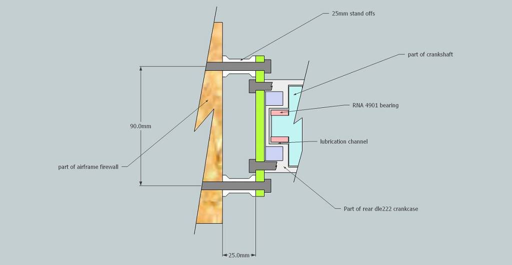

The original engine clearance between firewall to crankcase is about 30mm. If we want to do some modification to the aircraft firewall such as to open it up to accommodate the starter motor, perhaps planetary gearbox system as suggested by you will be a better choice.
But in this case, i don't think so the owner of the airplane wanted to do that mod, therefore have to work within those confined spaces, in fact to extend those stand offs will definitely makes the engine jutting out at the frontal cowl and off course this will effect the CG also. Refer attachment for available space.

Just a bit more on gear meshing....
For anyone who is interested, the determination of the actual distant between pinion and driven gear is the pitch radius of pinion gear + pitch radius of the driven gear, not anything else. For example, a 60mm diameter gear may have it's pitch radius at 29mm, while the pinion gear of 18mm diameter may have it's pitch radius at 8mm. Therefore for this set of meshing we would have 29 + 8 = 37mm of distant center to center. The precision of this distant however lies 100% on gear cutting quality.
This pitch radius also determine the gear teeth size. The closer the pitch radius to the actual gear radius, the smaller the teeth. The smaller the teeth, the more number of teeth will be there for the same diameter gear, and off course less load carrying capability. However the smaller the teeth, the smoother the meshing is, less friction, less noise... better efficiency and everything else.
This is where a designer have to consider a lot more things before deciding on a specific gear tooth size.

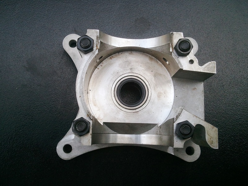

Okay too much theory also not very good... let us see something practical today...
From post #2, i did mentioned that rear drive system is the way to go therefore some engine modification required.
Many first generation castings on DLE111cc rear crankcase is having the slot for RNA4901 needle roller bearing. This particular bearing is suitable for the application since it has a very high axial load capability. With installation of this bearing DLE also created 4 lubrication slots surrounding it's casing (these slots can be viewed in the first picture). Since we want to extend the crankshaft for the starter drive system therefore some work need to be done on this area.
First step is to remove the bearing. Then using lathe machine, we re-bore just enough to remove the lubrication channel. While the unit still on the lathe machine, we drill a center hole (16.2mm) on the crankcase. Machine an aluminum bush similar to the size that has been removed via maching, press fit this bushing. Then we do some shopping.... hehehehe... we get ourselves the RNA4901.2RS bearing. This bearing is having same loading capability but with something extra, it has lip seals at both ends. This will prevent crankcase leak. And due to this seal also, the bearing typically will be having some pre-packed grease on it's rollers therefore no further lubrication required. Press fit this bearing onto the bushing.
Refer sequence of pictures below.

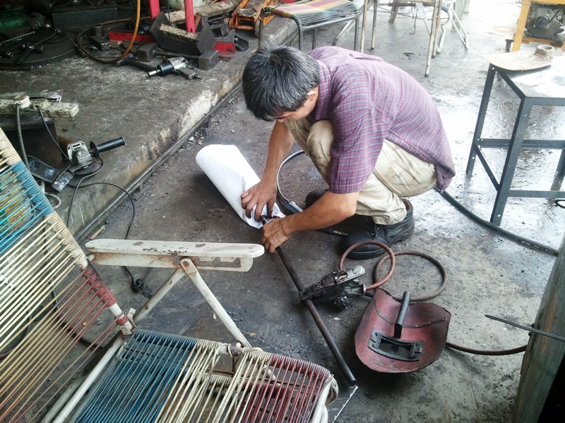

Now on the crankshaft itself,
Find a suitable steel (something like 18 or 20mm diameter), machined one end of it a bit to make 8mm extrusions. This extrusion will use to align the rod to the crankshaft. Press it in (be careful here always put something between the flywheels if not you may bend the crankshaft).
Using TIG (Tungsten Inert Gas) welding, weld it's circumferential join. A bit extra here and there no problem. Put the whole assy to lathe machine. Lathe it out to 16mm diameter exactly.
Refer photos below.
Refer photos below.

And finally, if all alignment is great, you'll end up with this photo below. Nice shaft jutting out at the rear...
