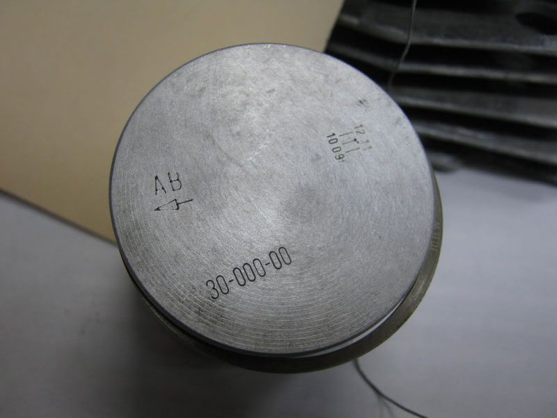

A customer told me today he heard that the A stamped on top of a Sachs piston means top of the line, a D on top means industrial grade...What a CROCK...Maybe we should start a thread with all these internet MYTHS listed for newbies..We ALL know the old timers don't perpetuate these things, don't we ? ![EEK!](https://www.rcuniverse.com/forum/images/smilies/eek.gif)

AB means that it can be used in both A and B size cylinders...The differences are in the tenths of thousandths, only shows the attention to detail the chainsaw manufacturers go to....A D piston will fit in an A cylinder, but won't run for long....An A piston in a D cylinder is borderline loose....

OK RC, while talking about engine bores .... do quality cylinders have any bore taper? I have to say I've never measured this on any 2 stroke gasser I ever worked on though I do check ring end gap from top to bottom of stroke. I know some full scale aircraft cylinders have a bit of taper to allow for the top of the cylinder running at a higher temperature than the bottom .... theory being that when up to temperature the bore would be straight. Just curious.
Generally on our RC sized Gas engines there will be no engineered taper. The cylinders are too small and the power outputs are too low to require it. Even on the best quality engines, the amount of taper would be very small even if it was intentionally added.
So the bores should not only be parallel but they should also be round. Very few (by numbers sold) actually are
This is because the majority of the engines that are bought nowadays have a very basic manufacturing technique used. Teh cylinders are molded on a mandrel, chemically cleaned, flame plated with Chrome then the final surface finish is achieved with a basic hone unit.
That technique results in bores that are neither parallel nor round. They are however cheap to produce that way and they will allow the engine to run. What they do not allow is good ring sealing so power is lost.
Roundness is difficult to measure due to the open port designs commonly used (another source of power loss).

What I fail to see explained here, Ralph scratched the surface of it, is the system behind the A,B,C.... markings.
To continue from where Aussiesteve left off:
Once in production, after all those many operations, the operator is satisfied with roundness and taper he stops working on the bore. The next station is a hydraulic measuring device that defines the true mean dimension of the bore at height specified in specs. Dependine on that dimension, the cylinder is marked.
Same with piston dimensions. rather than working to the EXACT dimension, which is nearly impossible regarding tool wear and operator intervention, the piston when done is measured. According to measurement it is "classed" to match the class of the cylinder sizes.
There you have it in a nutshell. Minimal production costs, and accuracy that competes with multiple cost production systems.
BTW,
MVVS, my favorite manufacurer, does not use this system. Any Cylinder will fit ANY piston in their gas engines (costly, costly). They have to learn a bit still.

Some numbers from an older Sachs set of pistons, dimensions are in MM
A= XX.919-XX.923
AB= XX.923-XX.933
B= XX.933-XX.937
So for being "just" an dumb ole chainsaw they were petty fussy when they built them.

I didn't have a need to mention the final measurement / acceptance because I was referring to how the majority (by numbers sold) of RC engines are made (In china mostly). - there they set up for an approximate size, then use pretty much everythign that comes off the line.
A REAL cylinder is made slightly differently.
Casting
Rough Machining
Finish Machining (with a different cutting tool to what was used in the Rough Machining)
Inspection for acceptance / rejection
Plating / Coating (Either Electro-plating of multiple metallic layers with a Chrome alloy as the final run - or with a Silicon Alloying coating such as Nikasil)
Final Grinding to size
Finish Honing with fixed hone tooling
Final measurement
Acceptance or rejection
Grading.
Pe - the beauty of such manufacturers as MVVS is that the product is consistently great from one engine to the next - it took me a while to really "get" that but once it is experienced, it sure is a nice thing.
