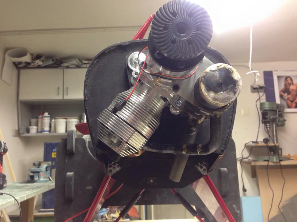

Meanwhile i will Show you some Installation photos. think most of them i builded :-)

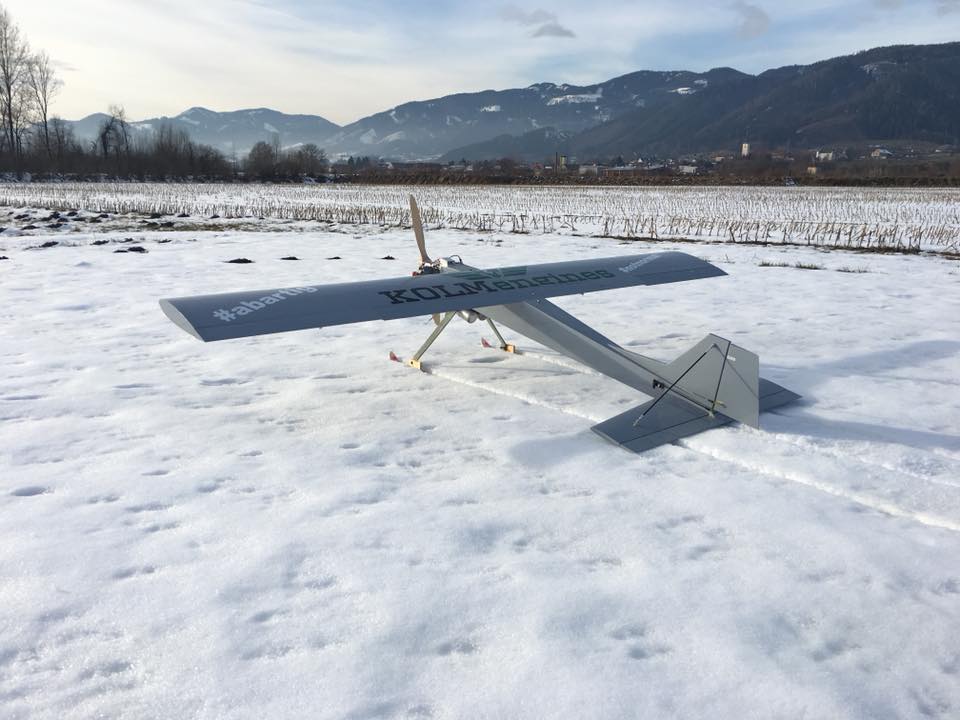

Good Morning:-)
had some testflights with the new BX250 yesterday. small video will follow!

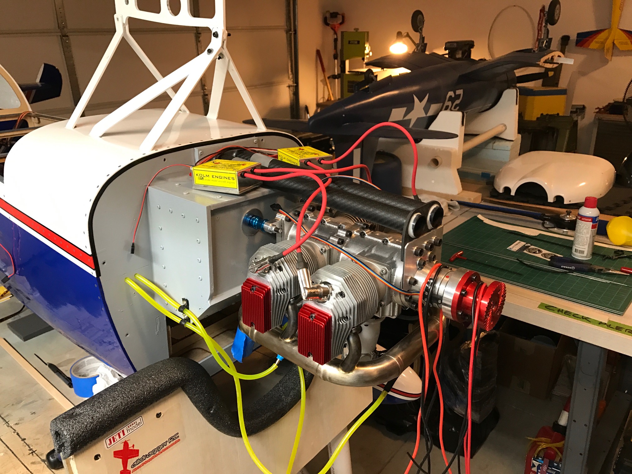

Good morning!
i finished the engine installation on Voodoo... some small things to do before rll-out:

Looks great Tom. I am looking forward to seeing the video of the Voodoo flying. I was curious, in the picture is that small bottle in front of the cowl by the support bracket tied to the engine vent to capture oil residue?
Rob

Correct. Collects the outcoming oil from the crankcase.

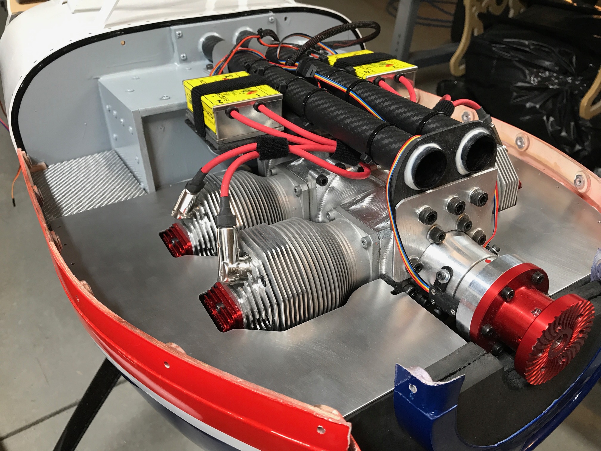

Posts: 40
Default Hempel 50% Pitts Kolm BX240
Tom Voodoo looks amazing. I also can't wait to see the maiden flight.Here are some Photos of my BX240 installation in the Hempel Pitts which you maidened for me. I have made some small modifications to the install and will add the photos.Some of the photos are oriented the wrong way. No matter what I tried I could not make them straight.

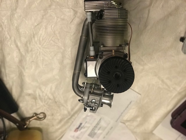

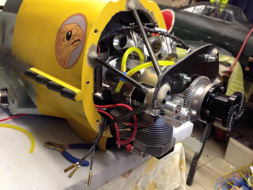

Hello Tom,
Carb mod's are complete, ready for the test stand.
Thank you

Looks good ! Will work for sure. Same setup a I had on my bf109. Take care that the carbs are 💯 % synchronized. please keep us up to date !

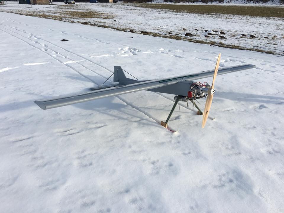

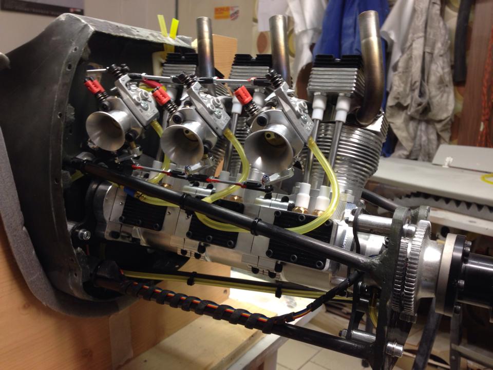

Voodoo I coming up better and better.
Installed the 4blade prop these days.

awesome!
you will get much more RPM in flight. mine is 4900 on ground. going up to 6000+ in flight. can´t wait to see a video!!
