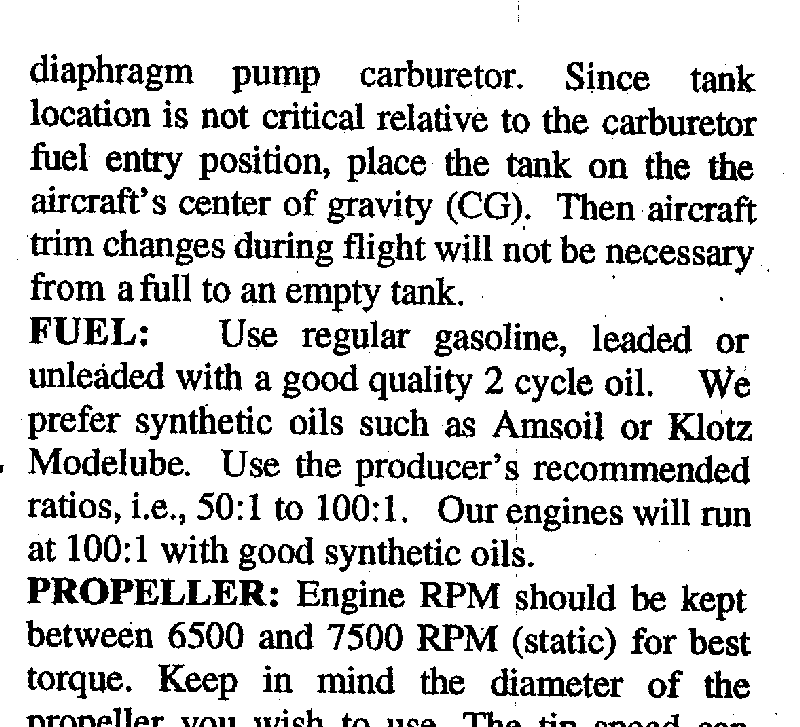

From the Brison manual I just dug out of a box with a mechanical advance 3.2 in it;
Good discussion on oils.

So now a person can ask themself, Do I want to run an oil thats only good enough to run at 50 to 1 or an oil thats good enough to run at 100 to 1. Remember you can always add a little oil to the 100 to 1 mix but you can't dilute the 50 to 1.
At first there was only one or two manufacturers of synth. oil. For new companies to break into the Synth. market they have to do one of two things. Make an oil that is superior or make an oil that is cheaper. Don't know for sure but I'd tend to suspect the oils specing a lower ratio are either of less quality or already diluted (They buy from a manufacturer and dilute the product to obtain a profit). Thus I'll stick to my (in my mind) superior product. Having no idea and no real way of knowing what oil is ideal for how I tune my engines other than it's working for me, it's the near most expensive $78/gal, and it's the only one I've seen with the + at in it's Jasco rating.

Alta, equating a lower mix ratio oil to lesser quality is a pretty weak argument. There's a lot more that goes into the quality of oil than just the mix ratio. Stick with what your mind tells you - the facts say otherwise but as long as you are happy then good enough.
pe reviers, I just received my second DA last week, and sure enough the instruction manual still includes Amsoil 100:1 in the list of recommended oils.

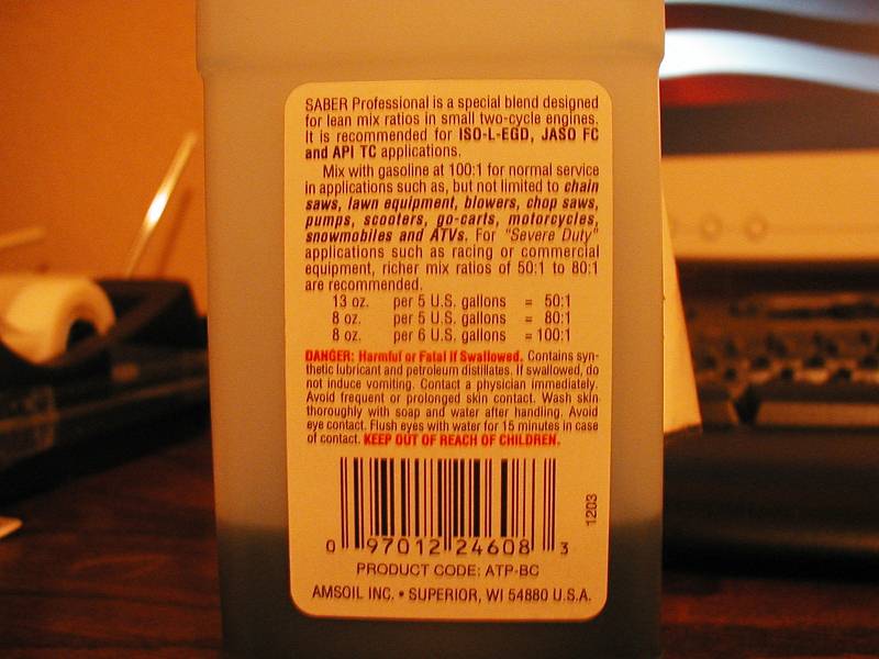

I should have said diluted by half to make 50 to 1. This intelectual stuff twists the noggin. And SS you can't tell me yours aint twisted. No one in their right mind would work where you do

That's great RTK. Amsoil Sabre is designed for 100:1 but can be run richer. What does Amsoil 2000, MobileMX2T, Bel-Ray H1-R, and Red-line say?

I have the same bottle Bass. Mix it however you need. Following engine manufacturers guidelines would be a place to start. With experience adjust from there.
RTK An airplane engine is alway operating at 100% of throttle setting. That is imo severe duty. With their labeling Amsoil should be mixed at 50 to 1.
