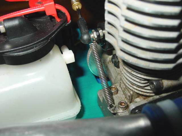

need help with return spring

do i put a return spring on the servo arm or the carbie thoat shaft
won,t the servo be working over time pulling on the spring as well

It depends on what car you have.
Just make sure that it has enough pull to bring the servo arm and throttle arm back to the closed position.
Also get a voltage checker to check the voltage of your batteries before you run.
Here is my RC10GT with Spring.

Yes the servo has to work harder to against the spring and some lighter servos may have a hard time doing it.

Let me ask you this... Would you rather have a little strain on the servo so the life is cut down a tad or, would you rather run the risk of having a runaway causing an unknown amount of damage to your vehicle and/ or someone else's and possibly blowing up your engine?

Man, pushing the throttle around requires like no work!!
If your worried about the throttle servo, think about what the steering servo has to put up with!
And I've witnessed what a runaway car can do to itself first hand (not my car tho..lol) Its NOT pretty!

Well.. I screwed down the spring holder eyelet with one of the existing screwes, and I attached the spring to it.
I dont think placement of the spring is such a big deal as long as you follow these "rules"
!) Find a good spot where it has good tension, but isnt stretched so bad that it pops off
2) Make sure it DOESNT TOUCH or RUB ON ANYTHING!
This CAN cause radio noise
3) Dont attach it to something that moves (the other side..)
4) Mine hits the brakes a little if the servo battery dies.. yes the servo has to fight this.. but its soo mild it shouldnt matter!
