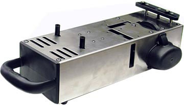

this is mine.
i have a mugen jp black 12,it does not like to turn it over very good,should i look into getting another one,a better one.
![](http://www.ofna.com/images/start-4.jpg)

![](http://www.ofna.com/images/start-3.jpg)
PART NUMBER: 10255- w/Power Panel
PART NUMBER: 10258
Used For: 1/10 On Road, 1/8 On Road
This is the box I was referring to. It only has 1 motor. It has the same high torque single motor as all OFNA boxes.
