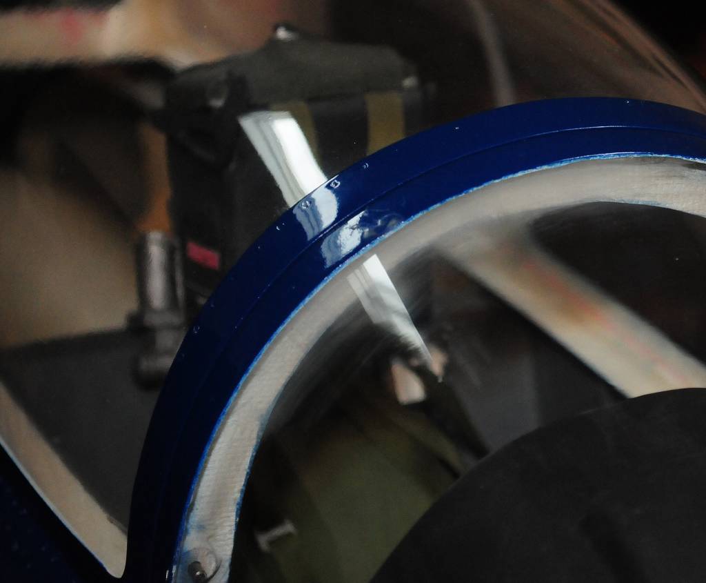

Looking at all the threads about Skymaster quality control, design, and manufacturing issues, i had though that these were mostly confined to the "discount" arfs originating with that company .. Unfortunately these problems also plague the $5K plus large jets as well ... I'm not making this post to bash anyone, but its only fair that potential buyers, as well as current owners are aware of the issues so they can be sure to inspect an review every single bit of these planes for problems. A month ago i took delivery on a MB339 arf+ pro plane .. first impression: wow, gorgeous plane with amazing detail ... but it has some serious structural problems which would result in loss of aircraft and worse yet, someone getting hurt with 50 lbs of jet departing from the sky in pieces .. here's the problems i had ..
- the tubes in the wings were so poorly laid up that most of the tube was just unsaturated glass cloth!! I could put my finger through it if i want to. The rest where there is epoxy/resin, is such a bad quality that its still gunky and gummy. I actually could not get the wing tube out at first because of this. It came out looking like it had bubble gum stuck all over it. On one wing, there was a rib shoved through the wing tube receptacle with globs of glue all over it .. i could not even get the wing tube all the way in on that one. With the wings, therre is no way to fix this, and i am waiting on a new pair of wings ... So a $5k arf that for a month i have no wings for, and not i have to wait at least another month before replacements are ready (that means2 - 3 months Chinese time )
- Fuselage formers: Most of the fuselage formers (besides the ones that join the two fuse halves) were so poorly glued with such bad glue, that most of them popped easily off by hand. This includes the engine mount rail structure which came apart with probably 1/2 the force that an engine would actual put out and place across these areas .. At least these are all things that i can fix ..
- canopy glass all over was poorly glued with smears all over it ... hey, for $5k i expect clean clear canopy glass ... my 9 year old could do a cleaner neater glue job.
- with very slight pressure, all the leading edges on the wings "popped" ... this means they could have blown apart in flight ... i assume however this is a potentially bad area on most planes and have my methods of resolving and reinforcing anyway ... (1/8" hole under wing side, spray in some water .. wait a min, and pour in some "gorilla glue" letting it settle to the LE ... rock solid and will never let go) .. I will do this on the replacement wings ...
- the wing tube is poorly glued to the fuselage and the area actually transferring the loads to it from the fuse is very very small .. definite reinforcement and added structure will be needed here...
- on elevators, the live hinging tears and would not have lasted very long. I reinforced this with additional hinge strips from the inner joint. I will use added pannel screws and inner ply tabs to further secure these. I will probably do the same on ailerons and flaps, as they will likely develop the same problem ... i do wish these were not live-hinged .. its not scale looking this way either (but that's just a personal preference ... )
I do have to say Jeff at RCI has been nothing but super helpful, and i feel bad he gets to be stuck in the middle in these situations. I think SM needs to focus on customer service and quality with their existing planes before they keep trying to flood more new ones on the market. In retrospect, had i known there were such issues with SM planes (on the larget models) i would have probably gone the FeiBao route and just modified/reinforced the plane as i have to do on the SM one anyway ... would have been over $1K cheaper too I wonder if other companies SM manufactures parts for are also affected by these QC issues
for for what its worth, please do check every part possible on your planes, especially that hard to see or get to areas. With some things like wing retention tabs, wing mounts, engine mounts, hinges etc, this could mean losing your plane or someone getting hurt ..

I am wiring on replacement wings and parts, however this has put me out for going on a 2nd month. RCI who is the sales agent has been more than helpful in all this, and i praise Jeff for his efforts. I understand MOST planes will not have issues, but MANY do.... Just like with Toyota .. most did not have brake issues and are super reliable .. however enough did that it became newsworthy (a recall was in order there . ) ... I have had numerous SM jets through the years, and had absolutely no complaints with those. I was just really surprised to see such a major QC issue with a jet like this .. and then how long its taking to resolve this just adds annoyance on top of that ..

Part of my concern in these situations is in the fact that these airplanes are produced on a production line. That means there is going to be more than one worker responsible for one complete airplane. None of the parts are produced specifically for one airplane, in other worse, just because you get a complete kit all at once, doesn't mean that the wings you received, and the fuse, and tail, were all produced at the same time for that one particular airplane. They might have layed up 20 fuselages and 20 sets of wings, there is somebody responsible for each part. So when you see faults like this in all the components, it leads me to believe it's not just one person having a bad day, but rather the overall process at the factory.
If these airplanes were produced one at a time like the smaller guys do, and by one or two people, there would be an excuse, but these factories in china have multiple workers, working on many airplanes at once. It would be reasonable to think that the guy building the wings had a bad day IF everything else in the kit was done correctly, but to have flaws with the wings, fuse, and stab says to be that they are simply cutting corners.
Customer service is great, and replacement parts and/or kits are fine, but when it comes right down to it, there is no excuses for an overall airplane to have this many issues.
It's just my opinion, but when you start talking $5000, there are a lot of airplane options out there, you should have to settle for issues like these.

While I know you to be a good person, and a friend of mine, I must disagree with you on these points.
1. Turbines don't have vibration no, but there are extreme loads on the rails that mount the engines. Both from their thrust, as well as G forces while the airplane is in motion. The engine is really the single heaviest item in a jet. On a bad landing, you could experience up to say 8G's, and that is a shock load, that means you've now got effectively a 24lb engine that is giving a sharp jolt to the engine mounts. Wojtek flies hard, the jet will be subjected to many G's, engine mounts and formers are critical.
2. The fiberglass tube in the wings may be there to guide the wing tube, but it does have some structural use as well, if for nothing more than extra support for the ribs it passes through. In the large Viperjet the wing tube carries shear webs above and below it, it is part of a structure. Besides that, when the tubes are an individually laid up component, and you see them done that poorly, it makes you question what other internal structure was missed, especially when you still find raw resin's in there that cause the wing tube to get stuck.
3. Formers should all be able to withstand a good yank by hand, again, take a look at the weight of batteries or other components, particularly in high G flight. I personally want the security of knowing that if a former comes loose, it's only because it's taking fiberglass with it. It is not difficult to properly glue formers into a structure, it just takes a little care.
I'm not trying to say these things to start a war, but you're asking people not to post in this thread and let skymaster deal with it, but your comments do not make skymaster look good. They make it look as though you're saying these problems are ok because they might not actually be issues down the road. However, they shouldn't be issues at any point and time.
Again, it's just my opinion, but I'm happy to see threads like this, it warns others that might not realize they SHOULD check things over to do so.
