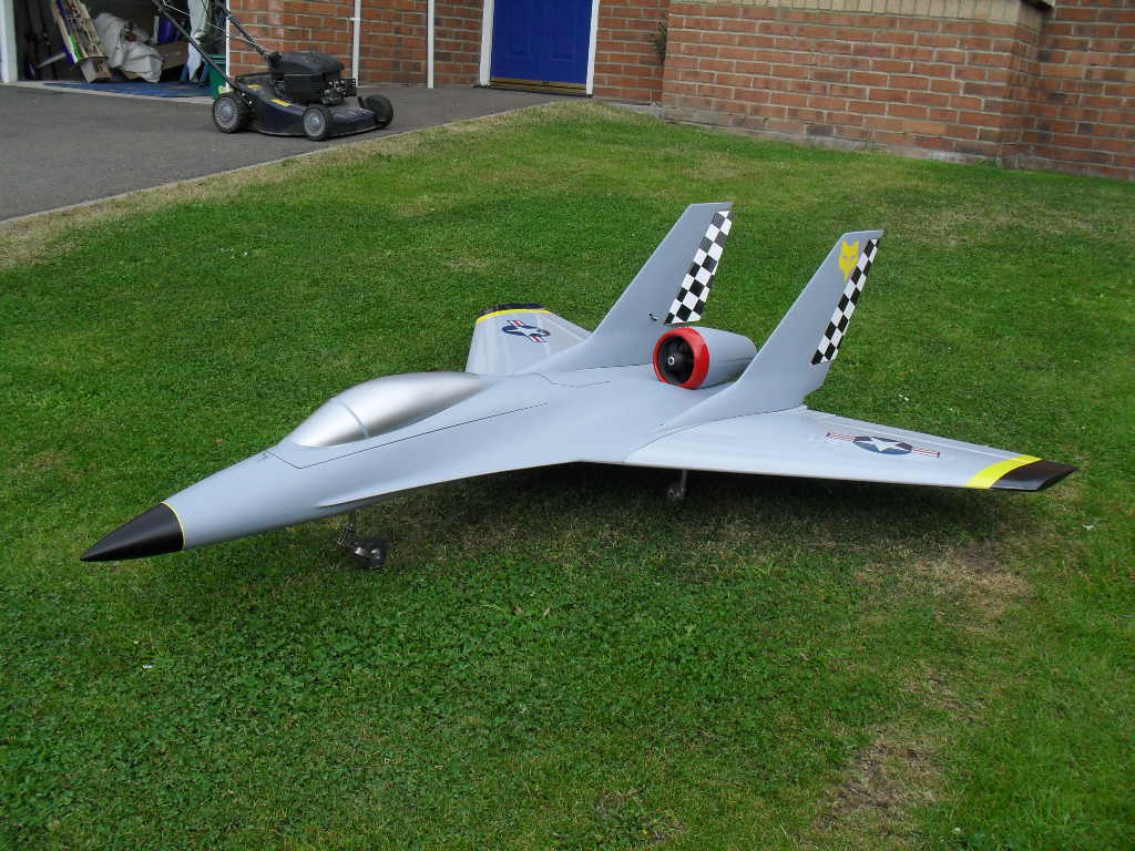

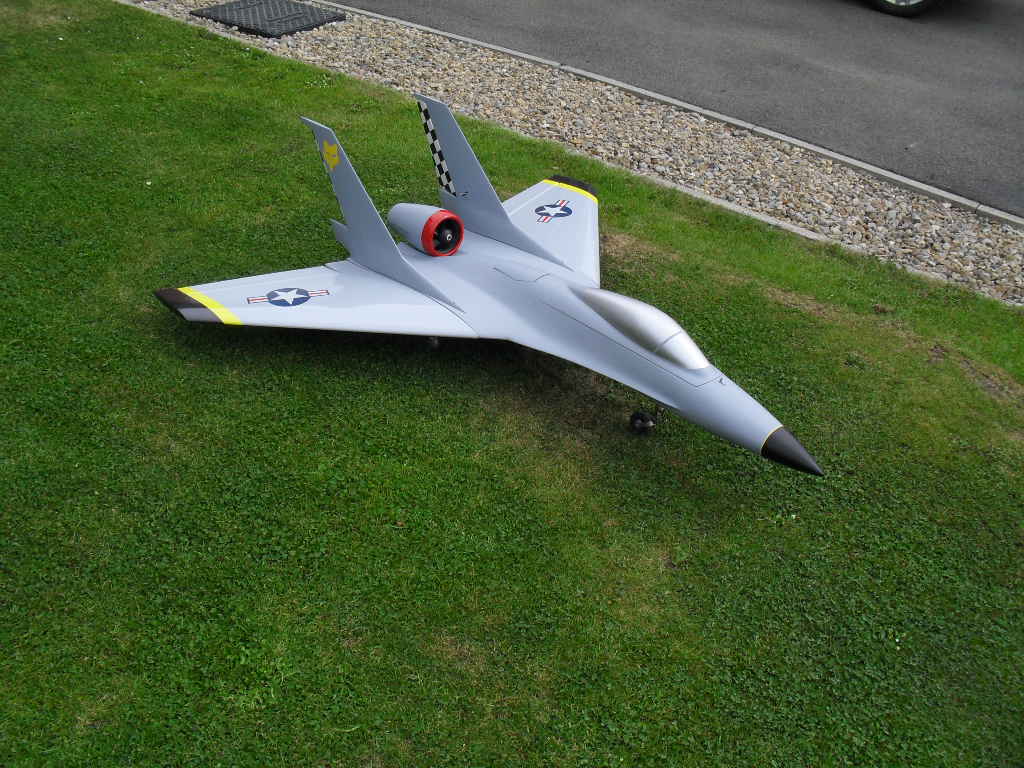

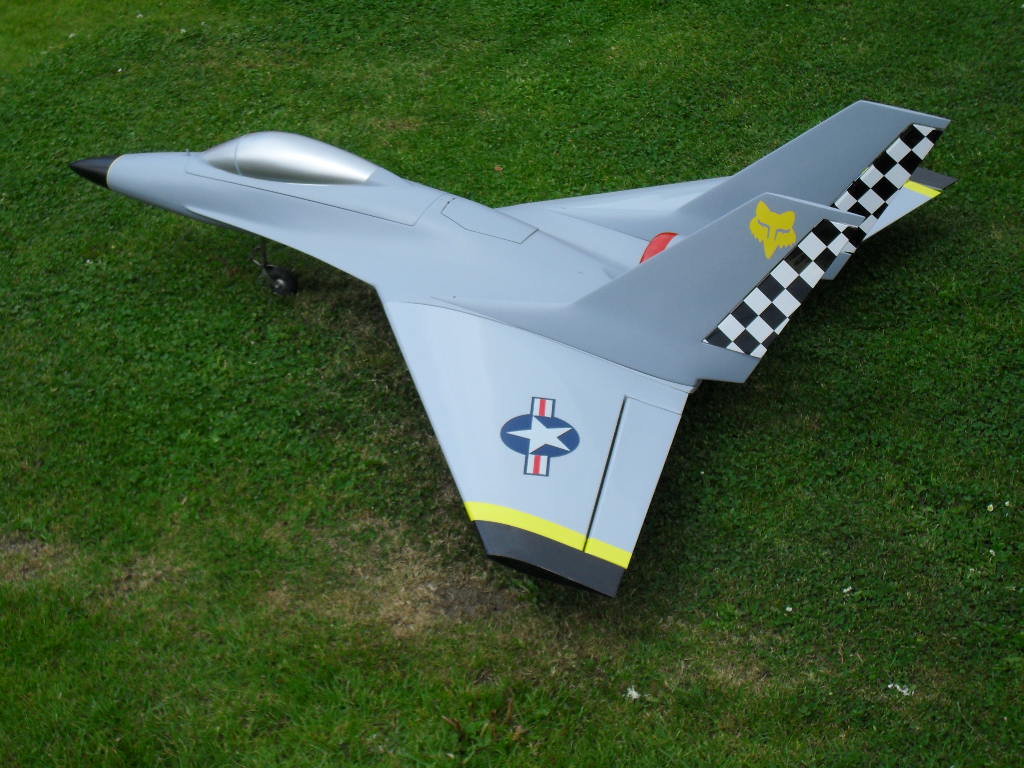

nice work so far, i have just finished one off but for an edf.My last one had a homebuilt Wren 54 on it and was overweight and overpowered a p60 will be more than enough but i think a p20 would work???,
cheers Euan.
cheers Euan.
