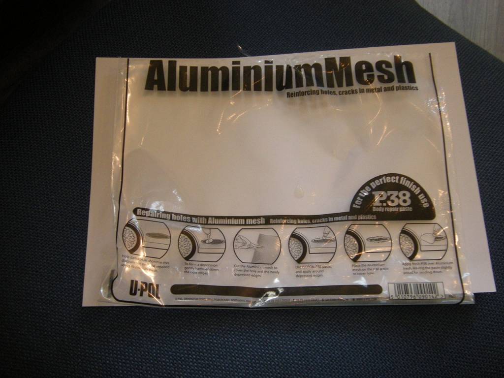

If Marcs looks at this I am sure he will weep. Still here we go how to make a P20 Fod Screen..... Mk 1 I am sure I can improve on this.
if 3Dflip is looking come on you can do loads better than me
First get yourself some of this mesh from Halfords in the UK or a car parts shop if you live elsewhere
Dennis

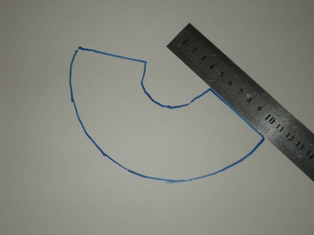

Cut a cardboard template as the picture below. The radius of the outer circle is about 90 mm
The radius of the inner circle is about 25 mm
I allowed about a 10 - 15 mm bit to overlap
NOTE EDDITED TO RADIUS NOT DIA AS ORIGINALLY POSTED

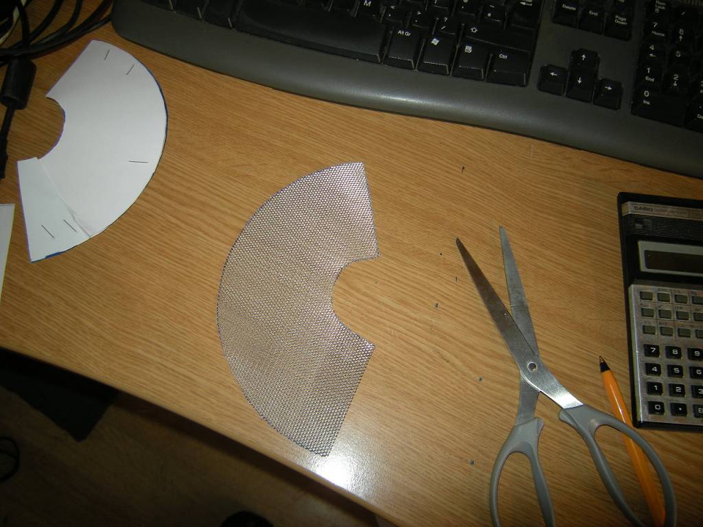

Once you have a reasonable fit mark and then trim the cardboard to the markings. Then unroll the card and draw round it onto your mesh
Cut out your mesh shape with ordinary scissors.......... The ones your wife uses for her dress making work will do fine
Dennis

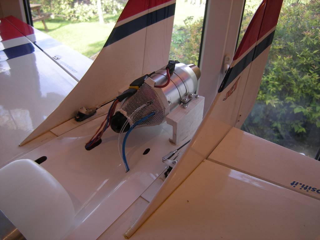

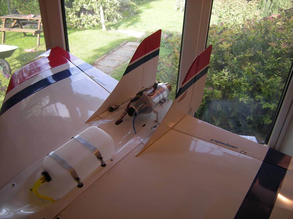

Well here is the Mk1 in place on the back of my Ducty................. Not that Pretty but I am sure it will work and for me and a first/second attempt I am quite happy with it. Nice to be easily pleased
As some would say................ It aint got to be perfect it has just got to work.
Dennis

I tested the MK2 Fod screen today at full throttle and it worked very well. I think the cone shape is best as I feel that there is less resistance to airflow. At full chat the screen shows no sign of movement. Come on guys give it a go and make one we are supposed to be modellers not just people that buy things that are made for us (Says he who has just bought a Bind and fly Taylor Craft )
