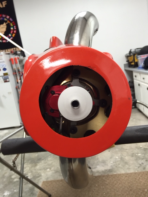

Just picked up my new Kingtech turboprop engine. This is my first Kingtech product, and my first turboprop engine. So , I am really looking forward to completing my PC-21, installing this powerplant, and having some fun. Anyone know where I might buy a 24x20, or 24x22 three blade propeller for this little puppy?
By the way for those interested, I purchased my turboprop engine from Danielle's RC in Nashville, TN. It's really nice to have a local dealer who offers a REALLY good price on turbine engines.

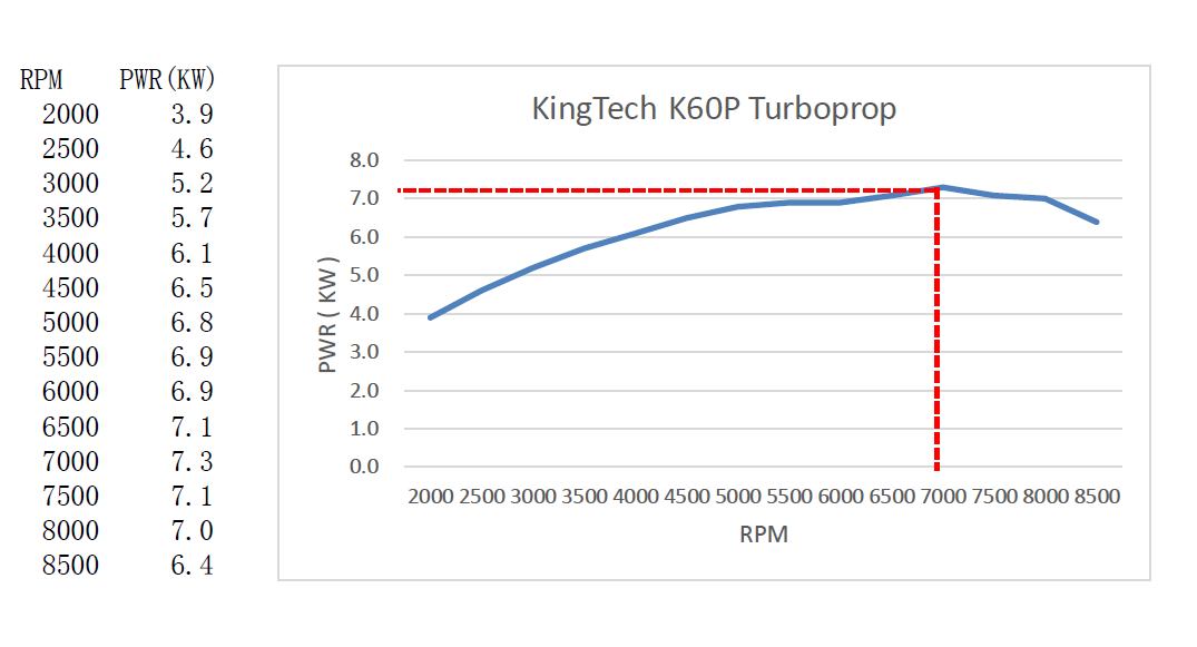

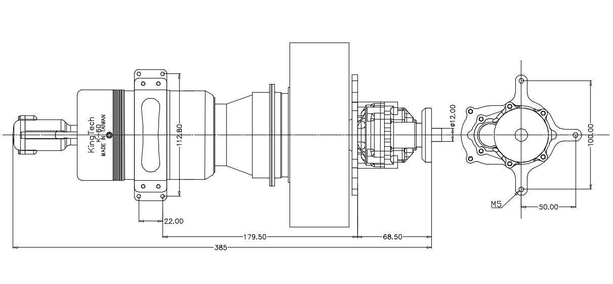

Sorry to be a little slow at updating info on our Turboprop, Boli, our TP is designed to be running at a much higher load but much lower RPM. The ideal prop would be turning at 5000 static and unload only up to 7000RPM. This would ensure max output and longevity of engine. Please use no smaller than 24x16x3b, as it would provide 5500/7500RPM, while a 24x20x3b would achieve the sweet spot of 5000/7000RPM. Anyone has suggestions on people to contact for prop making, please let me know, as we like to develop something like a 22x22x3b and 21x21x5b. Thanks in advance!

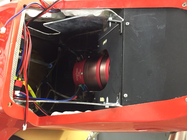

Engine installed and maiden complete! I initially had a 25 x 12 / 3-blade (and set to 5000 RPM because that's all I had at the time) which I did the maiden with; and although those that saw the flight though it did well, I felt it was underpowered and since I had reduced the max engine RPM from 160 to 140K to achieve the 5000 prop RPM, I knew I had room for more prop and power. I have since obtained a 25 x 17 / 3B, but have not had a chance to try it. I'm excited to give the new prop flown as I think the performance will be much better, but I think it will have to wait until I return again from work.
Please post your flight experience and prop set-ups.
