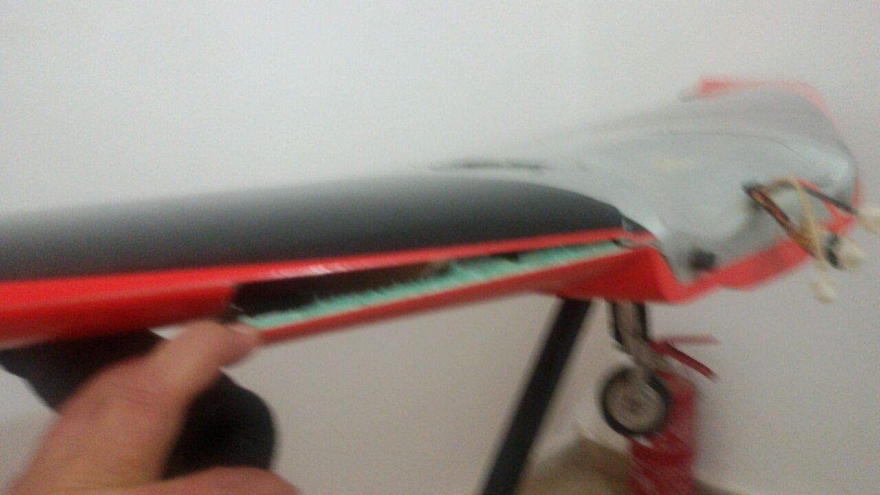

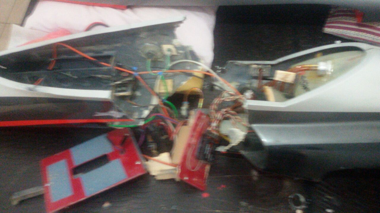

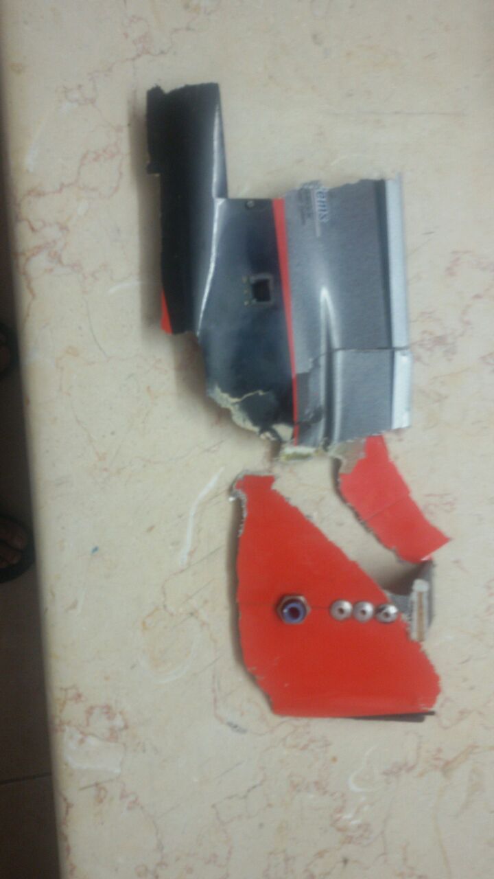

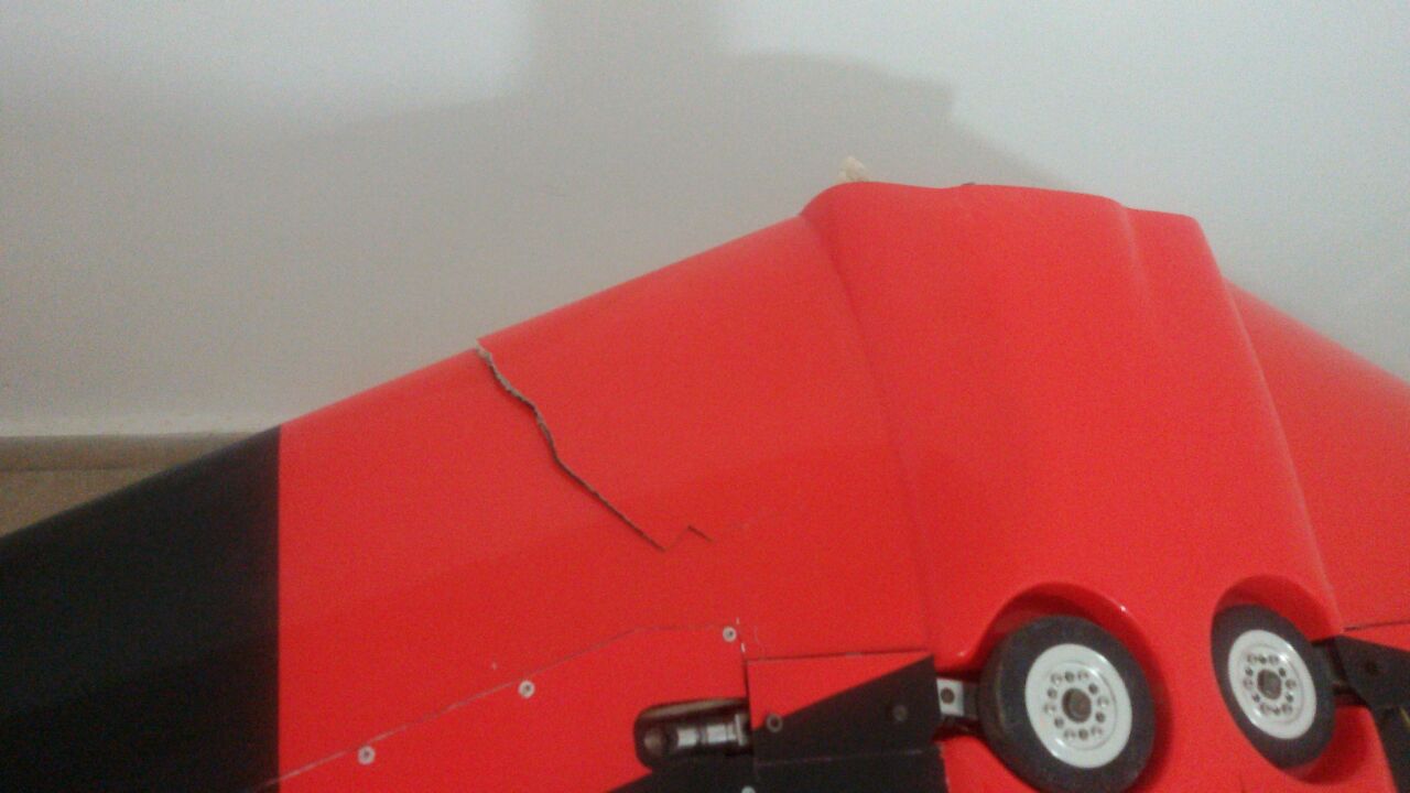

Hello Guys,
Some of you may remember my former Ultra Flash resurrection thread:
http://www.rcuniverse.com/forum/rc-j...step-step.html
That Ultra Flash was repaired with great success and has been flying great ever since:

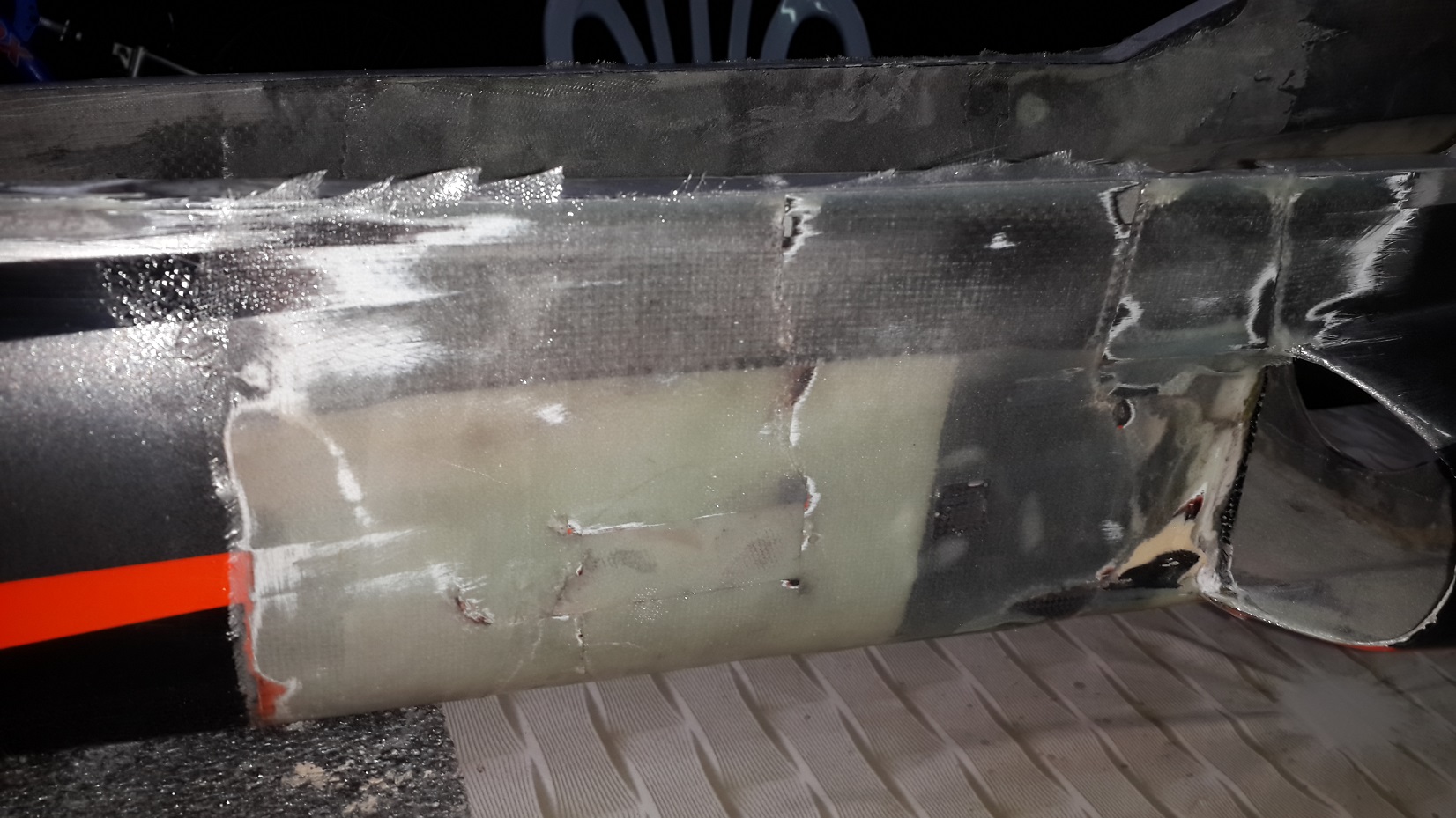

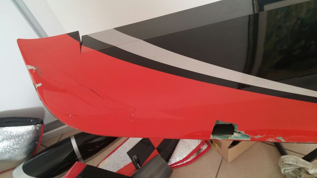

https://www.youtube.com/watch?v=nTVLCJ0hdDM Unfortunately, one of my friends lately crashed his UF when he had an engine cut right after an aborted landing / Go Around attempt.
The damage consists of breaking the entire nose section off (some small pieces went missing) in front of the ducts, and cracking several other areas of the fuselage, nose cone completely cracked, horizontal stabilizer survived, but wing suffered damage to both tips, and to the root area skins, one hardwood wing mount displaced, split open leading edge on one side etc etc.
The damage is quite severe.
Looking at a broken jet such as this one, most people would say "BIN IT!" but we have the magician from Kiryat Gat, Mr. David Ifrah.
David is a professional UAV composite builder (as a profession) and fellow modeler and jet enthusiast. He took one look at the broken UF and said "Ill repair it for you, no sweat!".
So I decided to get the broken jet from my friend and let David work his magic on it.
First pictures im posting show the damage to the jet before the repairs.
Check it out.

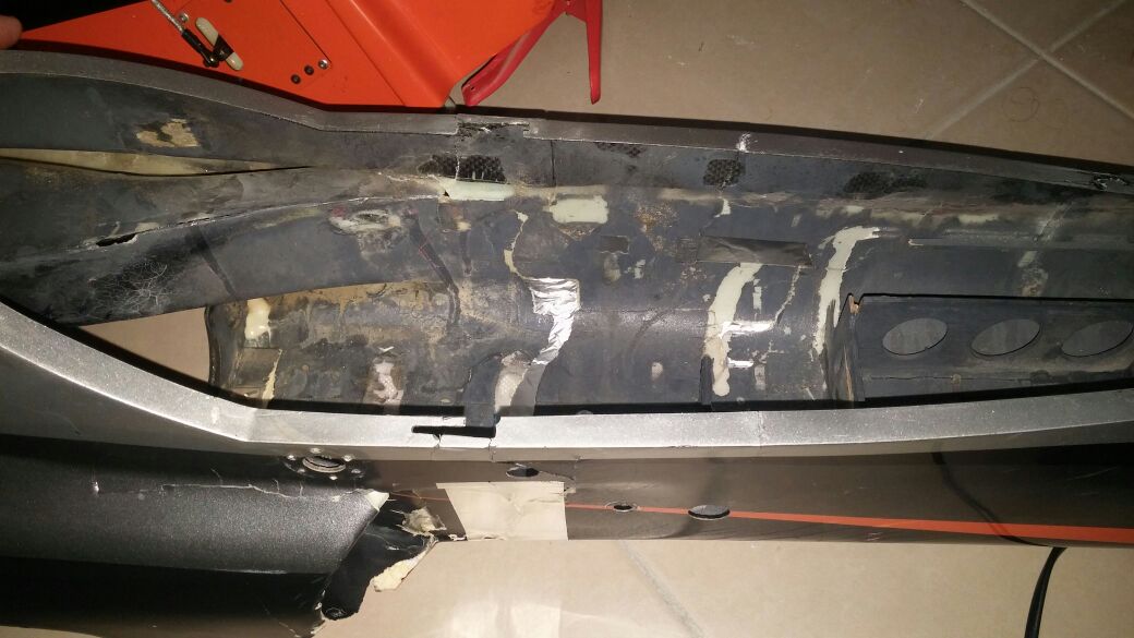

First step of work was to strip the plane down of gear, and CA the broken fuselage puzzle back together, and then apply some aluminum tape on the outside, where there are missing pieces.

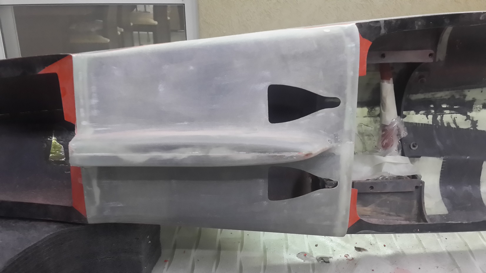

At this point the jet was delivered to David (Dudu).
David started by cleaning off all the paint from the inside, cutting off the (damaged) inlet duct in order to repair it outside the fuse, and then applyied carbon ans glass cloth to damaged areas, to set the fuse into place structurally.
slots / cavaties were closed with structural 3M Epoxy + Aero Seal mix.

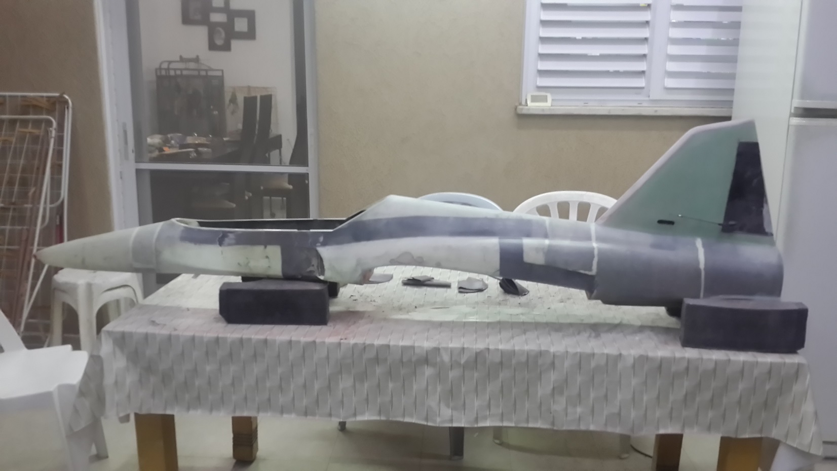

David then proceeded to strip the paint off the entire damaged fuselage area, sanded it and applied a thin fiberglass layer on the outside, sealing all former repairs.
and sanded after it.

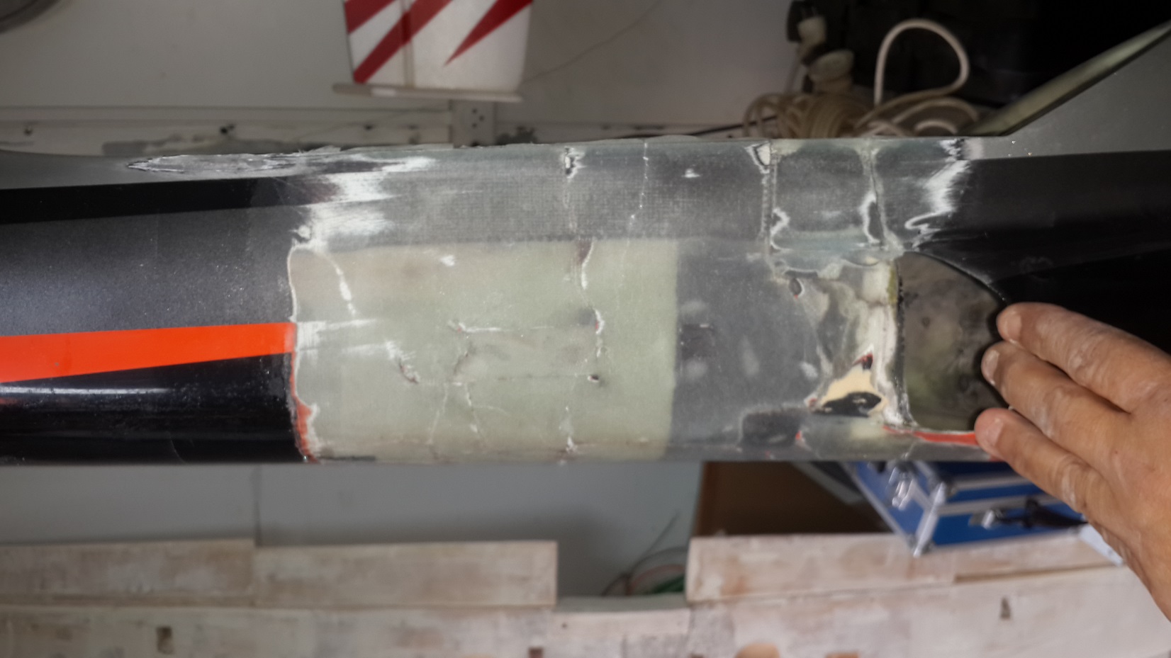

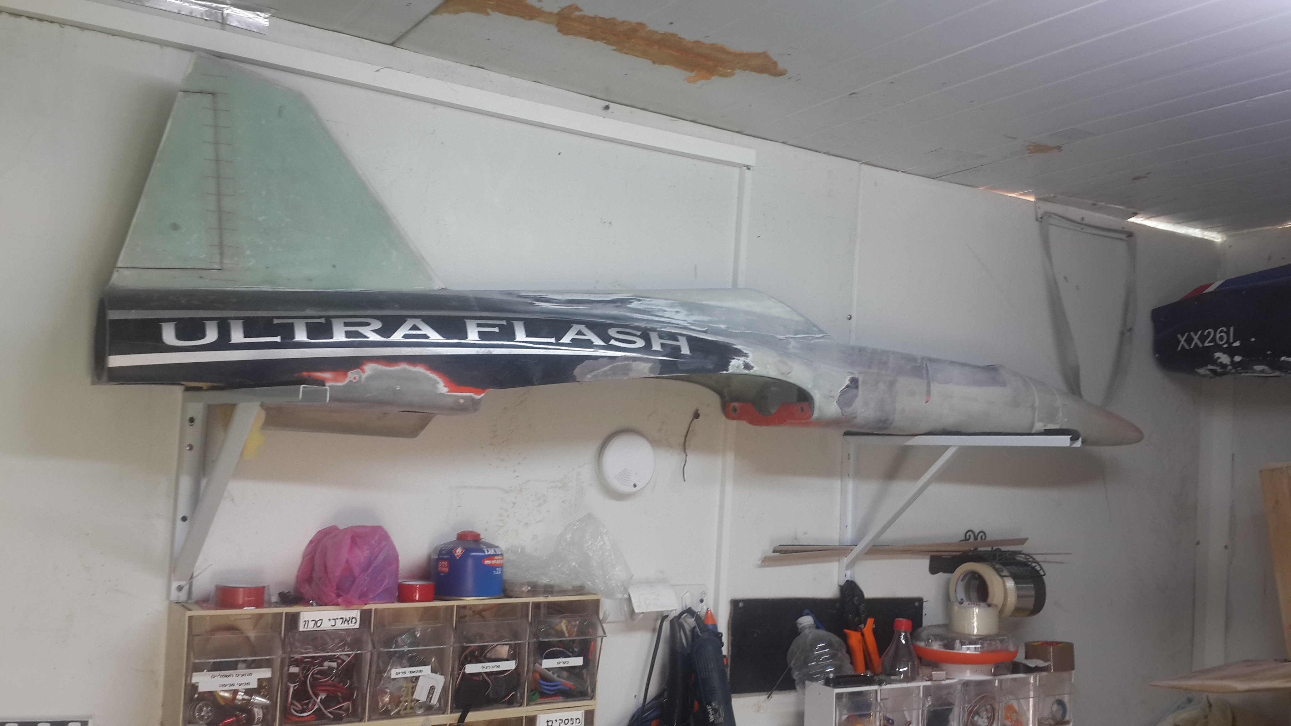

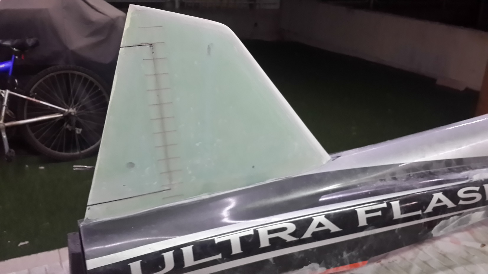

Since he developed a way of stripping down the paint while doing the repairs, he thought "why not strip the entire fuselage down?"
anyone ever seen an Ultra Flash in CLEAR scheme?

What method did he use to strip the paint?

scratch the surface with 80 grit sand paper and then scrape the paint with an Xacto blade.
its an art

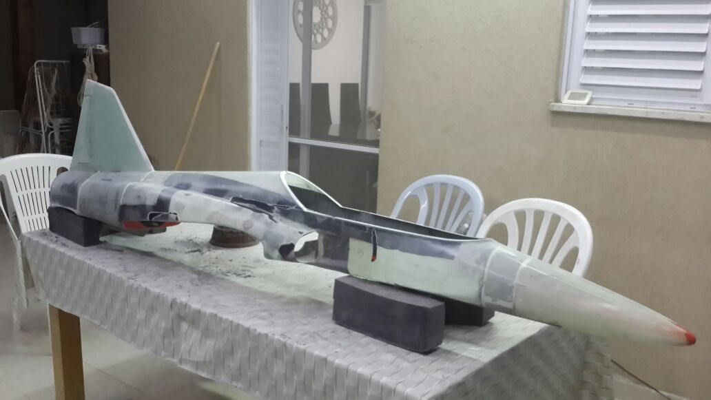

Right side is almost see through as of today

David is on with his great work - Right side of fuse now completely see through.
we found a bit of spackle here and there under the original paint. thats interesting.
Now he will finish all internal reinforcements, and later it will get a completely new finish...
i will tell you already paint scheme will be special.

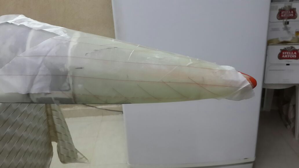

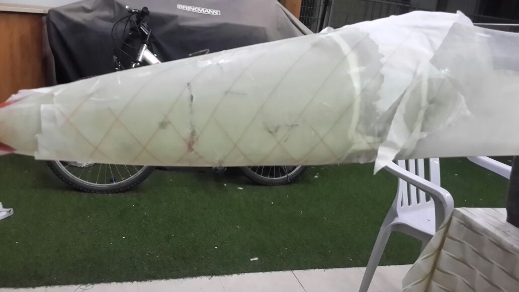

Nose got some glass cloth on the outside to seal off the repairs and re-finish, with peel ply until the glue dries.
