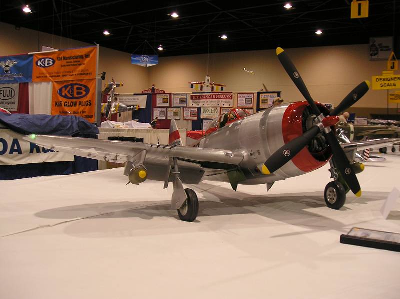

Gary, I used an airbrush for the weathering and then we sponged the whole thing with Future Floor Polish. Look close at the gun residue and around the exhausts. Sorry its not a Jet but the technique is the same.

Terry, thanks for the picture and information. Nice looking P-47!!

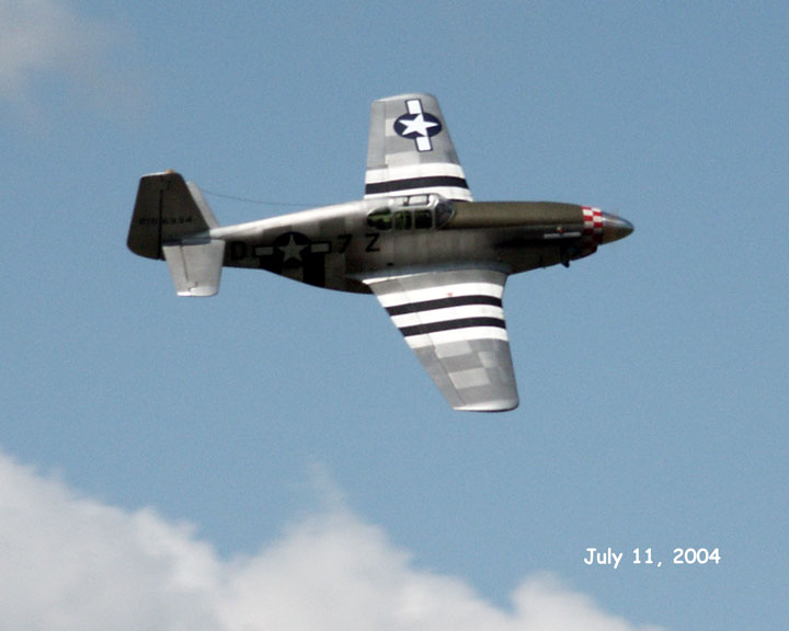

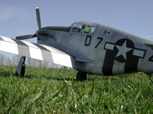

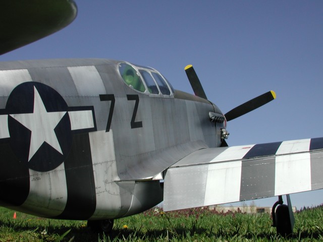

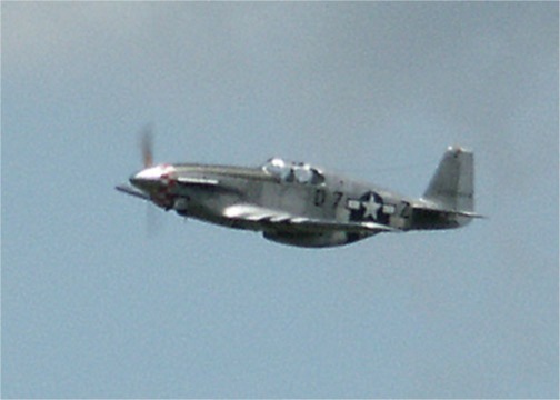

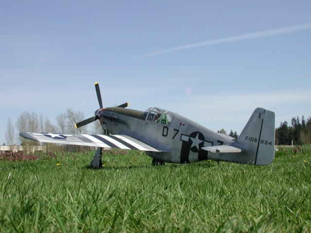

Last year I covered a Mustang in Flite Metal, weathered it with chalks, and clear coated it with Lusterkote flat clear. The below pictures show the results.
Kirk
