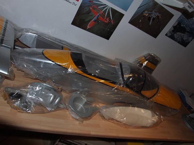

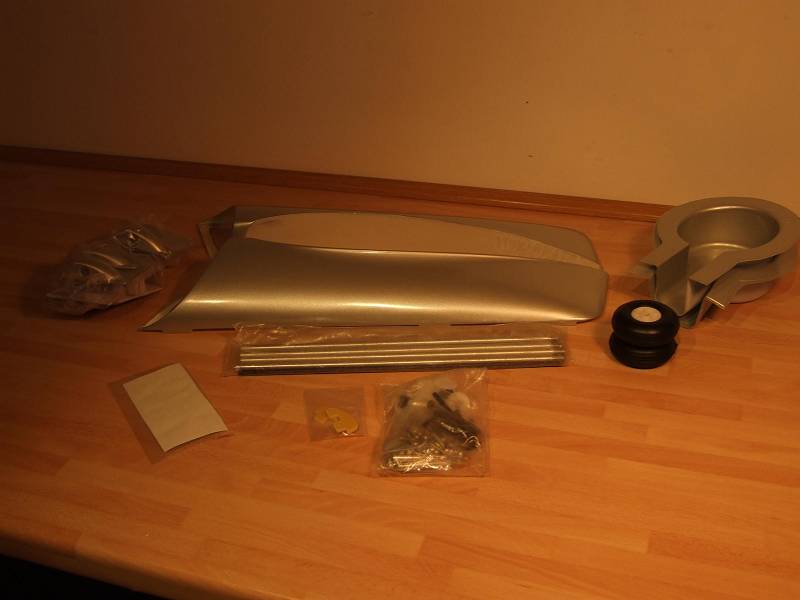

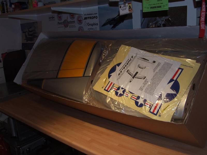

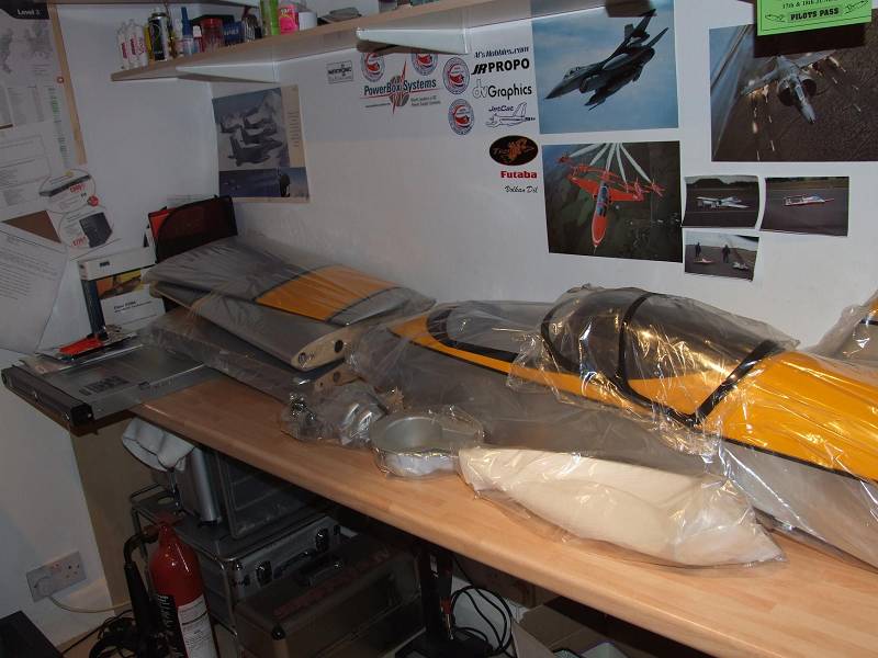

Well the new Sprints have touched dock in England and Alan has asked me to build him one. I got the box earlier this evening and I will start work on it tomorrow when I can pick up some bits for it.
I will post a few pictures of the kit packaged up, (which is much the size of an Intro box), and I will be back tomorrow to begin to the build. I am still waiting on hear on what equipment will be used, but I am sure Alan can fill those bits in!
So here goes:

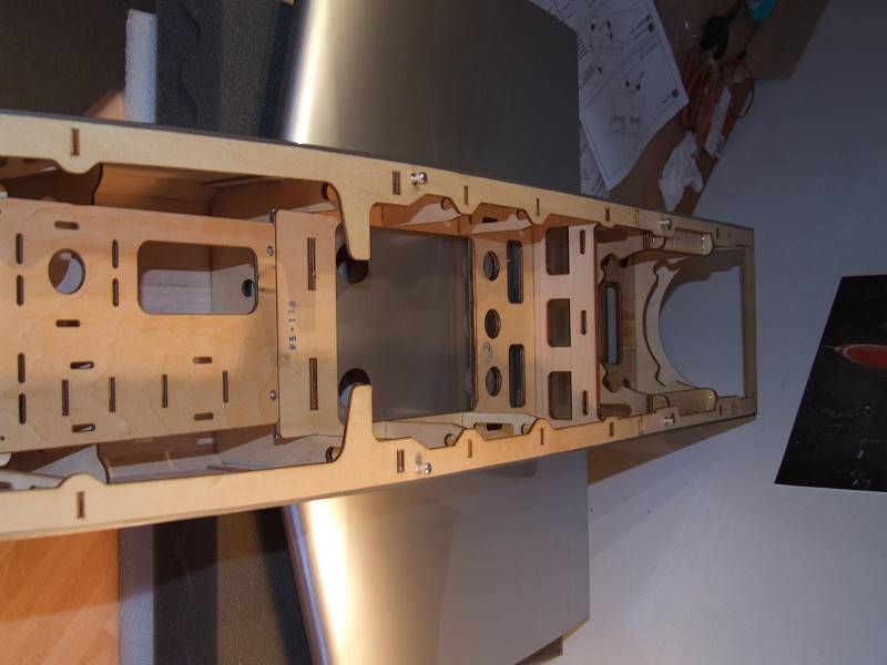

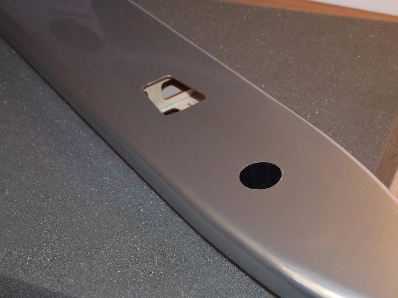

It should be noted that the booms are MUCH lighter than the intro. The fuz is a complete re-design too, and the booms no longer have glass fibre guides, its all CF now. The model with have 3305s throughout apart from the elevator which will have a 8411. Spektrum R9000 RX and some other bits!

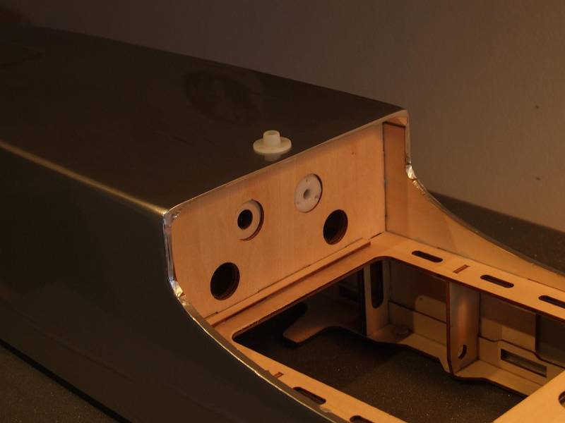

There are no more keyholes with the sprint, the plane fits much like the XL with 2 alu tubes coming out the wings which go through the booms and into the center section where a screw keeps everything together! Much simpler and easier to use.

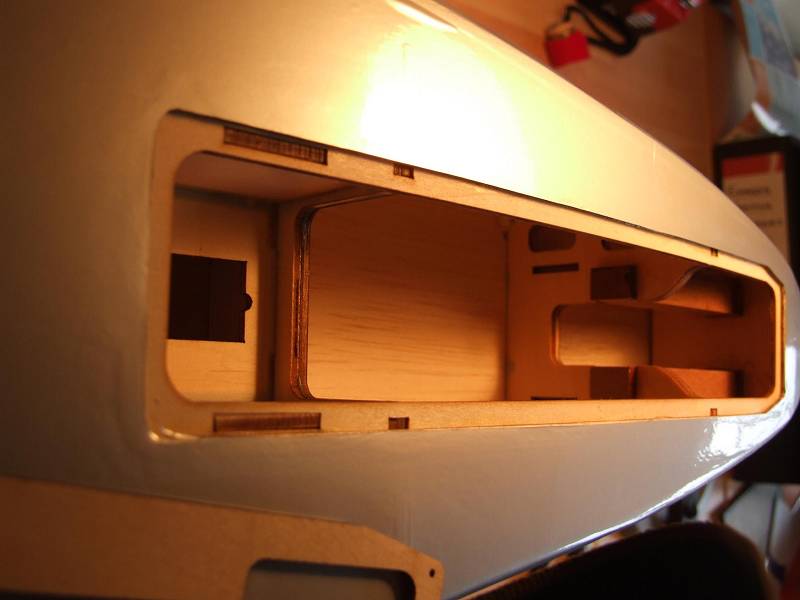

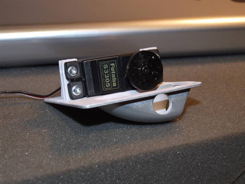

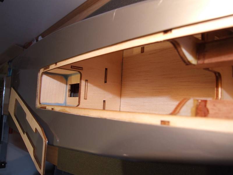

A bit more done, still waiting for the retract units and some servos but I started work on the fuz and centre section today. There are loads of changes from the intro, just take a look at the pictures! Notably there is a lot more room in the nose section of the plane.

Looks like Robart 630s would fit in the wheel wells. Is that a break-away former right where the mains go in?
Old 07-11-2008, 01:41 PM
volkan
Join Date: Sep 2003
Posts: 1,828
Default RE: Boomerang Sprint Build Thread!
Yip!

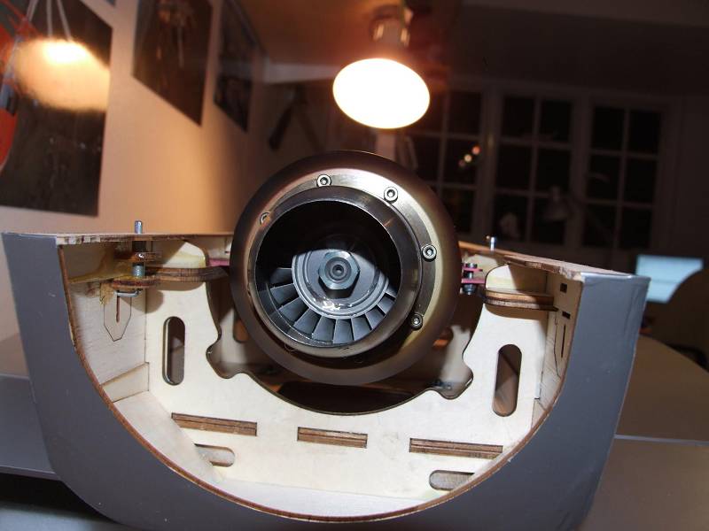

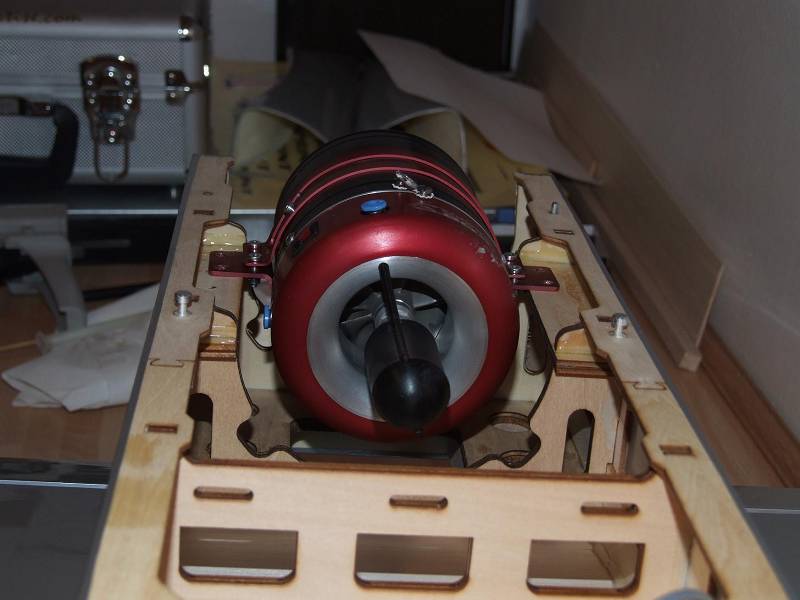

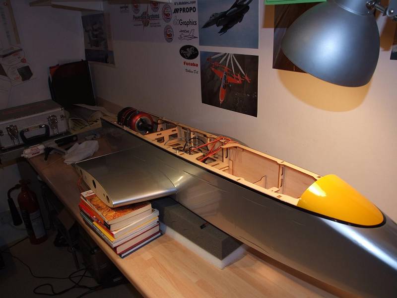

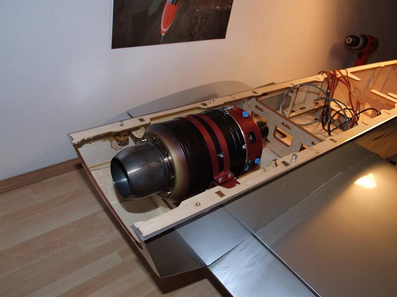

A bit more done today! Attached the fuz to the centre section which was now even easier thanks to the bolts at the back! Just drilled the holes, did a few fry fits, then aeropoxied everything into place! No need to worry about it moving when drying.
Also just placed the engine in the fuz, this is a booster 80+ so its similar size to the P60, and as you can see, LOADS of room for bigger engines!

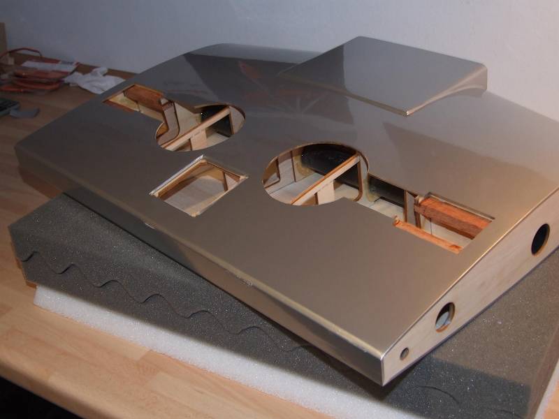

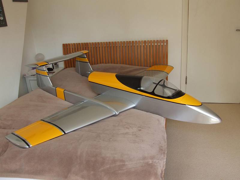

A little bit more done [:-]
Fitting this model together...I have to say...is MUCH easier than the intro!

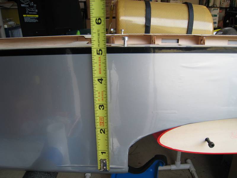

Just got my Kit and FYI for people wondering about the split elevator in the prelim Sprint drawings, THE ELEVATOR IS NOT SPLIT ITS SOLID, ONE SERVO ONLY.
Couple more picts for you guys comparing Baby with Sprint.
Outer wing panels are same between the two.
The new air intakes will need alot of modding to make fit the baby boomer.
