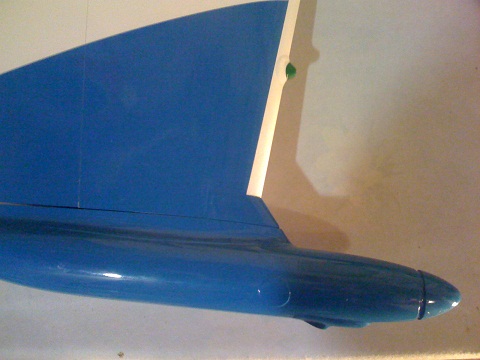

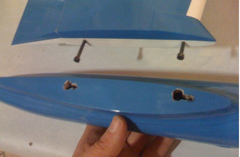

dont know if it has been posted before..
i was thinking of a quick way to mount and unistall the tip tanks on an S/K L-39
i dont like them permantly attached to the wing couse they will brake sometime..
so this is what i did...with only one move and there are ready to fly...perfect fit ...and no visible holes
What holds them tight George?
Do you adjust the screws for a firm, friction fit & the airstream keeps them there?
John.
John.
E x a c t l y John! I have open thread in the resin/fiberglass (that it was quite thick at that point ) and i have also CA the screw in that threaded hole.. and even with the CA it allows fine tuning .
sorry for poor english
cheers
George
