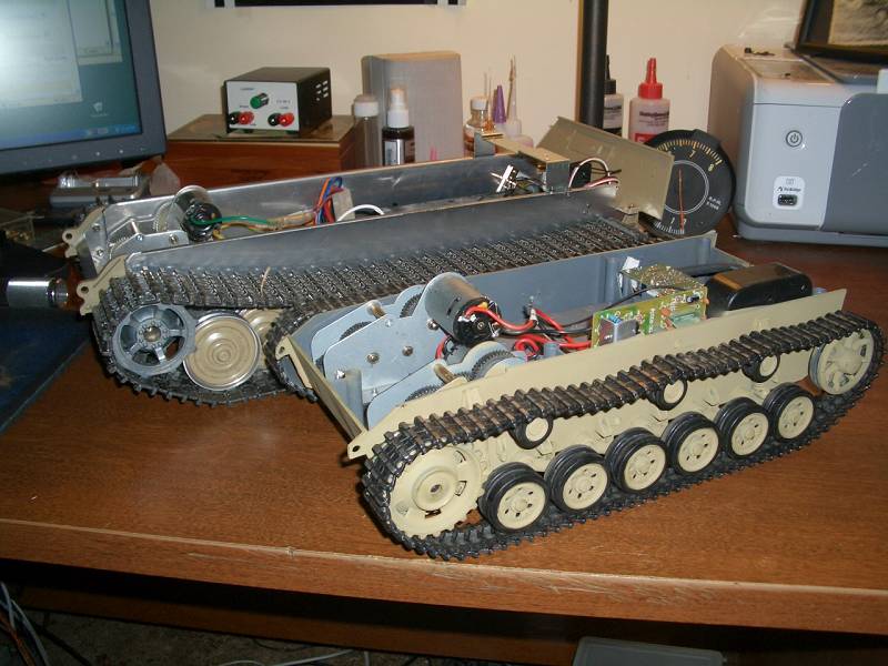

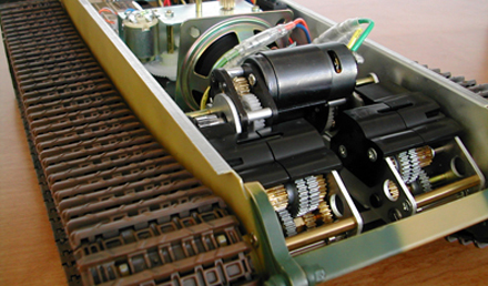

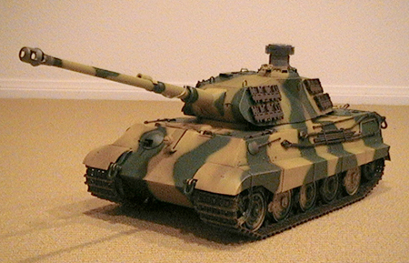

How can I change it? Cool question.
I have converted a couple of old (pre full option models) Tamiya King Tigers to semi f/o and full option, mixing HL and Tamiya parts. The tanks work great, but if you go down this modification road with your Tamiya King Tiger, it can get expensive over time, so be careful. The up side is that if done right, you will get for your efforts a tough, durable and great operating out door tank.
Tips:
1. The compact HL PZ III main gun elevation unit works great in either non or full option Tamiya King Tiger turrets.
Use a small reversing Tamiya ESC (electronic speed controller for non-f/o) to operate the HL elevation motor. Plug the ESC into the receiver. Use a Battery Y Cable to join the ESC to the single 7.2v tank battery.
The HL elevation unit will plug right into the DMD Unit with a plug change. For DMD plugs, email for more info to: [email protected]
Find Tamiya Tank transmitter setup info at: http://www.customrcmodels.com/Tanks/id92.htm
2. Visit this site on how to upgrade the older clutch action Tamiya gearboxes for more performance: http://www.customrcmodels.com/id455.htm
3. If you do not have turret rotation, this is the unit for the non-full option King Tigers. Tamiya still sells it.
(RC Rotational Turret Unit - Hop Up Option Item #53400): http://www.tamiyausa.com/product/cat...p?sub-id=33000
4. Tamiya DMD parts are not cheap, but if you have a lot of time, you can search them out on ebay for better prices.
5. If you install the newer Tamiya DMD Gear Boxes (a drop in modification), use a gear box mount brace found at [email protected]
6. The King Tiger idler return springs should be upgraded for reliable operation, email for more info on a superior kit at: [email protected]
7. This is probably enough for now, but no doubt you can figure out how to add HL sound & smoke units and sync them to the receiver with Y Cables.
Also, the compact HL Speaker box works great in Tamiya Tanks and plugs right into the DMD Unit with no mods. The HL Speaker is a good buy; takes up less room and sounds good.
Hope some of this helps!

Congratulations!
They certainly are expensive, but I don't know of any Tamiya tank owner who was not impressed and happy with their purchase. Your new KT will be a lot of fun, but even though it is better than the HL tanks, it doesn't hold a candle to a full option tank. There is something about the added sounds of the motor, squeeking wheels, gun flashes and cannon booms that really take these tanks to the next level.
My advice would be to paint it and have fun. Then, in a month or two, sell it and put the money toward a FO KT and build it from the ground up. It can be very costly and frustrating to turn one of the older versions into a fully functional rc and even more so to make it FO...and you need to hear the sound of you turret rotating and see your cannon recoil. [sm=thumbup.gif]

I agree you guys, better to build a new f/o kit. The Sherman and Tiger I are the most popular TBU club tanks. They also seem to be the best of the bunch for ease of build and maintenance.
Adding all the FO mods to an older Tamiya Tank usually exceeds the cost of buying almost any Tamiya WWII RC FO Kit NEW. It is something to do for fun, not profit.
As I suggested, the tanks work great, but if you go down this modification road with your Tamiya King Tiger, it can get expensive over time, so be careful.

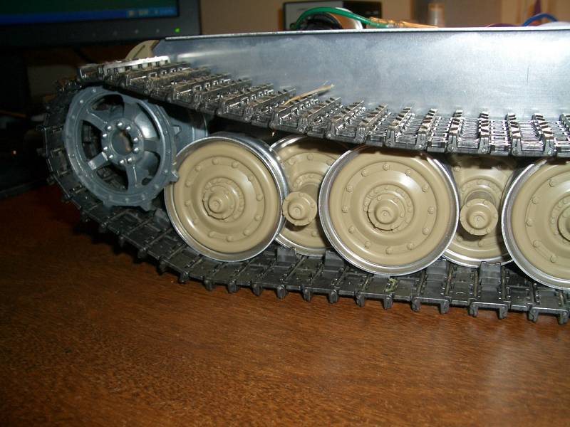

Tried zimmerit on a Tamiya 1/16 Tiger I Mid and it is not much fun at that scale. Never again.
Use WD40 and Tamiya gear grease (Tower Hobbies) to quiet the turret rotation gears. And you can use a small reversing Tamiya ESC to operate the turret hop up kit and save the space the servo system takes up. Just wire it direct to the motor. Show us work in progress images when your ready.

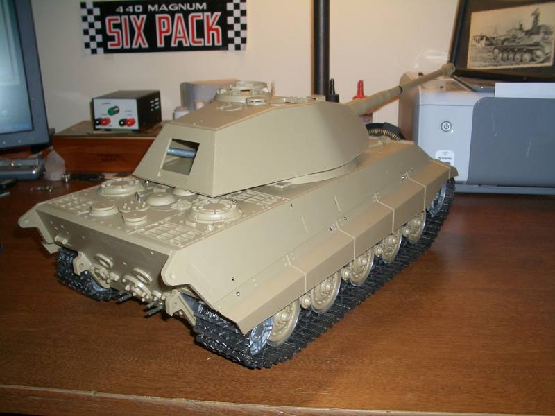

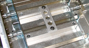

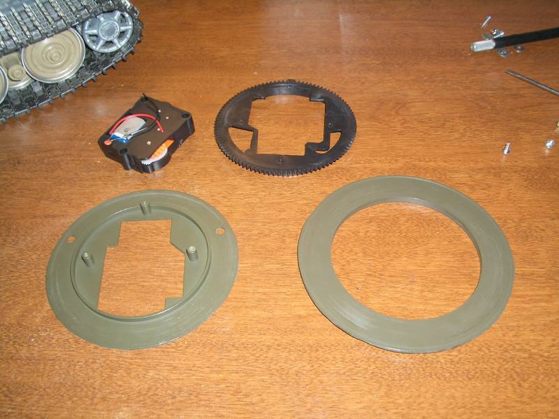

Here's some prelim assembly pic's nothing too special yet. What you see is the kit built pretty much out of the box. I still have a lot of detailing to do and some electronics to add. This thing is really big. It's amazing. I set a HL PIII chassis next to it for size comparison.
The gun in this one is my .177 caliber Mark 2 design with a 315 mm barrel. The biggest I've built yet. I'm not much of an IR apple guy.
I'll load it through the rear loaders hatch. We'll, I guess that kinda makes sense.![Smile](https://www.rcuniverse.com/forum/images/smilies/smile.gif)
I had to come up with a different turret traverse since the guns in the way and the Tam ones are pretty weak anyway. Took an old HL Bulldog to the band saw and cut out the necessary parts. I'll graft this on then control the HL servo with a ESC as you mentioned. I think elevation will be a mini servo.
Man, this thing has been great to work on.

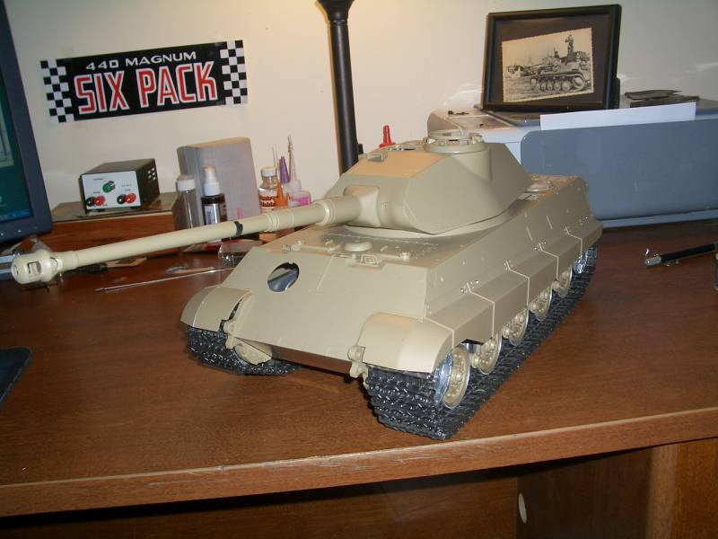

The turret trav mod is done and was completely easy. The grafted HL parts fit like they were designed for it. The green base rotates cleanly

Looks like you still have room in the turret to add main gun elevation. Try the HL PZ III elevation unit and 2 heavy springs to hold the barrel at full up. The motor then depresses the barrel easily, once you adjust spring tension. Use your atomic cannon as a fulcrum, just like the PZ III solution.
I did read the last of Porsche Turret KT lacked zimmerit, probably in the Tamiya Directions.
But since you like zimmerit check out this KT: http://www.naritafamily.com/Scalemod...hoto_frame.htm
You may want to finish this build with a better idler spring tensioner system. The kit's stock idler springs do not work. The plastic tracks will break as they flop around (right side mostly) and or throw metal tracks. Another solution is to anchor the idlers in place.

A little bit of double posting here but I just finished my esc for the turret traverse. Thanks to Darkith's idea I hacked a standard servo into a reversible ESC for the turret traverse mechanism. So that's done. I just need an elevation scheme which I already have in mind.
Here's the converted servo-ESC.
Here's the link for more info
