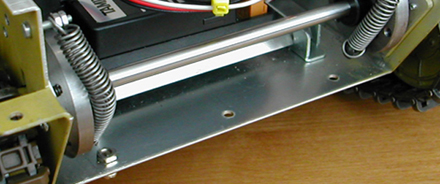

The Tamiya King Tiger as an out of the box build is a so so performer. It needs some running mods you have not considered, if you are going to fight it on battle days and or really enjoy running it in the backyard.
Of course, if it is an indoor model, the KT mods are not necessary.
The Tamiya kit idler spring tensioners do not work very well, so at the very least those need to be upgraded to keep the tracks from breaking or coming off.
Suggested King Tiger Battle Day Mods:
1. Idler spring tensioner system (email for more info: [email protected])
2. Gearbox mount brace to stop the hull from flexing and deforming (email for more info: [email protected])
3. 3 to 1 gear reduction (KT scale speed is way to fast as is the Tiger I) http://www.axels-modellbau-shop.de/k...g:::1_2:2.html

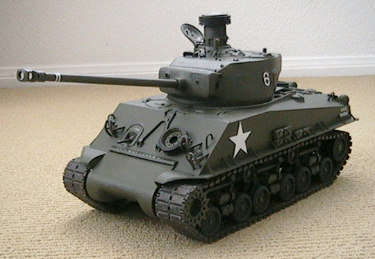

After seeing the recent Sherman build results of others on this forum I interrupted my Tamiya Panther build (also awaiting the arrival of corrective Panther parts) and built a Sherman with a T-23 turret.
The build is a battle day oriented M4A3 (76) W HVSS/M4A3E8 “Easy Eight†Sherman Tank; Tamiya F/O with TBU and I am pleased with it. It works great and required very little post build tweaking
to get it to run well.
I just sprayed it with rattle can paint, Tamiya Olive Drab TS-5 (late production color) and dusted it with Testor's Dullcote. I will detail paint and weather it later. Probably, will not even drag out the airbrush to finish it. I will dry brush it with PrismaColor Chalk and seal it with dullcote.
Sherman Budget:
Kit $339.
Hong Kong Air Mail with Insurance to CA $115.
TBU $75.
T-23 Turret Kit $120.
Spray Can Paint $23.00
Receiver and crystal for existing radio $30.00
Total Build: $702.

nice looking easy 8. I want to do the same with mine, but am antsy about taking everything loose in the 105 turret and attaching it in the T-23. Do you have guidelines or photos to show howmyou did it?

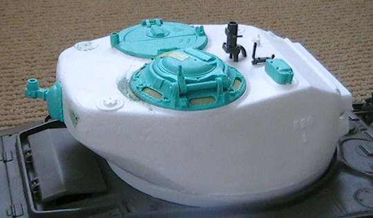

Thank you, the T-23 kit is easy to work with and the swap should be trouble free. You will not ruin your 105 turret either. Nick Aguilar's T-23 Turret works and looks great. The T-23 turret operates the same as the Tamiya kit turret.
I wasn't interested in Shermans, but all the recent cool Sherman builds on this forum (including yours) changed my mind.
This site is my primary quide: http://www.rctankhq.com/T23_Turret.htm
Turret Kit: Re-purposing the Tamiya turret parts is a snap. Step 24; Part MY5, gun assembly mount is the only delicate removal chore. Everything else just un-screws from the 105 turret. The barrel and new muzzle break are well done and required minor putty fill and light sanding. The main gun flash unit fits in the barrel, by carefully removing the orange sheathing.
All the original Sherman kit parts drop into the T-23 turret with some minor cleanup sanding and drilling just 4 holes. The IF emitter drops into the new mantle per Nick's design feature. The kit came with an optional transmission cover, mine needed some sanding to get it to fit right, but it looks good now.
Other Mods: This Sherman uses a Daryl Turner gear box mount brace, metal elevation arm and I glued the turret clutch gear tight, but other than the turret kit, it is an out of the box build. Overall tank weathering and detail painting latter.
A few ETO detail parts are ordered: metal lifting rings (the kit includes good plastic rings to mount, but I would break those off during maintenance), metal periscope covers and metal shock absorbers oil reservoirs.
I know guys have done great jobs modifying the rear deck and back end, but I also found tons of online images documenting the Easy 8 without those updates. I did not mod the Tamiya hull to the later configuration. Visit: http://ph.groups.yahoo.com/group/arm...os/browse/9f30

thanks for the info. I have one T-23 turret, mounted on one of my Century 21 Shermans to give me an early VVSS 76mm version, so I know how good the turret is. Maybe I will pick up another and do the conversion, now that Mike has a muzzle brake for the gun. . Thanks again.

incidentally, Mike's T-23 turret is an early model with the large, split loader's hatch. The Easy 8's I am used to had the later oval hatch like the Pershing, which opened outward and extended over the side of the turret. I might have to do some revamping and change the hatch for a korean War Sherman.

pcomm1 , If you are having trouble fitting the flash unit into the barrel remove the shrink tubing around the length of the wiring. Trim the shrink wrap around the flash unit but do not remove it. Pierce a small hole at the end through the shrink wrap and tie a piece of thread through the hole. Insert the thread through the breach end and pull the flash unit through the barrel feeding it in as you go. It should fit without the shrink tubing. I've done this with a flash unit that i have and it did fit. BTW, did the tips fitting the transmission cover work out? Hope so.

T-23 turret update:
Hi Nick,
The kit trans cover now fits well. I will try the tip on the flash unit today.
The flash unit is installed now and works just fine. Slipped right in, easily, per Nick's instructions.
Didn't even take 10 minutes to install!
