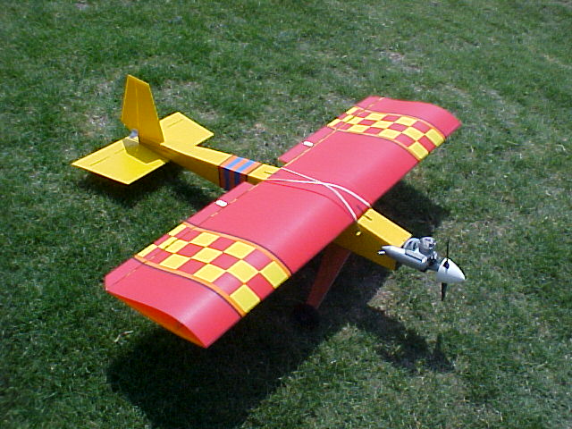

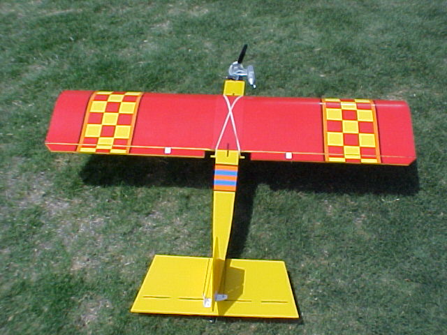

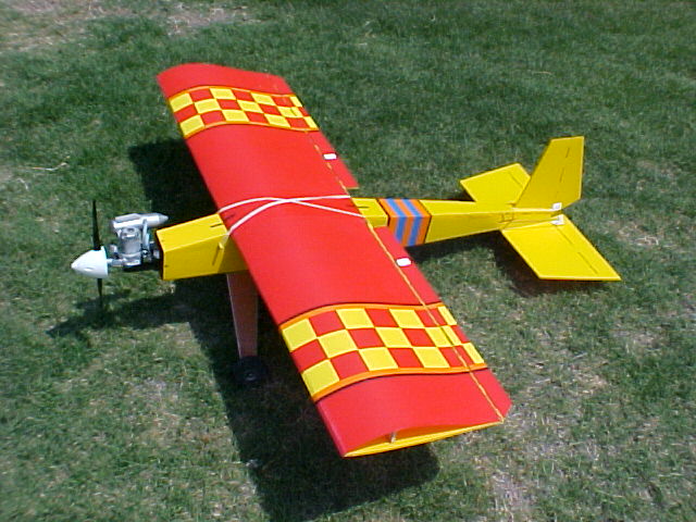

Thought I would post a few pics of my new SPAD. Its pretty much a SpadStik without the angled wingtips and round fin/rudder of a traditional Stik type model. I haven't flown it yet. The winds have been 15-35MPH the last few days. It weighs 5lbs on the money and has a new LA 46 for power. My buddy is building a full size Falco and had a sheet of aluminum left over that he gave me and I made the langing gear myself. I pretty much had everything on hand to build it except the wheels. I can't wait to fly it. It looks cool sitting on my workbench.

Thanks for the replies guys. I expect the maiden to be a non event. This is only the second SPAD I have built but the first flew as good as any trainer I have ever flown. I crashed it twice, spun it in once and hit a curb on landing the second time and both repairs took less than an hour to make. These planes are as tough as their reputation says they are. I passed my first plane on to a friend so he would have a sturdy trainer to fly. I sure hope he gets it flying soon. (Yes Eddie, I am talking to you). Plus being able to build one in just a few hours and have the color built right in without buying monokote is just great. Its a new building experience from wood. A few new tricks to learn and you have a tough as nails plane to fly.
I sure hope the wind dies down soon. I have itchy thumbs in the worst way.

Your SpadStik looks awesome! I bought a 4' X 8' sheet of coroplast to build an aircraft like this. Everyone but me probably knows, but are there plans for this aircraft? If yes, where?

Thanks for your kind words. I made 3 changes from the original plan. I made the wingtip flat because its easier to lean the wing on the tip without the angled "Stik" wingtips. I didn't do the round fin/rudder. I also made didn't sandwich the ailerons between the wing skin. They are part of the bottom wing skin like on a Debonair. The wingspan is 48" for a 600inch wing area. That should be about perfect for an LA 46 sized engine without being over powered. Here is the link to the plans is used. At the top of the page in blue boxes are the selection of different plans. Just click on the Stick Series.

Okay I have test flown my new Spad and after a few tweaks it flies like a dream. At first it climbed like crazy and had to have a large amount of down trim to fly level. Power changes cause pitches that had to be trimed for. Checking the incedenc I found that with 0 on the stab the wing had 2 degrees of positive incedence. So I lowered the wing by cutting the wing sadle and I also shimmed the motor mount down about 3 degrees. Now it flies as good as any plane I have ever flown. I like it much better than the GP Big Stik 40 I have.Its a real pleasure to fly.
