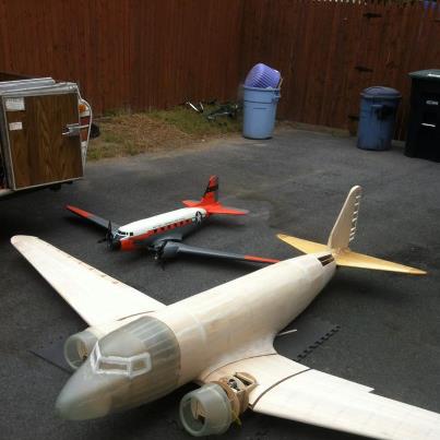

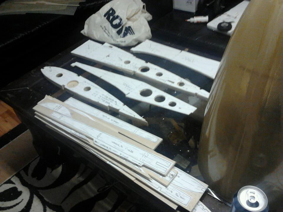

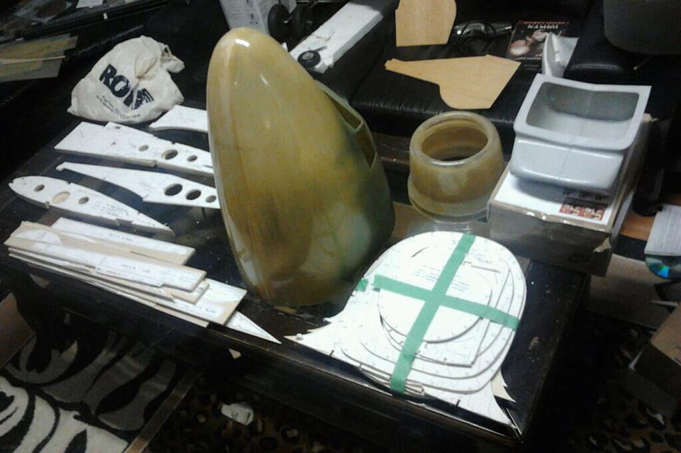

Finally i've stepped in the actual giant scale aspect of this hobby with this Ziroli DC 3 that will be my biggest model in the fleet, i also have ordered short kit of Ziroli P 38 Lightning but there is still a lot of time for 38 to come and take shape.
I'm thinking on getting retracts custom made for this model also, as it will be made from more durable and robust material then commercially available Robart retracts. If custom ones didn't materialized then Robo's are available to relies on.
Model will be powered with 2 x 38CC engines, either Quadra's, US engines or another brand as long as they are updated with electronic ignitions.
It will be next winter when i will start building this model, as i have couple already on the go, one being S Connie is on last phase of construction, then Concorde will be worked on during the summer season. After these two models, this DC 3 will commence.
Presently plan is to get all the material, engines, landing gears, electronics for it during these coming months, so when i get to it, i will have all on hand. I like to know from guys who have built and flown these models, what servos are you using through out this model. IS there a huge concern of weight issue with it, or being HUGE model, weight is not on high priority....What are the areas to have concern about while building this model and are there any special methods used in the construction of this model. Still waiting for plans to arrive in mail...
Livery i have in mind for it is: 1975 era's Saudi Arabian Airlines green and blue stripes livery. My father has flown on Saudia's DC 3s and when i was a child, i remember seeing Saudia's HZ-AAX derelited at old Jeddah's airport, but it was recoverd, restored during 80's and 90's back to flying condition and it is presently preserved in Riyadh's Air force museum painted in it's original livery wearing it's original registration as SAR-1. This was it's first registration number when in 1945 President Roosevelt gifted this aircraft to King Abdul Aziz of Saudi Arabia.

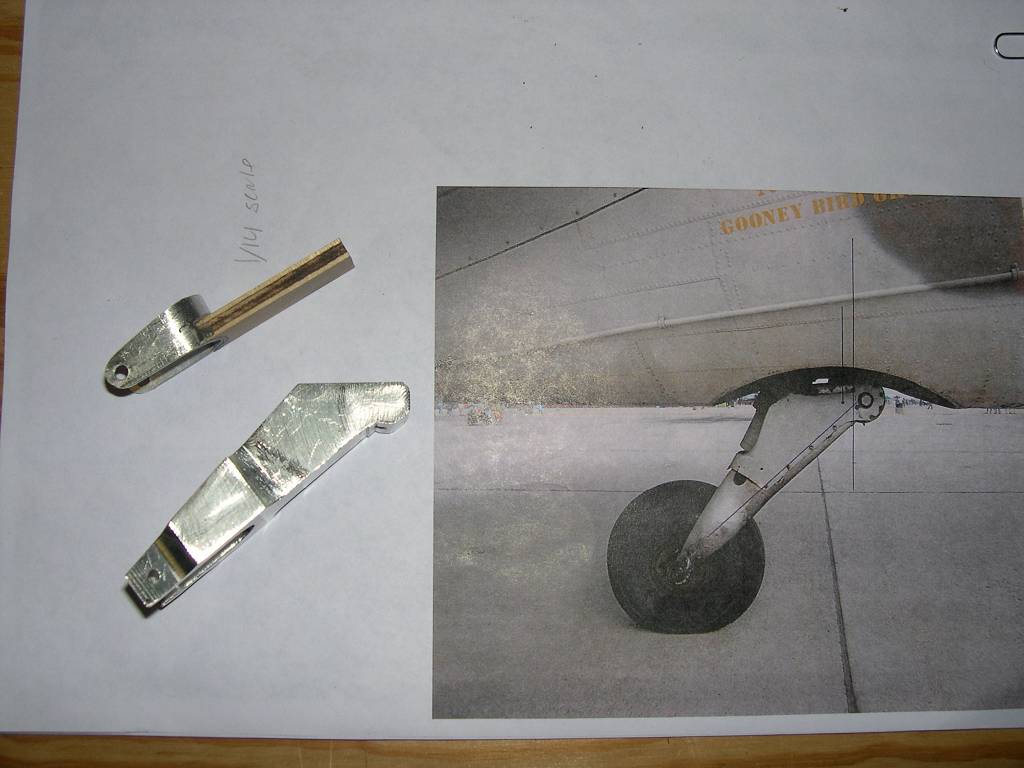

Wondering if tail wheel from Robart could be left freely to caster as it is on actual aircrafts. I'm thinking on using rudder and differential throttle on ground to do the steering if it's possible to do with G38s!. I know with electric set up it's doable but gas is different. I also have Robatr's retractable tail wheel assembly, wondering if i can use this also by making if in fixed retracted position.

Not worth the trouble with a castering wheel. For the most part the plane taxi's well, our field orientation is southeast with the prevailing wind in summer is mostly due south.
Old 03-23-2012, 03:38 PM
TEBerg's Avatar
Join Date: Jan 2004
Location: Clovis, CA
Posts: 478
Default RE: Another Ziroli DC 3 to be built...
Just some info... The full-scale is not "always" free castering. They would get lined up on the runway and lock the tailwheel straight ahead.. It stayed that way for flight and landing.. Then un-locked to turn off the runway..
I found that digging around for my "much smaller" DC-3 research. If you look into the DC-3 various checklist, you can find it there. Here is a link to one of the pages: [link=http://www.theaviatornetwork.com/pdf/NormalChecklist-050221.pdf]DC-3 Normal Checklist[/link]
I'm keeping mine hooked up like a regular tail wheel. I just have a friend to make the yoke look better than a thin piece of wire or metal. I started with the plywood and bent piece of aluminum.. Then we went up to the bigger chunk and are machining it down

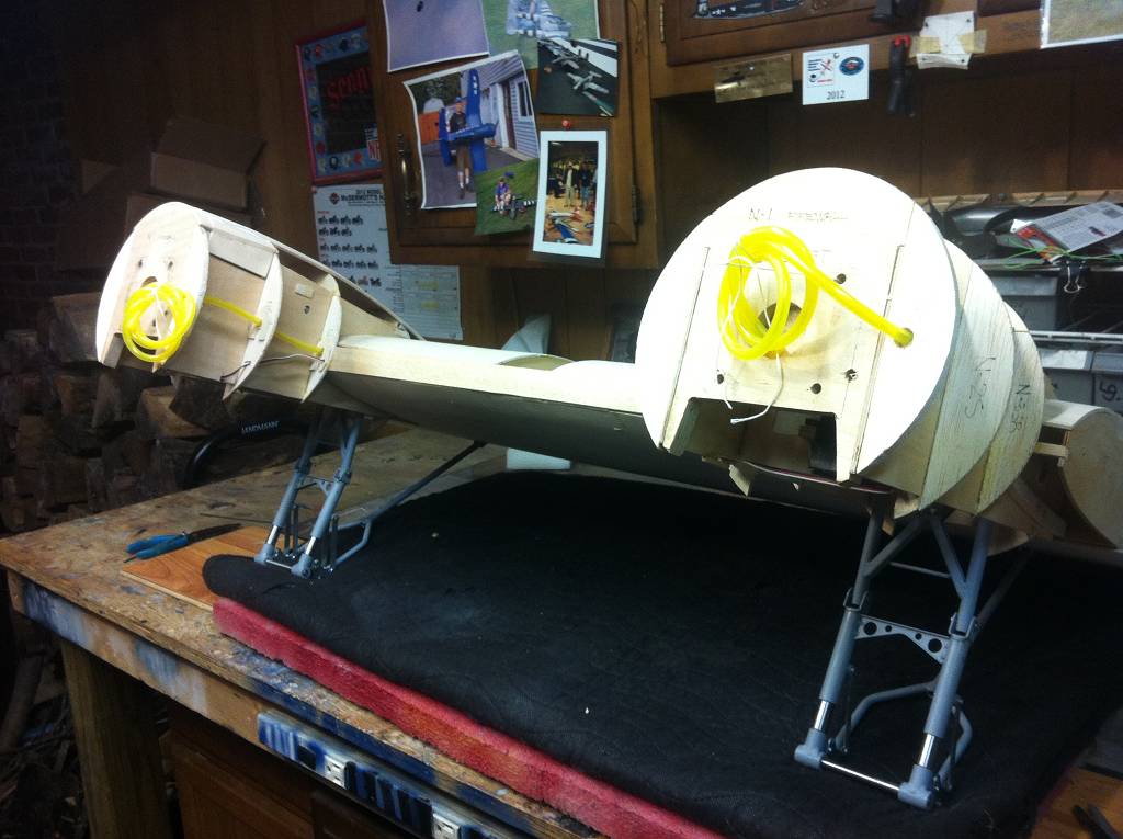

I recently bought one of these built and sheeted, and have been working on her for about three weeks. I can help thinking ahead on how the fuel tanks are mounted. Does anyone have pics of how they placed and installed theirs? Thanks in advance..

16 oz. dubro's fit between the ribs in the center section. It will run just fine with the long fuel lines from center section to the nacelle. Just put your fueling Tee close to the carb so the engine doesn't have to draw fuel to far on first start.

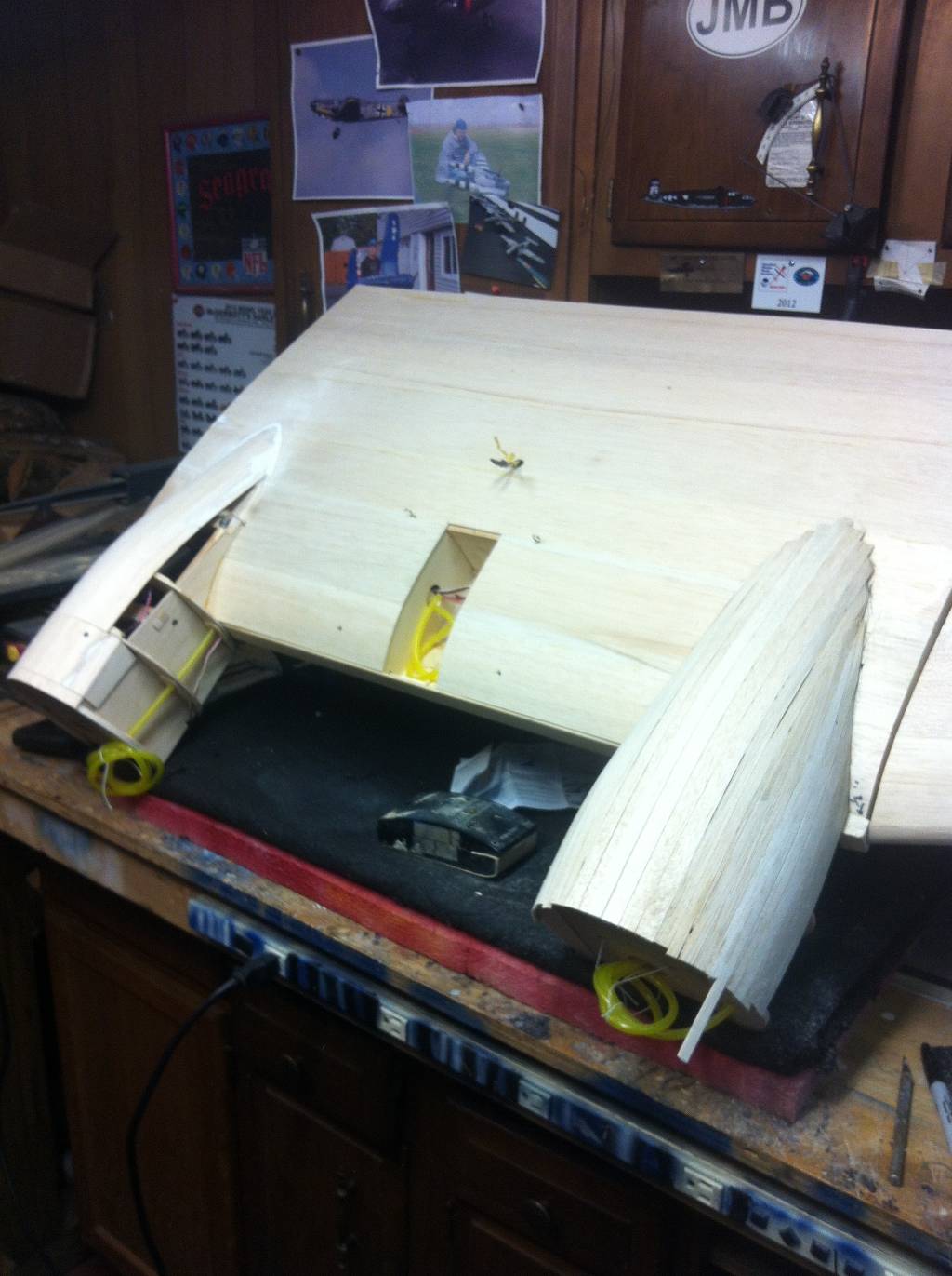

Thank you for your reply SIMCO, I really appreciate it. I took a "hurricane" day today from work, as long as I have power, I'm going to get some work done on her today. thanks again!

since your nacelles are not sheeted, find a home for your CDI unit if your going that way. If your doing G38's (which are more than plenty of power) line the cut outs with roofing tin or some type of sheetmetal and use the stock exhaust. Not so much for the heat but for the velocity of exhaust gas coming out. It will rip the paint off. BTW, jam the air bottle and up/down valve between the tanks in the center section. Never have to disconnect the air lines.
